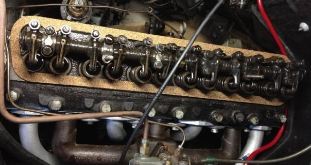

Re: EK Wagon project - Total rebuild
What an interesting afternoon.

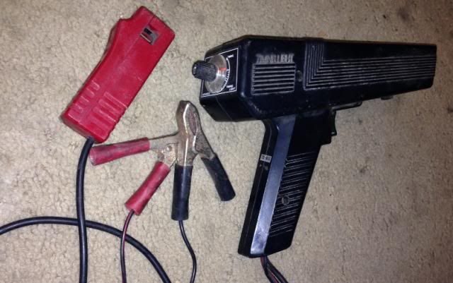

Yes Rosco I have a timing light.
Spark plugs all removed again.
The NGK BP5S (which was the match for Ek and EJ motors) is definitely a lot shorter than the BP5ES.

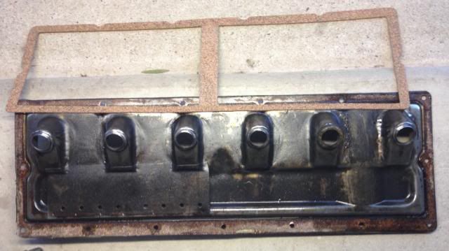

Needed to replace the sideplate and tappet cover gaskets to stop the oil leaks.

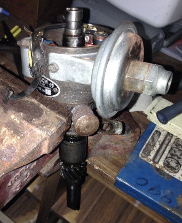

Also needed to check the points before timing, so figured I'd pull out the distributor anyhow and do it all at the same time.
(The oil leaks are quite bad and a priority anyhow. So I'd need to pull all this stuff off again anyhow)
Discovered I also had to disconnect the fuel pump pipe in order to get the sideplate off. What a pain.
Also a pain to get some of the screws out.
So ended up with this.
Tappet cover gasket fits fine.
But the sideplate gasket is the wrong one, or I am missing something.
The one I have seems to fit inside the other one, and wouldn't actually stay in place because their is nothing on the inside to push against

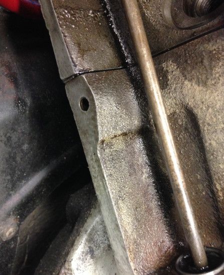

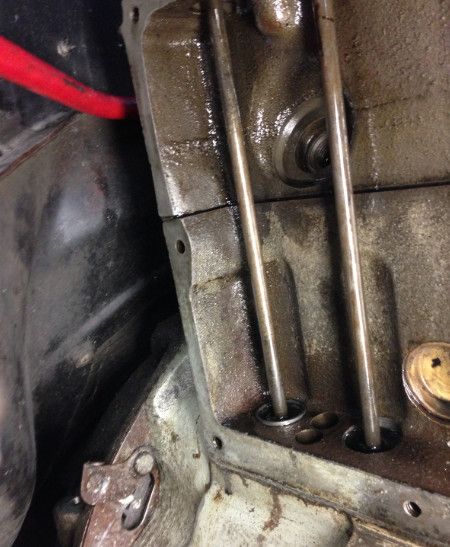

Also noticed that both ends seem to have a joint that is not level or smooth.
It that normal ? I assume it is, but would certainly challenge the gasket to seal over it, without some extra sealant.

That side plate gasket is just the inner piece that the real gasket comes off, it gets thrown out.

Yes Trev, correct - Finny, where did you get that gasket from? - and, there should be six circular gaskets as well which go around the spark plug holes.
I'm relieved that you have a timing light - I might have suggested checking the timing before removing the distributor.. we don't know where it was set now.... but when it goes back in - you'll will set it, so that's one out of the way.

Got the timing light on it to check timing.
That was on 22 deg when it first started.
Moved it back to 6 deg, but I'm not sure that's what it should be on.

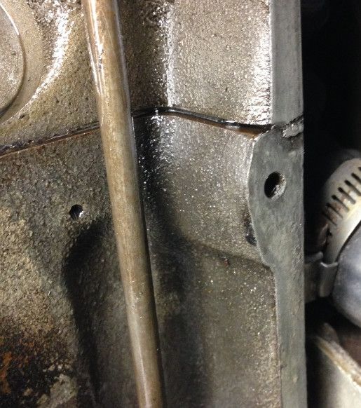

But did notice some oil that appears to be coming from the bolt/screw, which is under the distributor.
Felt around and no leaks anywhere above it, so must be coming out of this area.
Is that something seen before ?

Ripper, Finny - I'm sure glad you didn't have to strip the carby.
If it was at 22 deg's advanced when it was playing up - that would have accounted for all the symptoms. At that sort of difference, it could have been that you re-fitted the dizzy one tooth out.
You know this, but the bottom of the distributor shaft has a flat tooth which must fit into the slot of the oil pump - Tim noted that your oil sender switch light wire was disconnected. If the dizzy is sitting up high due to that tooth not driving the oil pump - it would cause it to leak oil from the block - but more importantly - you won't have any oil pressure - and wouldn't note it, because the wire was off..... please go check both these things before starting the engine again.
Ok - timing..... timing light..... and tuning.
Yes, you could have it professionally done - but to be quite honest, they aren't going to get much more out of it than you can.
A new set of points and condensor - you're going to be charged for those anyway.. and they will also change your new plugs... it's part of the service price....
All that they will do is connect up to their analysis machine, replace the points/condensor and plugs, set the timing to the ball mark (which will be too retarded for an old engine) and adjust the idle mixture... plus check for leaks.
They will electrically do a balance check and tell you what you already know....
So, unless you want to throw some coupons their way for peace of mind... I believe you just about have tuned the engine yourself.
My final "tweak" in setting timing is to find a hill somewhere.
I take a ring spanner with me to loosen the distributor clamp just enough to bump the dizzy around a hair's width at a time.
In top gear at about 25 - 30 mph, I give it full throttle.
I set my timing to the point where the engine just starts to "ping"....one every second or so... not a continual one, and not one every 10 seconds - you aren't normally going to run the engine down so slow under full power... so you're not going to hurt it with pre-ignition.
Once I have the timing set, I put a fixed mark (I used a centre punch) on the timing cover and another on the harmonic balancer.
Checking the timing after that is a breeze with a timing light - be careful of the fan, though - my timing light has a few "nicks" in it.....
Of course, you can put a mark on the flywheel through the timing hole - but flywheels are made of very hard steel.....
Yes, like Tim - I'd like to be a lot closer to where you live.... we could have sorted this out for you in less than 1/2 hour...

The 22deg was just the rough setting that it first fired over on. (and seemed to run really freely on)
I lined up the timing ball mark before I removed the dissy, and check the points opening on cyl one.
And when I reinstalled it, I made sure it was aligned to fire on cylinder one again.
Not sure what is was previously, as I didn't check it.
I did a good check to see if there was any leaks from around or under the dissy.
And NO leaks, it was all dry and clean.
The Dissy is sitting in place correctly.
As far as the tune up goes. I was just wanting it diagnostically checked.
Set engine idle speed, mixture adjusted and timing mark.
Still not sure what degree I should set in on.
I didn't need to mark anything, just used the ball on the flywheel.
On my timing light it has a dial setting on the end, which adjusts the flash timing.
If I leave the setting on zero. then it operates normally.
But if I actually dial in the required setting (6 deg or whatever) and then move the dissy until the ball lines up with the mark.
So the only mark I need is the timing ball. Very handy little tool.
Just don't have anything to check idle speed or other settings.
