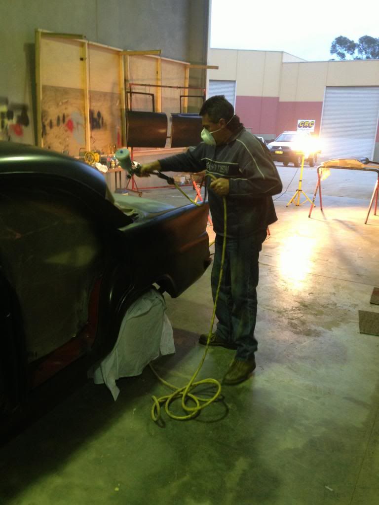

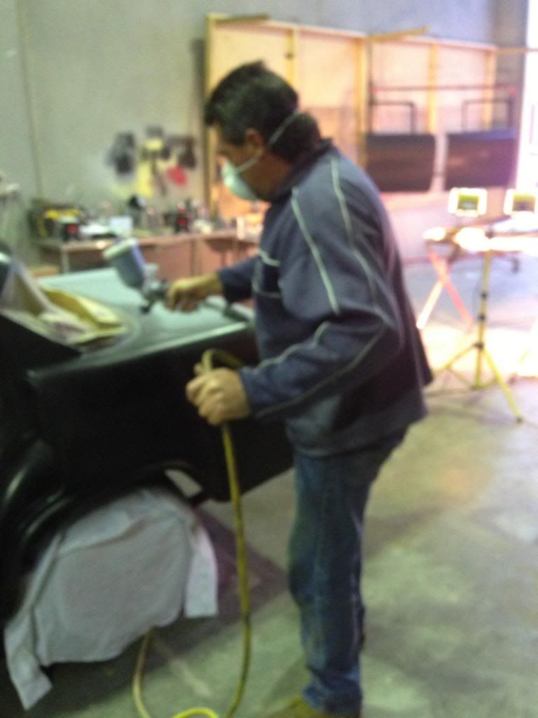

Has been a while and have had a couple of quiet weeks and decided to my finger out on the FB.

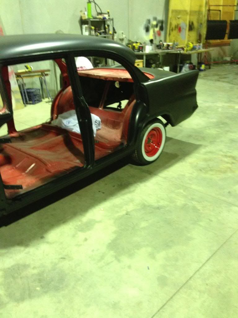

Bazza on the gun giving it a lick of matt black
After paint with the new whitewalls on

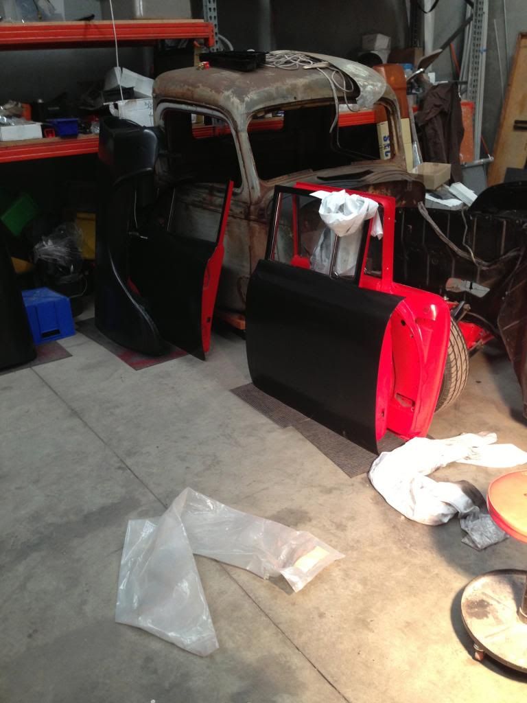

Put the doors back together what a pain in the arse!!!

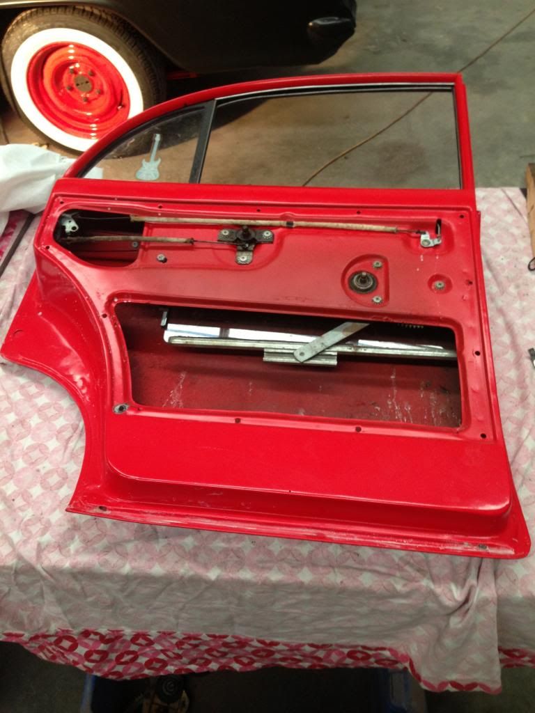

I ended up welding the front vent windows shut after we put the new rubbers in as I couldnt justify the $365 for some rare spares changeovers. The locking nut on the bottom of the vent channel snapped as it was rusted on hard.so we just welded it on at the base and it cant be moved my new hilux doesnt have vent windows so I dont see why my FB would need them either.
Got them all back together in a day couldnt be happier

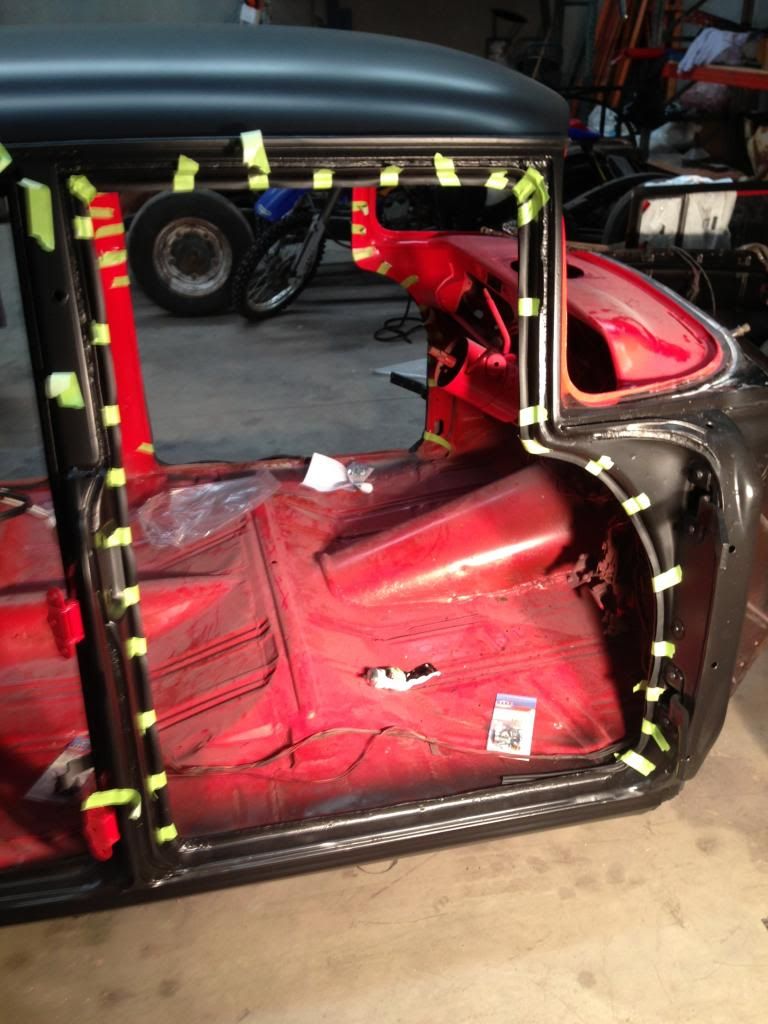

Today we started on the inner door seals
Not many instructions on here but we plodded along and using the recomended 3M product started putiing them on.
We used 3M green masking tape to tape them on at 3-6inch intervals to assist with the bonding process and after the first door they just went on like a dream and after we took the tape off this arvo the bond is excellent

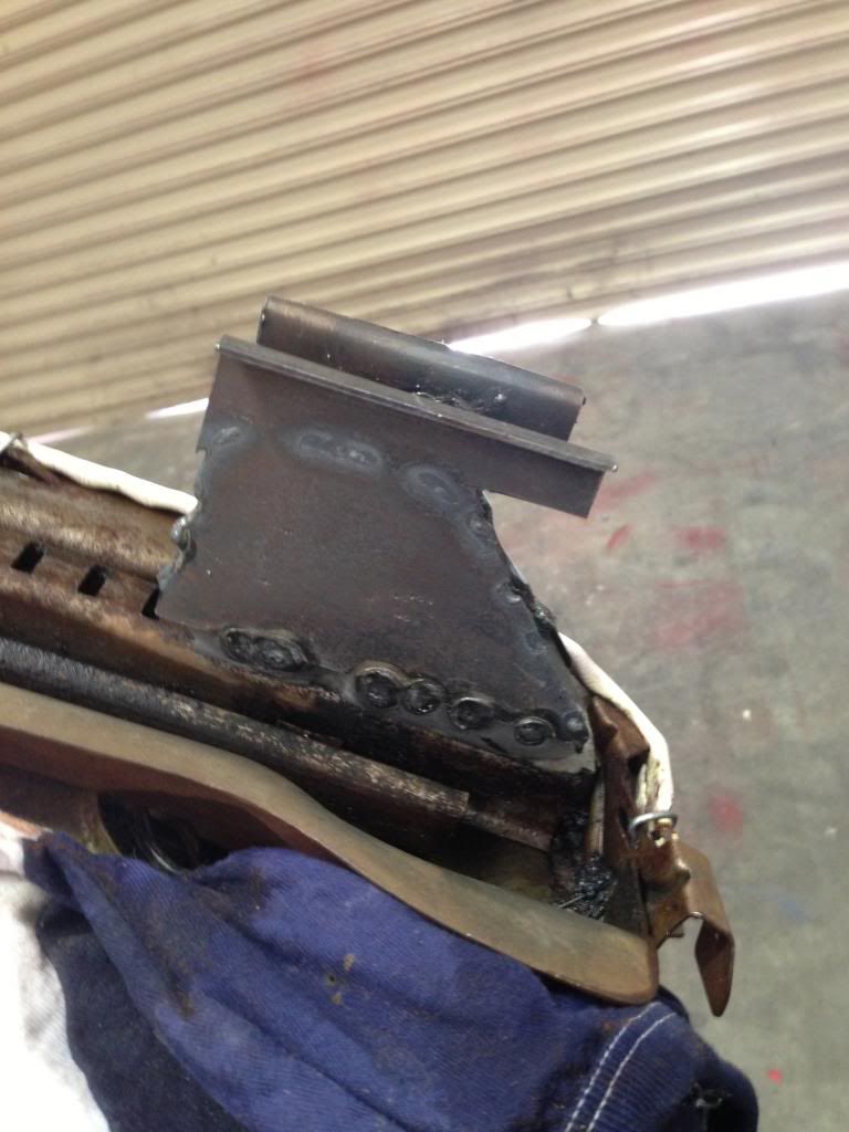

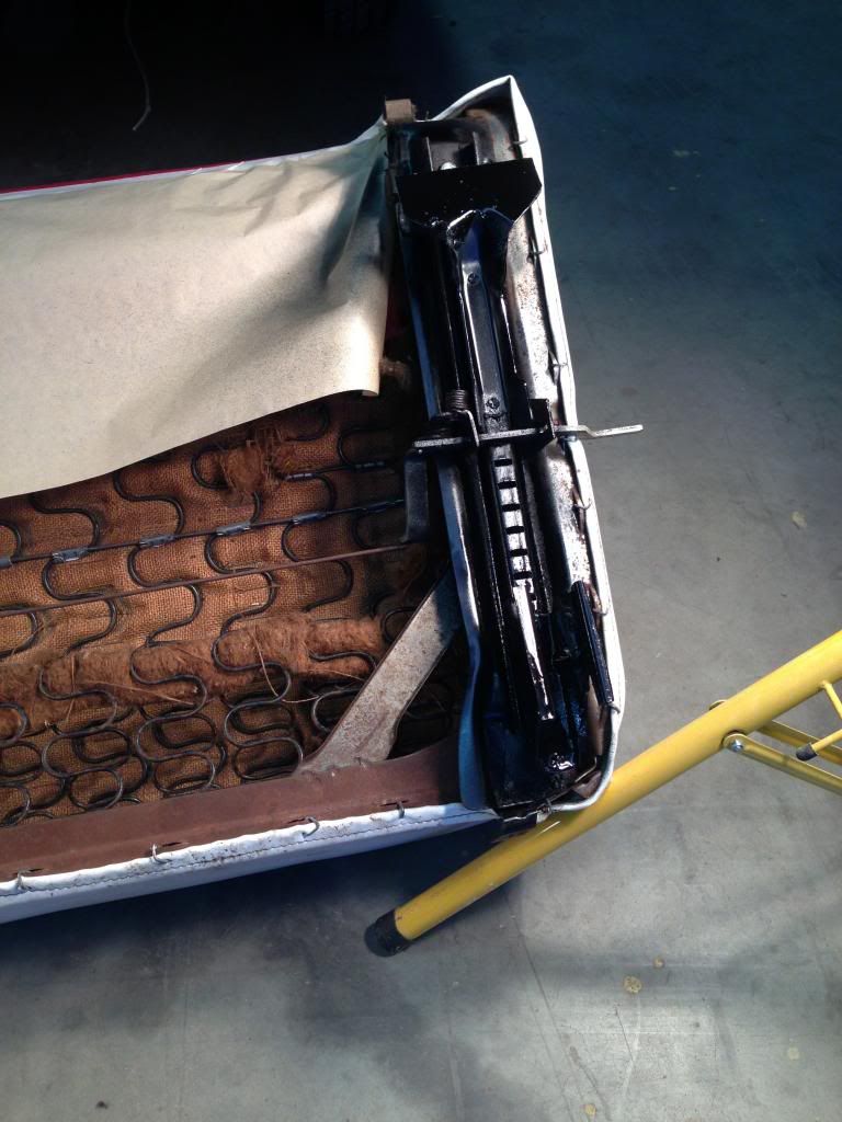

The old girl as anyone who has read my posts had some issues with rust and the seat base was no exception we grinded the base hooks for the front off and the rear feet.
Fabricated a new set of both and with a bit of a tidy up with the grinder we welded them on a bit of paint and shes all good.

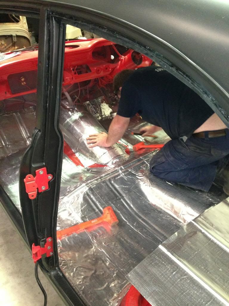

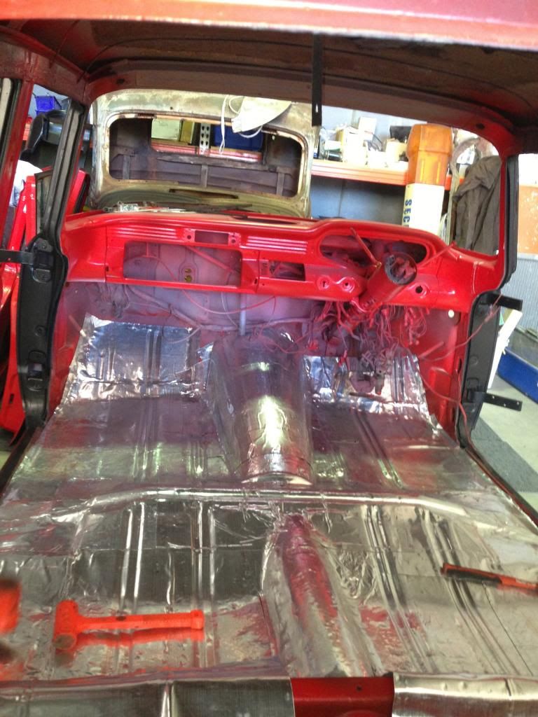

Next for today was the dyna mat we put it on the floor and will finish tommorrow.
