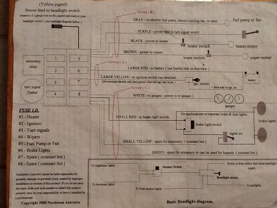

Need a bit of help with wiring my indicators on my hotrod
Have a fuse panel with a flasher unit and a single wire to power turn signal switch. Purple wire.
Turn signal switch has inlet and outlet wire for a flasher unit ( wires 6 & 7)
My question is do I bridge 6 & 7 or connect the power to 6 or 7?
Any help greatly appeciated

Can't you just get a 3 pin flasher can and wire it as per the diagram ????
