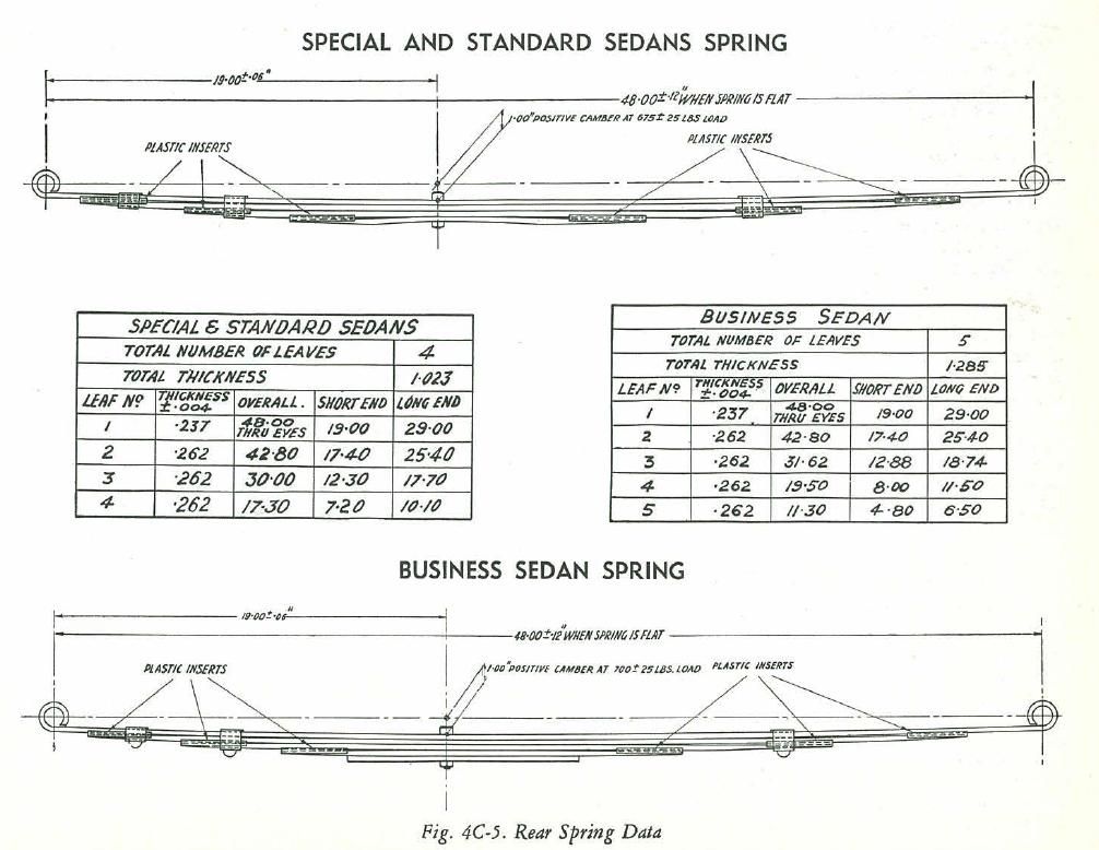

hi I want get my rear springs re set to standard ride height
can someone give me rough idea of the height pls

Ring king springs their selling lowered ones so they should know the standard height

I'm on the road for work, so haven't got my FB/EK Workshop manual with me. The info below is for FE/FC:
