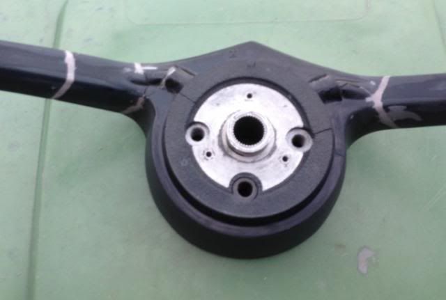

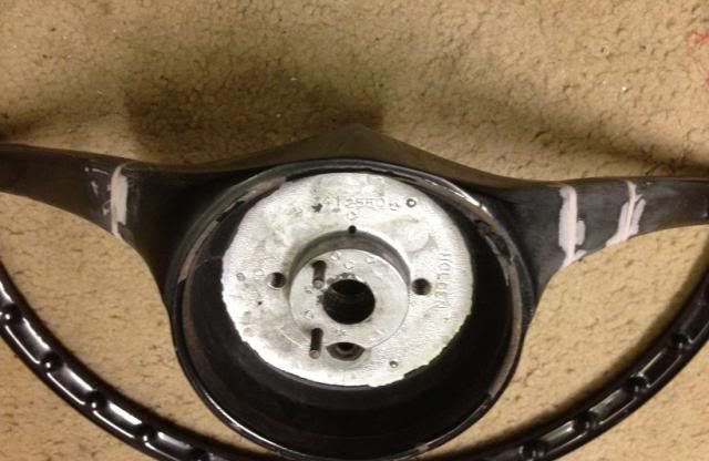

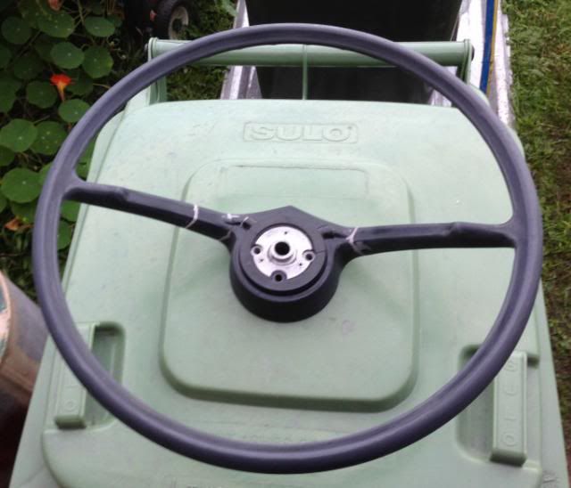

Started on my steering wheel repair / repaint a few days ago.
Drilled out the cracks and filled them, then primer/filler, then some blade putty, some more primer/filler and lots of sanding in between each one.
And then the rain set in :( :( so it got put on hold before the Black and Gloss was done.
Didn't get a final photo, but I managed to get rid of all the minor cracks and lines. :D :D

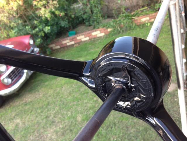

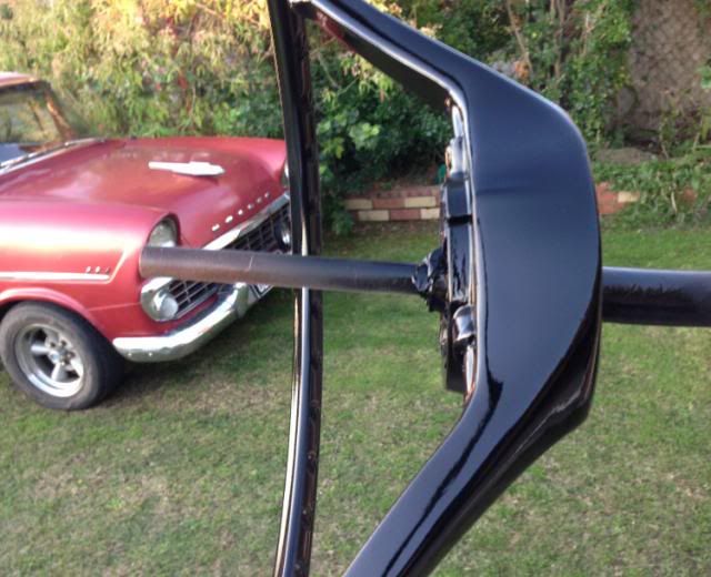

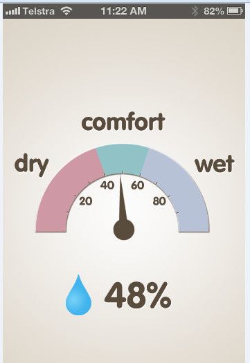

And yet another lesson learned today.
After watching the humidity sitting from 70 up to 99% over the last few days, today the sun was out and it dropped to 59% and I thought that will do.
It's only the steering wheel, not a big area, no real problem. :D :) :( :shock:
It was really noticeable at soon as painted, made it look grey.
It seems to have darkened up a lot as time progressed.
However it was still very obvious in a couple of areas. And definitely not the glossy black I was looking for.
Checked the humidity after I had finished and it had blown out to over 90%. Plus I was painting out on the grass which was still wet from the rain.
I'm assuming the clouding was due to humidity, unless anyone has another idea.
Just glad I wasn't doing body panels. :roll: :roll:
Think I'll be waiting for 50% in future and getting away from any moisture.
Not sure if I need to sand it all right back and start over from scratch, or if buffing will take it out. :? :?

Thanks Tim. I'll give that a try.
Sitting on 65% at the moment.
Hope it drops enough latter today

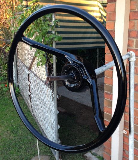

Steering Wheel update.
The Humidity was down and time to paint again. :roll:
Gave it a light sand back and sprayed both Black and Clear again.
This time it came out right, should look even better when buffed.
A new shiny steering wheel.
