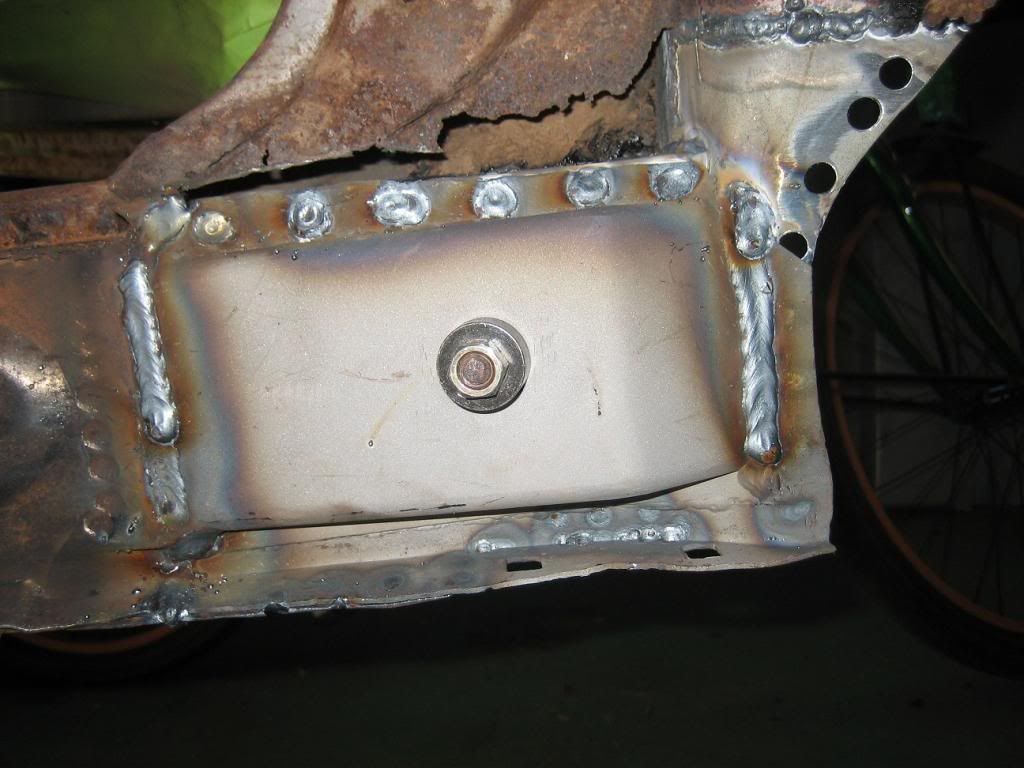

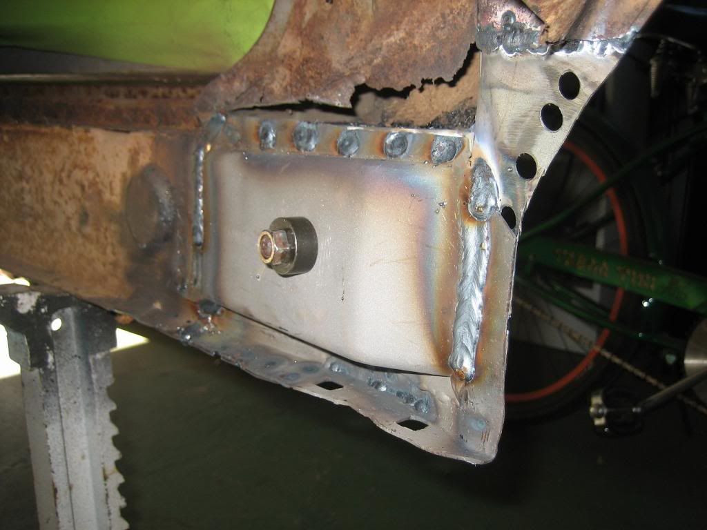

Thanks for the positive feedback guys, I haven't had much time of late to work on the FB. But found a little time last week and an hour this arvo and this is what I accomplished.
The left hand inner sill where the subframe bolts up was pretty rotten, so cut it out.
Made a new section from 50 x 75 x 3mm RHS and welded into what was left of the old section. Then positioned it correctly and welded it in.
A bit more progress
, now to bolt the subframe back on again and repair the floor cross member that takes the two inner legs of the subframe.

Why is that? I always lean towards too hot rather than risk lack of penetration. In saying that I had the welder set on 6 which is the highest setting on my transmig 195, but I do suffer a bit of voltage drop as I have to run it off a lead from the house (no power in the shed). Probably should play around with it a bit more, lower setting and weld slower to get the right penetration. I'm not as well practised as I used to be.wot179 wrote:Good stuff.

I totally agree, I wouldn't even turn it down for panel steel. Better penetration less grind clean up and distortion.(Distortion only comes from the panel shrinking after you weld and if you lay up then shrinking becomes more prevalent, only to find you have loads more grinding to do to dress it up). There's nothing worse to see weld bead layed up on a job then you grind it down to see a partion line (no penetration, no point in welding)SunnyTim wrote:I'm with you Sam, the more heat = the more penetration in these structural areas. Be different for panel steel as you'd be worried about distrortionGrimbo wrote:Why is that? I always lean towards too hot rather than risk lack of penetration. In saying that I had the welder set on 6 which is the highest setting on my transmig 195, but I do suffer a bit of voltage drop as I have to run it off a lead from the house (no power in the shed). Probably should play around with it a bit more, lower setting and weld slower to get the right penetration. I'm not as well practised as I used to be.wot179 wrote:Good stuff.

Have a look at your vertical welds.
They are hollow in the middle.
The filler metal is rolling down and pulling material down with it , preventing penetration as you race down to stay in front of the filler metal.
The weld will be sitting on top instead of penetrating as it should.
More heat doesnt necessarilly mean more penetration.
The plug welds look fine,its the vertical down welds that need you to modify your technique.
I suspect your gun angle is wrong,too.Dont angle it up so much,keep it closer to horizontal.
Just trying to help.

wot179 wrote:Have a look at your vertical welds.
Thanks heaps for the feedback, I see exactly what you are saying in regards to the vertical downs. I really appreciate the advice/help.
