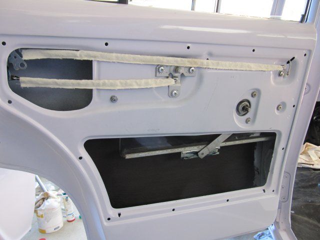

All door opening and winding mechanisms de-rusted, cleaned and painted and installed and working...except for the drivers door will only open from the inside...
I had a lot of trouble getting the window glass to wind up and down as they sat very tight in the felts and channels but the silicon spray did the trick.
