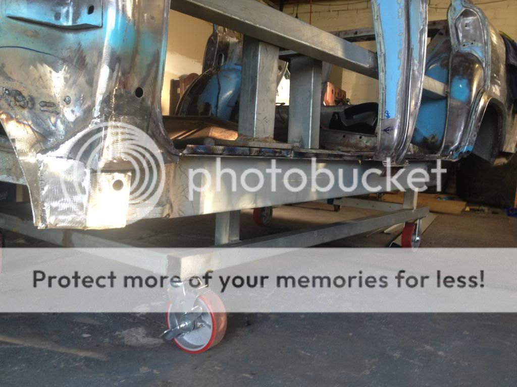

My EK Special Project Update 2013 02 10
Been a bit slow of late but a few new pics;
Hr Front End fitted ready to mock up engine and gearbox for tunnel
Inner sill cancer
New Inner sills pressed up ready
Remains of sill
New sill tacked in place
& welded ready fot lower rear guard work and outer sill
Inner sill cancer
Remains of sill

Have you cut the ru$t out of the back where the rear window sits? I have to tackle that job and its good to see how others have done it.

Thanks guysjarvo wrote:Have you cut the ru$t out of the back where the rear window sits? I have to tackle that job and its good to see how others have done it.
Yep all done Jarvo
The rust also went along the guard where the horizontal bog is.
This is the nearly finished pic, I didnt take any pic's during this repair it was one of them days where I just got stuck into it.
1. I made three templates from the upper window seal lip to about 100mm down the guard to make sure the new bit where the correct shape.
2. I cut out all the rusty bits
3. Except a small section right in the corner at the front lower corner of the window where it meets the parcel shelf, I cleaned this section with a die grinder and burr and weld repaired it then dressed it off to the correct shape.
4. Then I rolled the upper guard section and tacked & welded in place (becarefull on the upper guard with welding heat, it's bloody hard to tap but out if it shrinks in)
5. Then fabricated the outer window frame (this part sucks) I made this from folded sections and seperate plates welded together to creat the correct shape, it was a bit of trial and error, I also made this section with 3mm plate as EK's are prone to rusting here.
6. When it was all tacked up I slowly welded all the sections (spread the welds out to minimise heat)
7. Then grinded and burred all the sections to the correct shape
8. There was also some pitting around the rest of the frame I hit all this with a wire wheel and have pad welded every thing I could see, sand blasting may open up some more spots but we'll see
Cheers Coops
Hope that helps a bit (it's always the bits you dont many pics of)
