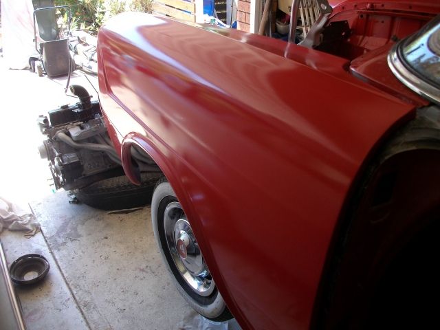

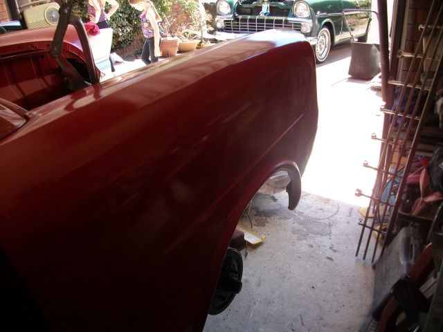

too much wind today to do to much
bit of sanding and cleaning parts to go back on

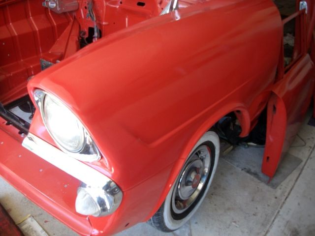

all i have left to paint are the rear gaurds will have to wait untill next week end though

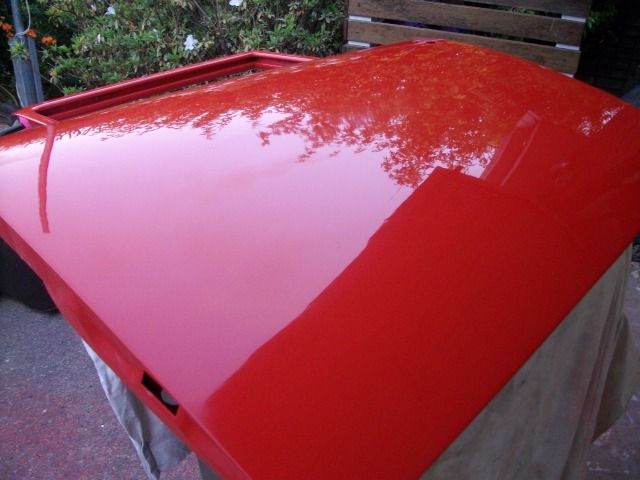

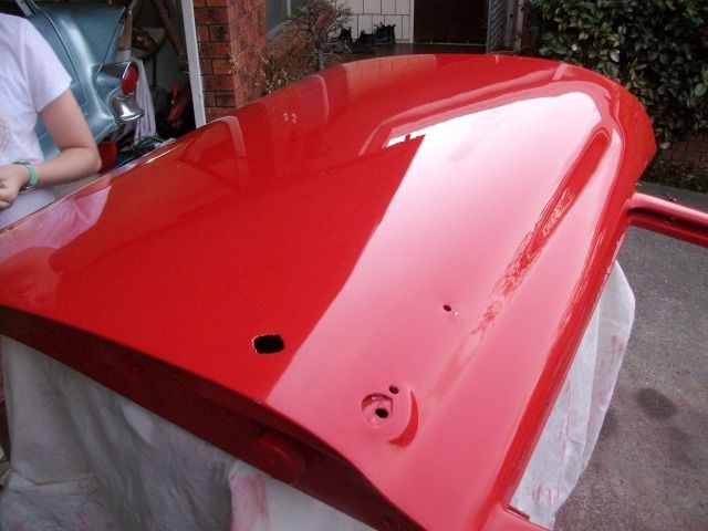

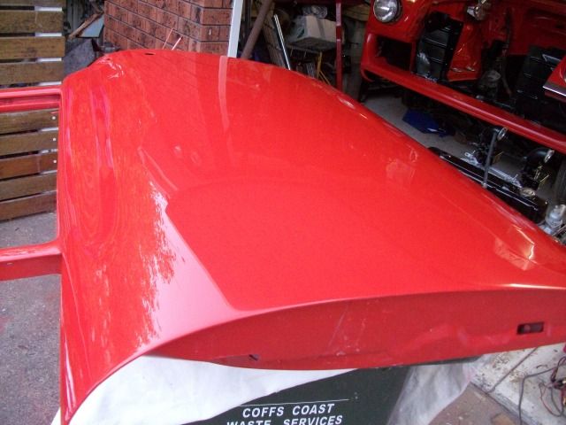

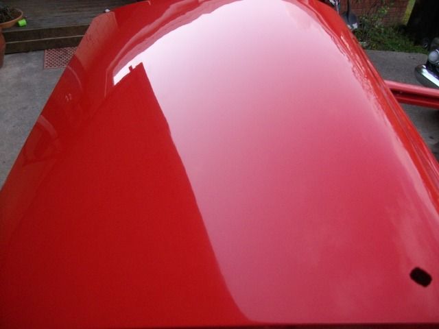

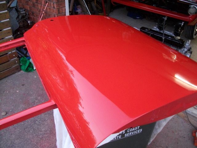

ive rubbed down one door with 1500 wet/ dry then 2000 wet /dry
then used cutting compound rubbed by hand then used fine grade
machine compound on a buff on slow
this was the result
this was the result

Re: EK JAY'S EK WAGON BUILD
Want to come and do mine , looks good
Wowsers! That's the trick!
Real nice Jay
Thanks guys
forgot to mention its acrylic paint 4 to 5 coats
EK JAY SINCE 1990
Coming up a treat!
