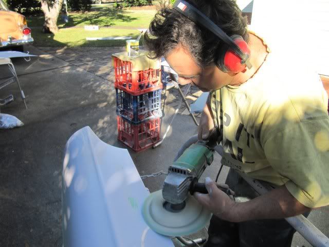

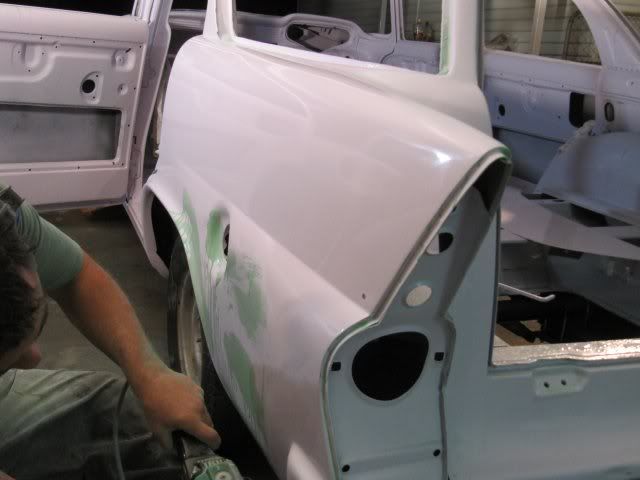

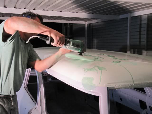

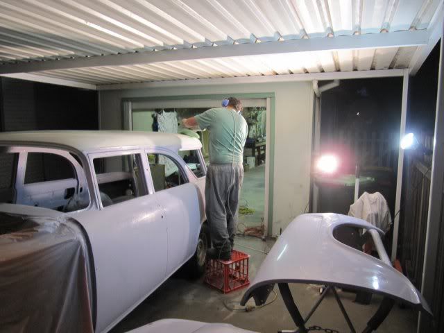

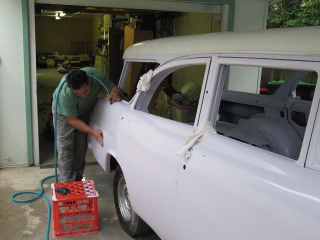

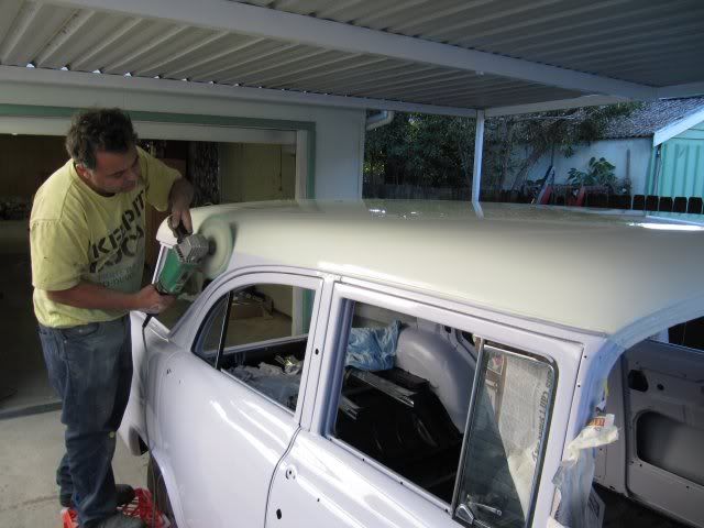

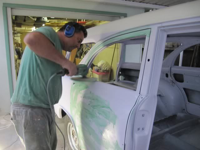

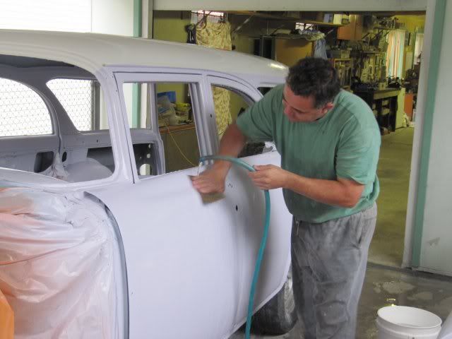

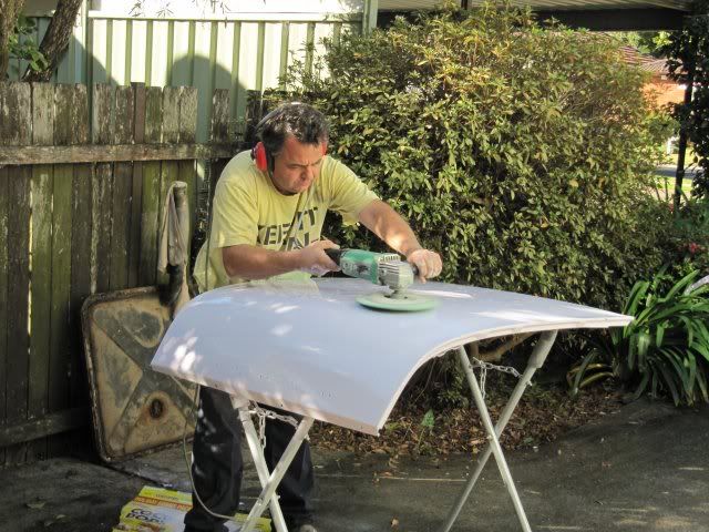

June 2012...First Dave got into the 1200 wet rubbing...

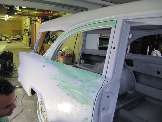

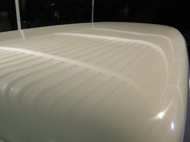

then cut it with green max...

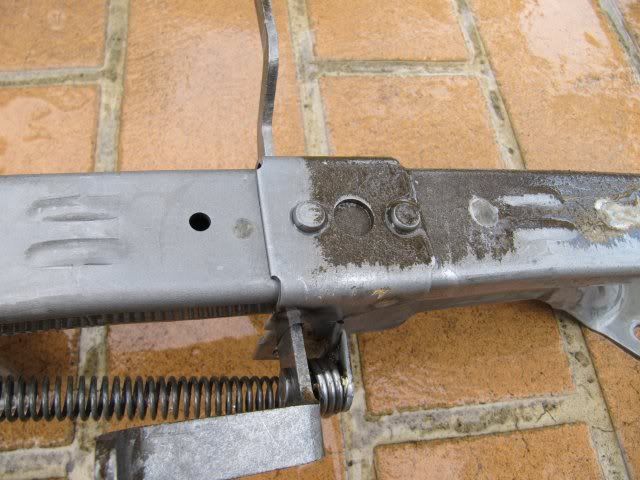

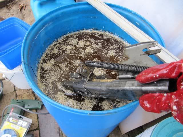

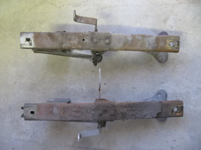

During July I derusted the front seat guides and polishing and cleaned the front seat sides...
I used molasses...thanks Danny (OldMansLacky) for reminding me of this great cheap and effective rust remover...
I then hit it with the karcher...

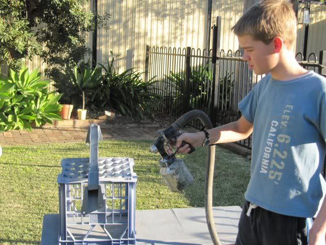

Thomas put some primer on...

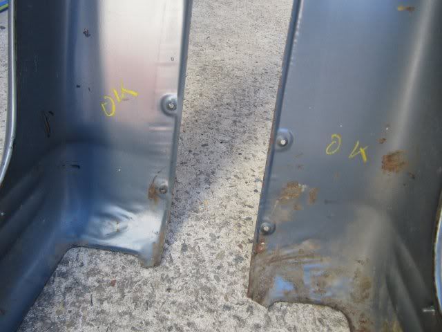

Some original factory markings...OK..

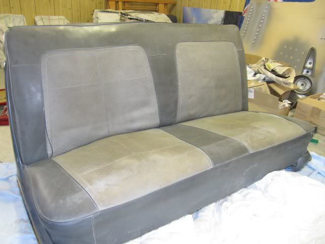

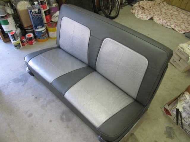

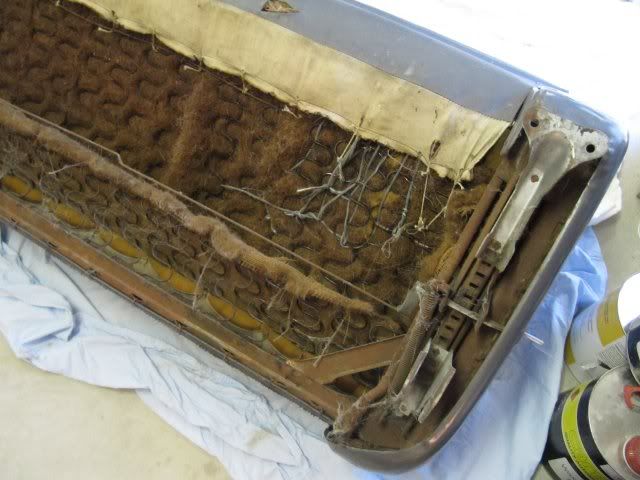

I was hoping that the orginal vinyl on the front seat could have been saved. Unfortunately the 50 year old vinyl in this case had gone hard and brittle was was starting to crack and split all over the place. So the seat was recovered in a close match and some original inserts were used and I sourced others (thanks Russell)...
Daniel did an amazing job...the whole seat was rebuilt with new hand formed springs and new foam...

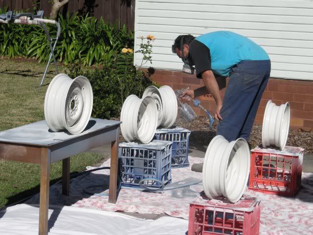

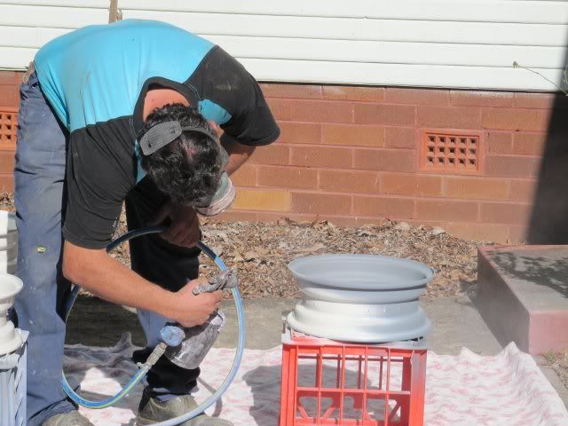

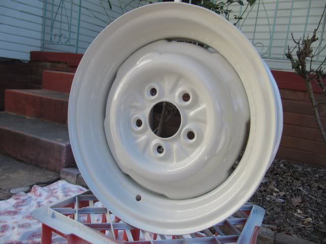

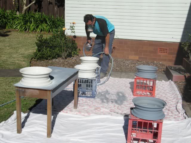

Thomas put a coat of primer on all the rims...
then Dave covered them with Snowcrest...

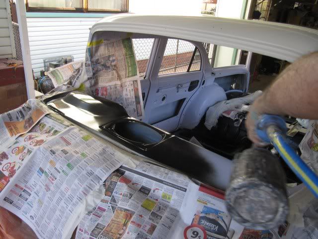

Dave also repainted the dash...
and got into some more buffing...
