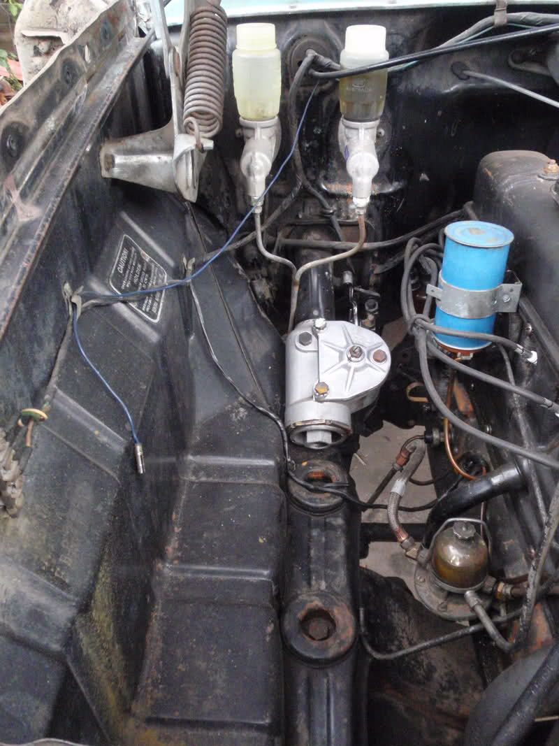

thats some great info guys... thanks for sharing that. Which confirms my conclusion about my ute too. FB which has the black tape & blinkers fitted as an accessory see blue wire (this pix is from the resto)

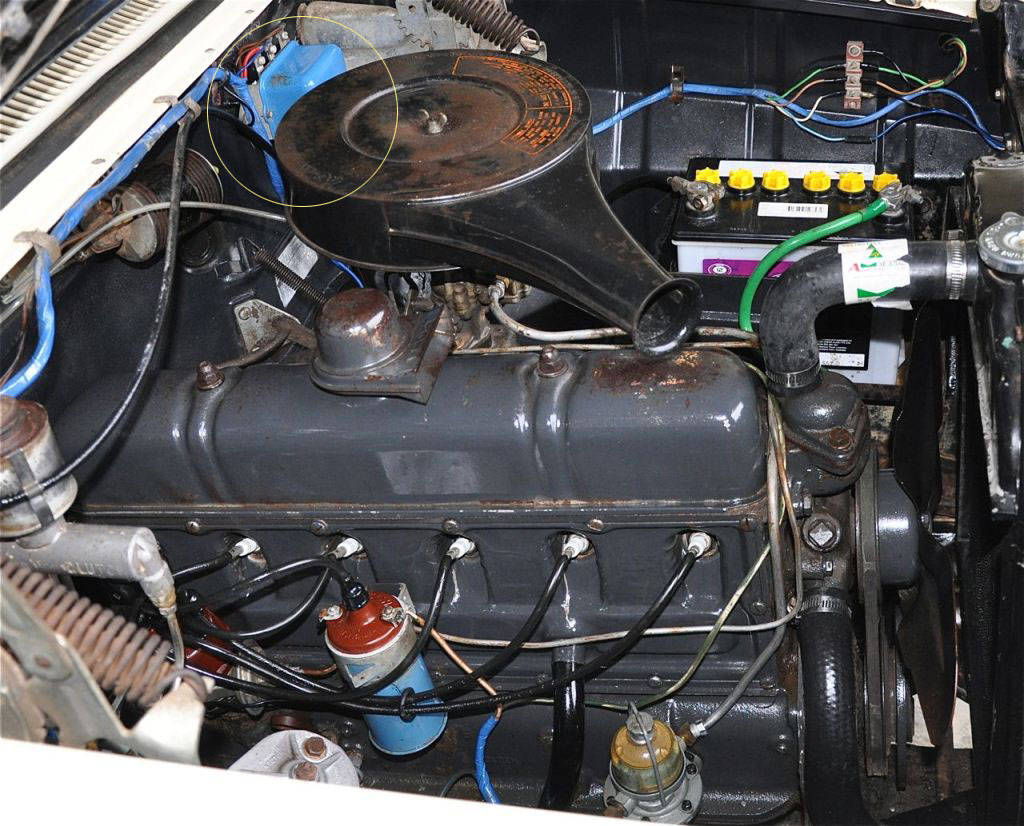

heres a question, noticed your (see pix circled) the volt box thingee (sorry forgot the name) its blue. pretty sure my fb is black.
did they change colour ??
