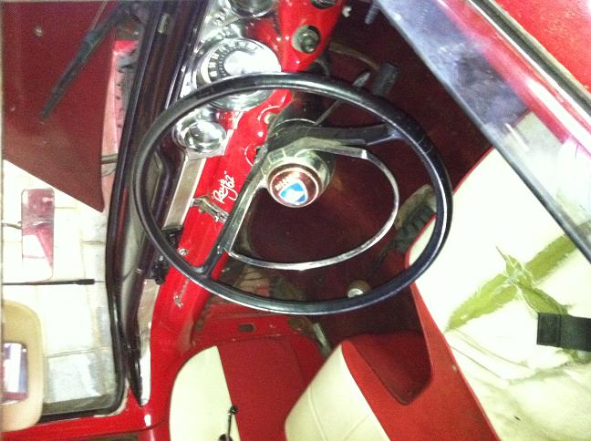

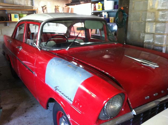

Thanks for your feed back so far guys, here are some photos of my EK.
Do you know what the name and colour code would be for the red and white that the EK in my first post would be?
