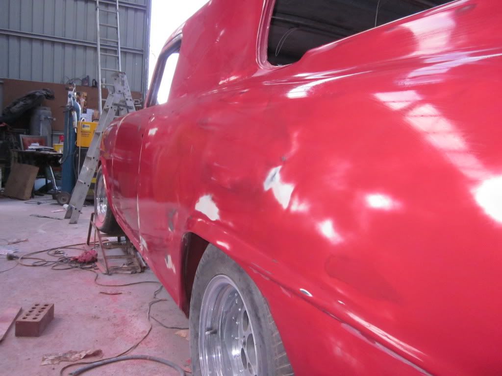

OK will do a little update , been rubbing for weeks and Iam over it
, 50 years of service as a Ute has left the body worse for wear
Think somebody has been throwing marbles at it , lots of tiny little dents , you can pick them out when it is wet but when it dries they are hard to find , think I will just get over it , is only a sunday cruiser after all .
Am going to throw a few more coats of primer on it and block that back and that will do .
Have got the door gaps sorted , and the bonnet back from the sandblasters so will fix the bit of rust in that and weld up the badge holes and body work .
Plan is to have it painted by the end of the month.
EK 283 , have found the best way to sand this 2 pac primer back is dry with a long block , gets it nice and straight , have started with 240 and then over it again with 320 and then wet sand with 400 and thats where am up to now .
