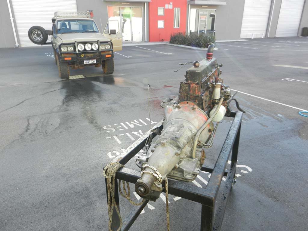

the engine is out!
No major hiccups encountered. Biggest surprise was the fact that almost every fastener on the engine wasn't very tight!
I am planning to do some work on the engine and engine bay over the next week and will hopefully be ready to install the new engine next week.
Andrew

(AUST)Mod wrote: Image
for those that say it can't be done look at the sump, still not sure what this one is but it's definately not an EH sump and doesn't quite look like a HD/HR or H/KTG
are yo going for a bigger radiator andrew :?:
Re: "(AUST)Mod's Turbo FB"
Is it Torana?
Good work Andrew nice productive day.
Looks HD HR HK HT HG to me, I had one on a motor that came out of an EK as-well.
I just recon you might need the engine mounts a little taller to make it work, not that Andrews look any different :D .

Yes I will go for a bigger radiator.
The sump is modified - it has been re-shaped and had a baffle added, but I don't know what it started life as.
Posts: 4283
yeah the back of the drop is what put me off the H/DR or H/KTG
