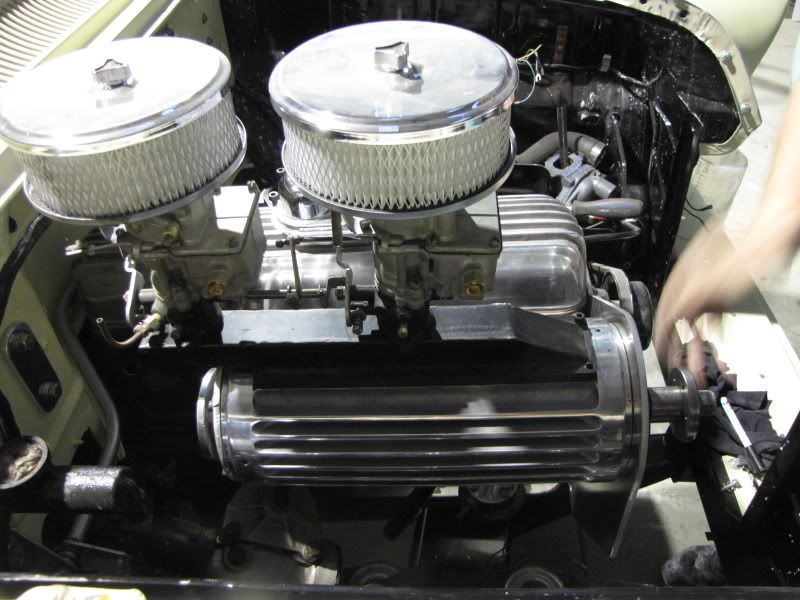

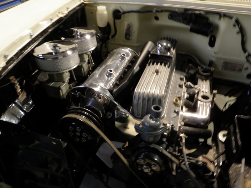

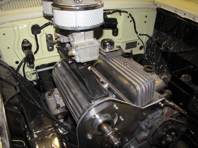

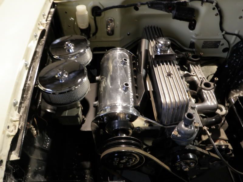

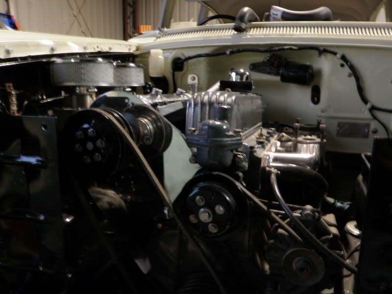

Trev been looking into blow through and it would give me clearance
prob is that the vent for the fuel bowls on the carbys are inside so it would push air into the bowl and would presurise and may not allow fuel to flow
and still looking at options there
the norman needs lubrication so a oil/lube drip feed set up of some kind would have to be sorted out if it wasnt running fuel through it
thommo as 4 injection its already on the cards setting up a throttle body and running the injector rail ,vk commy computer and electrinic ignition
