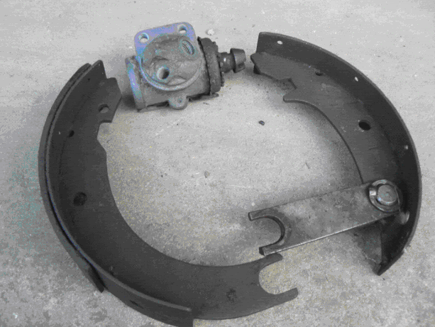

Hi All,
I've got a horse float with brakes in the FBEK range. Need some help identifying and sourcing parts or reconditioning.
I would like to get the wheel cylinders resleeved in SS. Can you recommend someone? The shoes need relining or replacement. Any suggestions there? As is the usual thing, I'm trying to get the job done right for as little money as possible. Thanks for your help. By the way the shoes are 45mm wide.
Need to know:
-Model
-Where to get reco or replacement shoes
-Where to get resleeve done
Thanks,
Yog

Look like FB rear shoes to me but I could be wrong
Try "All Brake and Clutch" or "BHSS" for sleeving and lining
any decent brake place will be able to ID them

Wynnum master cylinder exchange do stainless sleeving nice bloke to deal with and knows old skool cars.
