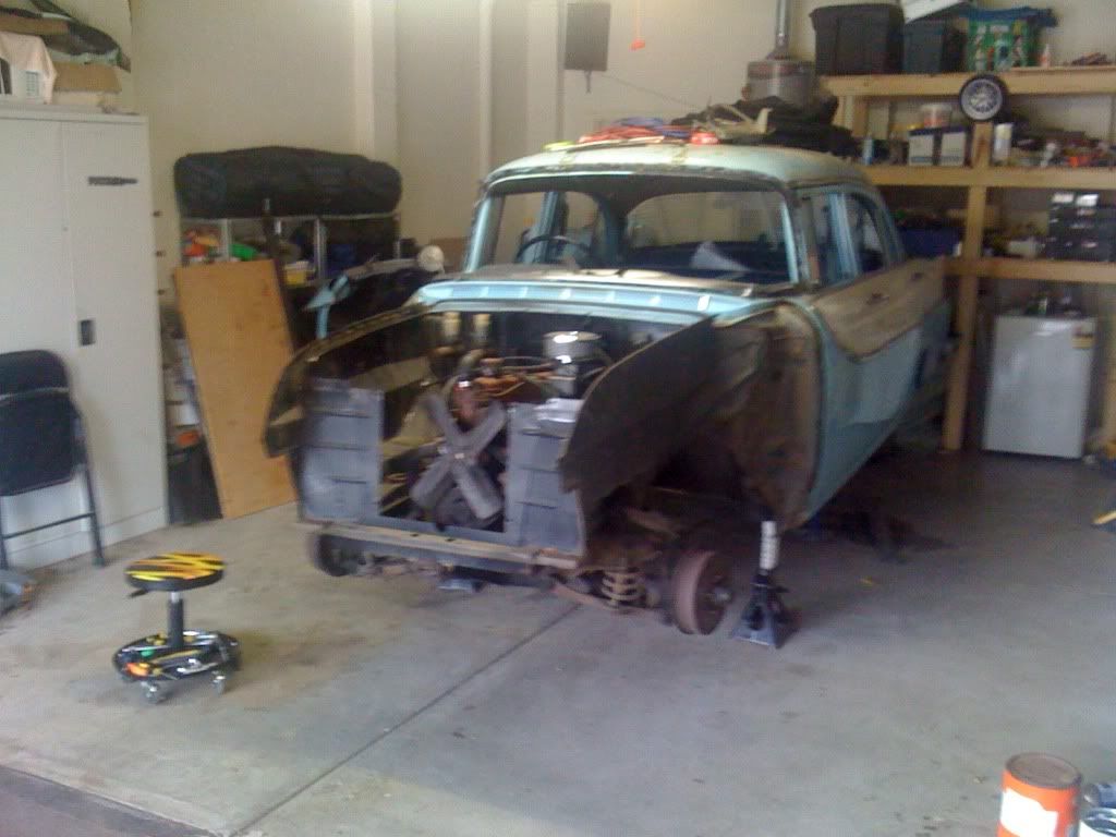

This is what my FB looked like over ten years ago when I bought it.
This is what it looks like now
This car has been parked since Picnic @ Hanging Rock 2006 as last week I finally committed to resurrecting the old girl.
She has a 138 red at the moment but my plan is to refit a grey and somehow mate it up to a trimatic auto.
I don't think I will be going as crazy as some of you, I just want a neat cruiser that is back on the road by the time my kids are old enough to drive. (My eldest is 8) so I have some time up my sleeves.

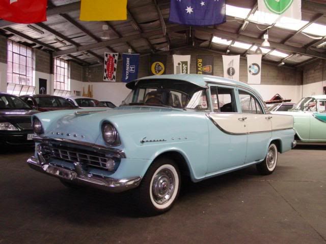

Here is a picture I took a couple of weeks ago
I went nuts a couple of years ago and brought the car up to roadworthy, drove my mechanic crazy in the process, mind you he charged me near enough to $2500 for all the trouble; apart from that, a fox tail on the ariel and an alloy rocker cover under the bonnet, and I just drive it every now and then when the weather is good and I am in no rush.
Thanks for the interest.

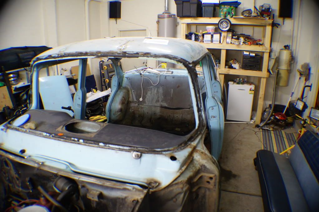

Made a bit more progress over this long weekend, including finding space to store most of the bists I have removed.
I was rather proud of myself, pulled the entire loom out as one unit so I can use it as a reference when it comes time to electrify it again.
But still happy to just take it slowly. It's been 18 years since my last teardown, the difference this time around is that I would rather get it right than fast.
Also considering that my garage buddies are 7 and 8 years old and insist on helping and we are using it as an opportunity for them to enhance their writing skills and teaching them fractions (can't do that Stripping Down a Japanese Car), we really have no other option than Slooooooow.

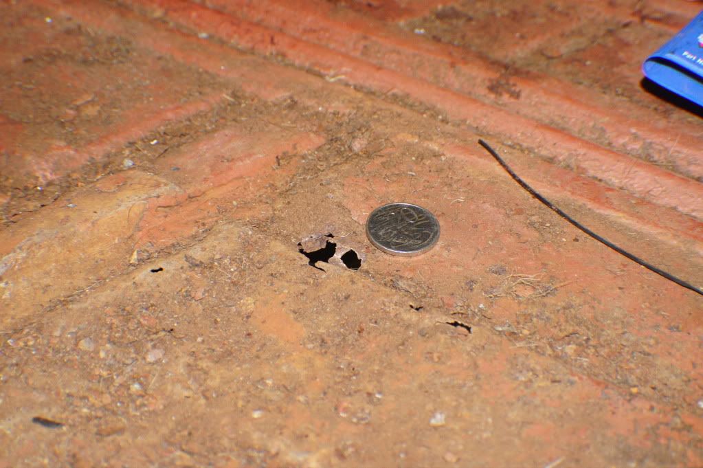

I thought I would also attach a photo of the worst of the rust in the floor. There are about 1/2 a dozen spots like this throughout the floor.
I was thinking about punching them out with a hole saw and replacing the small circular areas instead of cutting out all 4 floor pans.
How does this sit with the experts?
Now I know most of you will will tell me to stop whining as you have had to replace everything from the belt line down, but I was really hoping not to have to spend any more time fixing the floor that simply putting a new hump in.

MR Bigbird,
I would clean the floor up as much as possible then cut the small rusty bits out and weld in new plate.
If the floors are rusted like most you would be better off to replace the whole section instead of a bit here and a bit there. I have also replaced small sections of floor with repair panels just cut the desired size out and weld in. It really depends on how bad the rust is.

Good progress Bigbird, I agree with Greg it is usually better and easier in the long run to replace the floor sections.

Hi BB,
do it once - do it right - and you'll never have to concern yourself again.....
Take a peek at Stewart's refurb..... "oldtimer"

Get the floors sand blasted big bird and it will blow away all the weak areas , then you will know exactly what youve got.
The replacement floorpans are not factory spec , they are thinner and dont allign properly so repairing small areas might be alright depending how many.
Sills hold lots of fine dust from years of use so some advice would be to try and get some compressed air in the sill and some wire to free up anything in there , then fish oil or equivilent after painting the car/

Probably not a bad idea to get the floors blasted, there is all this hemp underfelt stuck to it.
The idiot who did the last resto probably started laying carpet b4 the paint on the floor was dry, so if I am going to weld may as well remove the fire hazard.
