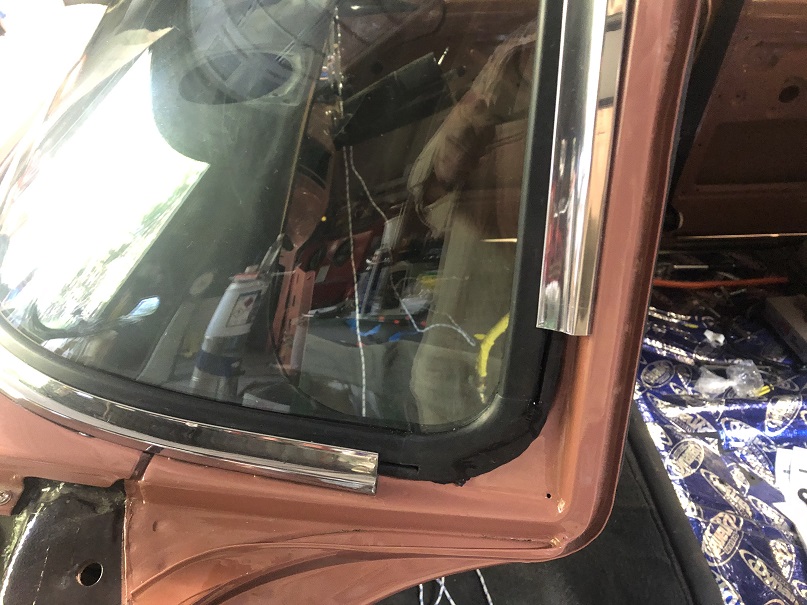

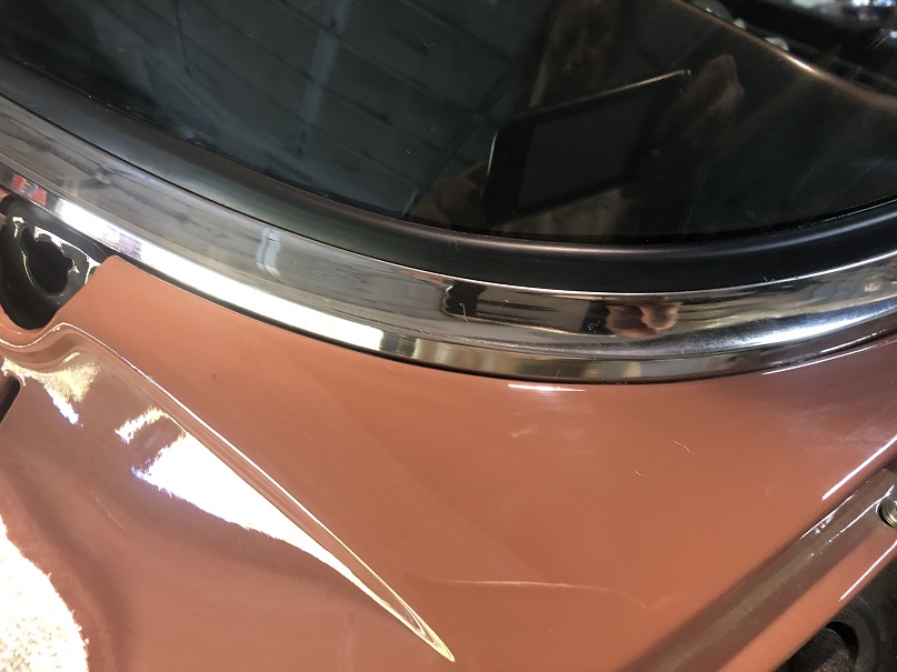

So it wasn't that difficult just a bit time consuming and adrenaline rushing in case I broke it !!! [attachment=0]IMG_1158.JPG[/attachment
The trim on the top wont sit exactly how i want it so if anyone can show me a photo of trim down the pillar that would be good.
It is strange that the trim sat this way on the glass with the small gap at the top centre and now seems to be to close. I can move it around and its a bit better than the photo but still not quite right.
The bottom sits perfect and the gap is uniform all round so happy with that.
So the verdict ? The trim not fitting right on the top could be a couple of things 1/ The bottom trim sits on the plenum screws and wont allow the glass to come down any further or 2/ the glass is slightly different shape in that area at the top roof corners. The reason I say that is because that's the way it sat when on the glass only. Like I said I can move it around slightly and will try and massage it some more during the week. The other disadvantage is its cold so the rubber is still a bit stiff, I would like to get it in the sun and see if I can move the trim around still.
I think the rubber is fine and it sits very nicely on the inside of the car and looks to be similar to the original, unfortunately due to some variables its not easy to blame one thing or another. The true test would be for an original screen in a car with original trim.
I will not be removing it any time soon as the screen is laminated and will surely break unless I cut the rubber so it will have to do at the moment.
I would not hesitate using this rubber again as it was strong and didn't give me any issues pulling it in.

By your second photo I reckon the top left wants to come away from the centre 1/4” at most. Last photo seems to support this. May be the angle, but looks like the gap in the middle is pretty narrow, and bottom end of offending trim may be tad high. Does corner garnish cover the end? How does the hole line up in the corner? Hopefully you can wriggle and pull it in with the screw. This is why I like the old zone toughened screens, you can whip them back out and tweak.

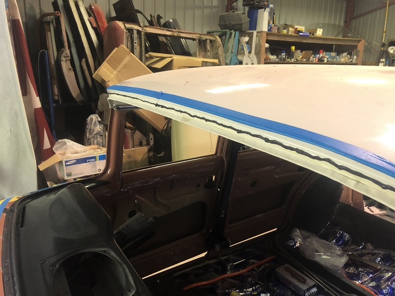

Great work and thanks for documenting. I note your placement of sealant bead on outer edge. Did you use the Wurth Dab Off?

Mucked around with late this arvo and got it a tad better. I'm putting it down to the glass curve at the top just not 100% but close.
Yes Wurth on the edges only where the rubber sits so its not a waste and messy. Tested it for leaks and there is none.
