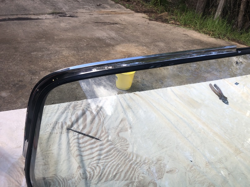

Started the windscreen rubber comparison this morning
Competitor rubber is smaller in diameter and tighter (smaller) in the opening than the rares one.
This is good for me as I dont have to stretch the rubber around the laminated screen. It actually fits it very well.
I checked the fit to body of the trim pieces and put them in using lots of soapy water, when you squeeze the trim in you can hear it click over the rubber lip. If its not right then there will be lumps in the rubber along the window glass. Squeeze and work it till they are in place.
Not real hard and took me about on hour all up.
Final product

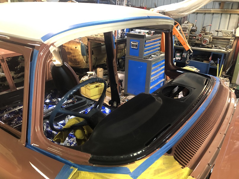

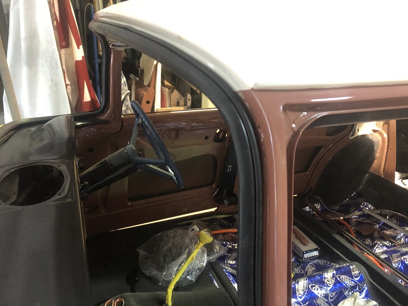

All the trim fits in well
Taped the opening so no scratching. I have to put my drip rail molds on then I can give the screen a go !

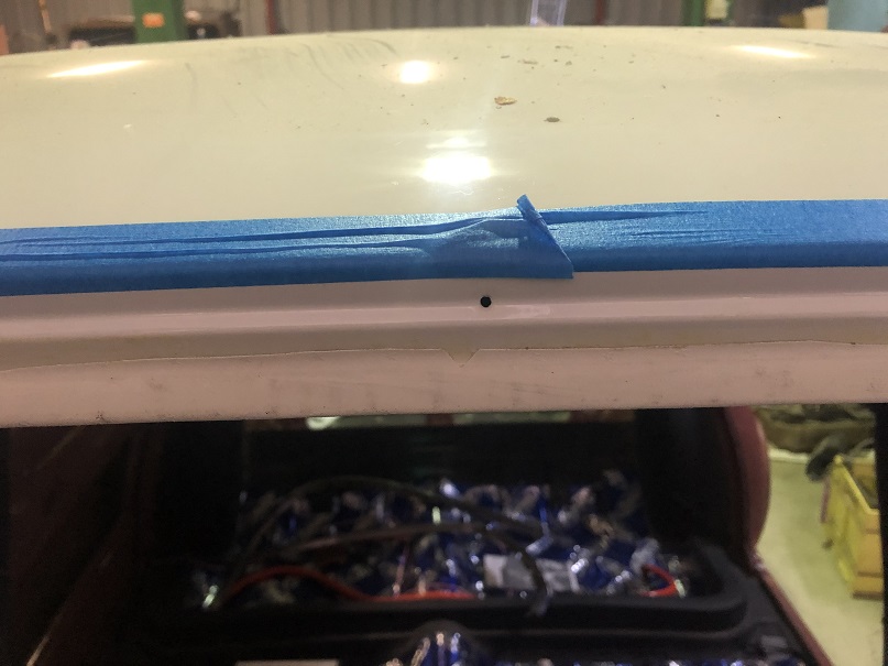

Hey Greg, probably a bit late now, any chances of a close up of the clip retainer screw hole at the top, mine seems to have been filled up, don't know where it's supposed to be.

briby wrote: Sat May 30, 2020 4:35 pm Hey Greg, probably a bit late now, any chances of a close up of the clip retainer screw hole at the top, mine seems to have been filled up, don't know where it's supposed to be.
Mine too. Took a lot of fiddling around with a podger to find the trim screw holes once the screen was in place.
I learnt a lesson recently from a wise man with a Wedgwood Blue ute... when welding, bogging and painting, put self tappers in those holes. That way they are still "there" when it comes time to put the screen in.

My advice is to trial fit the trim using small clamps to hold it against the lip, unless you are reusing your original trim. The centre fixing can be cut from a bit of body sheet, the thinner 20#, and this bears on the highest part of the trim, just below the roof line. You can see in the photos that I had to redrill mine. My ute originally had painted mild steel trim which was too rusted to reuse, so sourced the commoner stainless special trim. I will fill all the holes with windscreen sealant when I put the screen in.

Clay beat me to it.
Hole only.
Its obvious that every car will be different because of the hand made aspect, the hole in mine seems to be lower than Clay's and to be honest I cant find or remember seeing that clip when I pulled the screen out.
