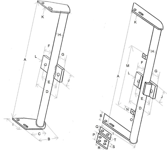

I know this is a bit of an old thread but now that the photos don't work is anybody able to explain what the letters are for all the measurements? I need to make a tabor for a FB sedan.
Cheers Ben

Apologies for the missing images... PhotoBucket no longer wants to talk to me. Image below will help.
towbar sketch.jpg (114.34 KiB) Viewed 9093 times

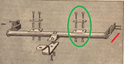

Thinking through, there are some big differences in the types of towbar out there. They all bolt through the rear bumper bolts. Some (probably most) have the end plates directly welded onto the drawbar, like the images below:

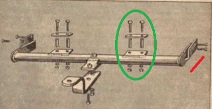

The towbar on the FB was of this type, and did A LOT of towing. The towbar on the wagon though has stepped rear end plates, like the image below:
Towbar indirect weld.jpg (33.6 KiB) Viewed 7792 times
The part that bolts to the Holden subframe is a small run of angle, welded on to the main end plate. The weld is oriented as per the red line on the diagram, and is what gave way. Looking at the failed weld, it has some rust in parts which says it has failed over time rather than abruptly. Looking at the design with an experienced chassis fabricator yesterday the verdict is that the design is not well executed, and puts substantial load on the fillet weld. The fillet weld was a lot less substantial than the welds used to hold the main bar to the end plates.
The other difference between towbars are that some of them have auxilliary mounting tabs, circled in green above. The tabs take some of the load off the endplate welds. The towbar on the wagon did not have these tabs. From memory the towbar on the FB had those tabs.
The lesson for me: if you really want to tow with an FB/EK, then aim for a towbar without the stepped rear end plates, and one with the auxilliary mounting plates.
