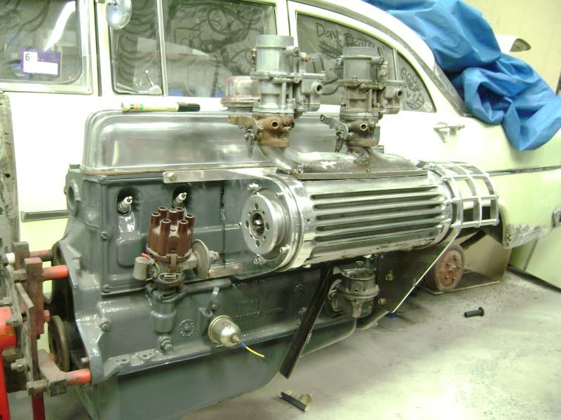

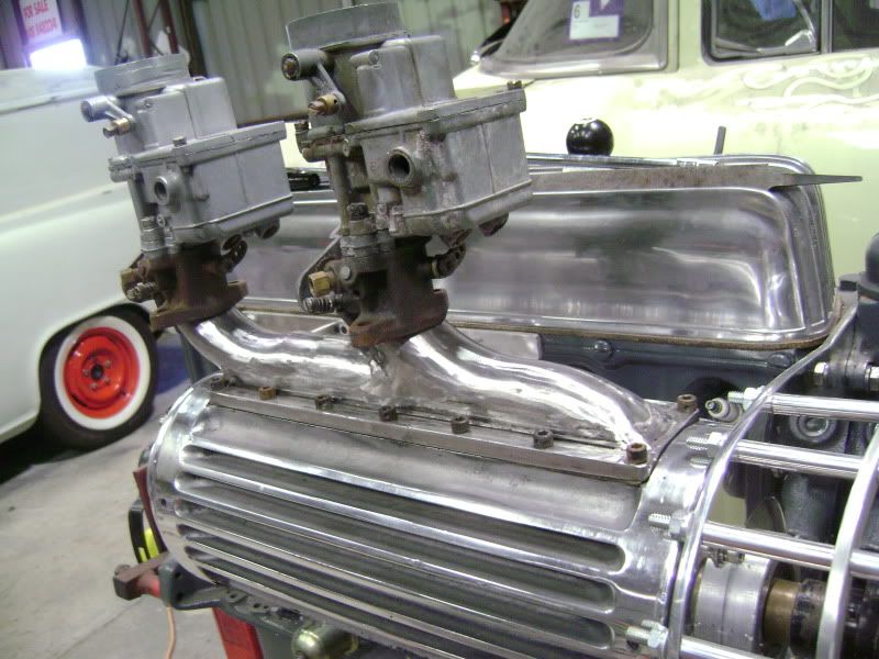

few mor pics
in the process of making a manifold at moment
will be running a 3 belt pully set up on it
also pipe work will come over the top of the rocker cover split into a twin carb manifold ratio is almost 1 to 1 boost should be around 9 to 12 psi
***just cruise***

WHAT THE????

very kool
9 to 12 psi
no big revs to offten or you'll be driving over yor crank
unless you've addressed that issue

by Stygian » Sun Dec 13, 2009 9:32 pm
I suspected as much...
What an awesome grey... will show up some of the red motor boys
I'm with ratbox on the boost though... 12 psi? Hope you're running a steel crank...
