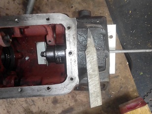

some rough tools
I thought that while I'm waiting for the gearbox kit to turn up, I may as well get some bits ready. I started by pressing the bearing off the clutch gear (it wasn't coming off with light tapping). I'll probably be using the press and a bit of pipe to press the new one on as well.
t clutch gear bearing.jpg (28.72 KiB) Viewed 993 times
that got me thinking about the main shaft rear bearing - which I'd prefer to press in rather than tap in (I didn't mind tapping the old one out because it was going in the bin anyway) - so I got a couple of bits together ready for that
t rear bearing 1.jpg (31.75 KiB) Viewed 993 times
when I was pulling the bearings out of the cases, I changed the profile of my snap ring wedge a few times from the one I'd seen pictures of, until I was reasonably happy with it (by pushing the tool in from underneath I could see where it was making contact - I also chamfered the edges)
t rear bearing 2.jpg (36.65 KiB) Viewed 993 times
a few more bits to pull the main shaft through
t main shaft.jpg (29.96 KiB) Viewed 993 times
and some bits of 16mm chrome curtain rod (painted ones leave paint behind) to load the counter gear rollers and hold the rear thrust washer ... my plan is to leave the rod in place and push it through with the new counter gear shaft
t counter gear.jpg (33.69 KiB) Viewed 993 times
