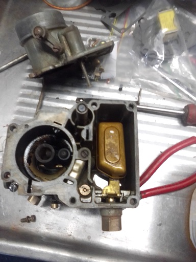

rainy day - so a good day to put a kit in the carby...I had the throttle shaft re-bushed a while back but hadn't put it all back together.
not in bad condition - the main jet plug washer was missing and you might be able to see in the pic that the last person to have it apart didn't get the float pin clip all the way down on the left hand side (it is a damn fiddly thing I suppose)
Posts: 11653
Re: Gimme 5 years
Re bushed the shaft. Should be easy to get smooth idle as long as you get the butterfly valve seated nicely.

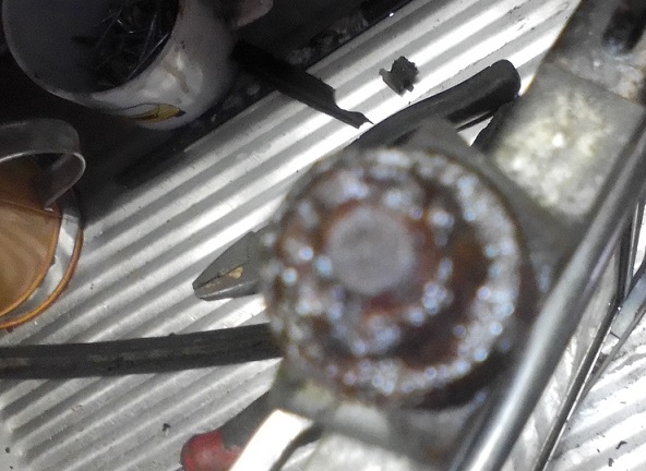

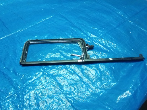

another rainy day - I always wondered about the nut on one of my spare quarter windows - it's pretty chewed up, so someone has had a go at it before - but it has the look of either it will just fall apart or it's solid as
good day to find out
quarter 1.jpg (98.17 KiB) Viewed 761 times
I've read the 'quarter window thread' so didn't want to give it too much of a twist with the vicegrips
quarter 2.jpg (68.98 KiB) Viewed 761 times

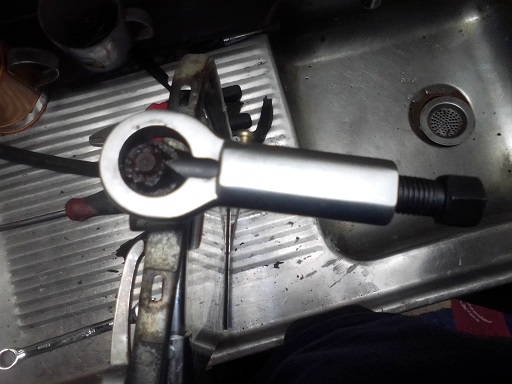

so moved onto the nut splitter, but it was pretty solid
quarter 3.jpg (71.91 KiB) Viewed 761 times

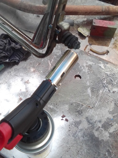

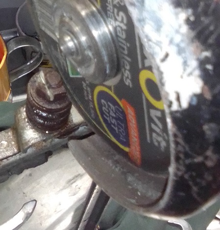

even with heat none of the above was doing anything
quarter 4.jpg (92.41 KiB) Viewed 761 times
I'd sprayed penetrating oil on it every now and then as well (but not really enough time for a good soak)...I've got another spare one out there soaking now - but if it puts up a fight tomorrow ... angle grinder
Considering the shaft has flats on it, it's actually easier to just cut the nut down along those two flats and the end bits 'fall' off
- but that would have made it a short day

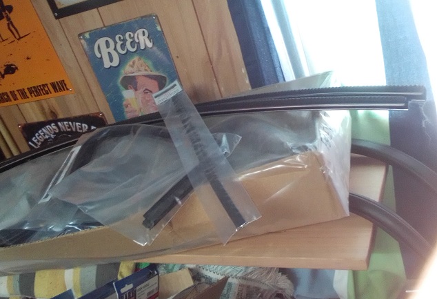

some bits out of the rubber kit
quarter 6.jpg (94.29 KiB) Viewed 747 times
these windows were 'spares' but actually look better than what's on the car so I'll use them
quarter 7.jpg (101.54 KiB) Viewed 747 times

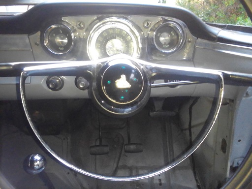

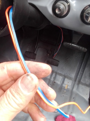

I put the indicator switch back in so I could check if things work. I don't know if there's a better way to get the wires down the column - they didn't want to go as one bundle so I ran two separate draw wires down - still a tight fit
Started by checking my wiring to the back - wiring is all good but when I tidy up the tail-lights I'll have to clean up the mounts so they actually earth - cleaned up around one bolt hole and tail and brake lights worked.
Indicators didn't do anything so I took the relay out and got a handful of rusty water ... new one coming.
Radio, heater fan, wipers and horn all did something and I put a multi-meter on all of the wires to the front lights - and all seems good
column 1.jpg (63.49 KiB) Viewed 718 times
column 2.jpg (72.43 KiB) Viewed 718 times
Posts: 11653
Re: Gimme 5 years
Looking good. One at a time I did the wires down the column.

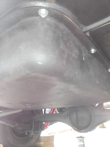

welding is finished so I put the tank back in

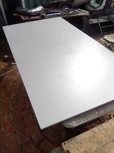

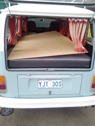

also bought a sheet of marine ply
tray 1.jpg (67.11 KiB) Viewed 668 times
cut it down and put a coat of primer on it
tray 2.jpg (62.24 KiB) Viewed 668 times
Posts: 11653
Re: Gimme 5 years
So you fit 1200x2400 sheet in the kombi.

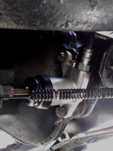

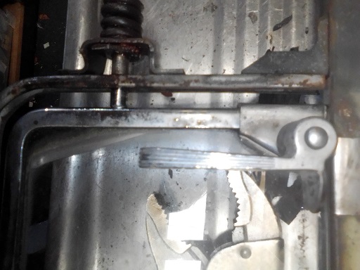

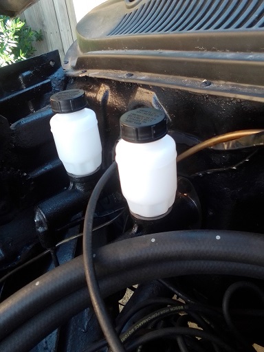

put in a couple of these
cylinders 1.jpg (73.16 KiB) Viewed 651 times
and one of these
cylinders 2.jpg (61.28 KiB) Viewed 651 times
Posts: 11653
Re: Gimme 5 years
I see you have the clutch throw out lever return spring installed
FJWALLY
Posts: 1833
Location: Forest Hill
Re: Gimme 5 years
Post by FJWALLY »
Did you buy the spring new or already have it - I still haven't been able to find one.
62ekute wrote: Wed Nov 04, 2020 11:20 am put in a couple of these
and one of these
62ekute
Posts: 645
State: ACT
Re: Gimme 5 years
Post by 62ekute »
the spring came with the car - it looks original (old) ... have you tried Bunnings - they have a range of compression and extension springs (unfortunately the website has the same stock image for all of them)
