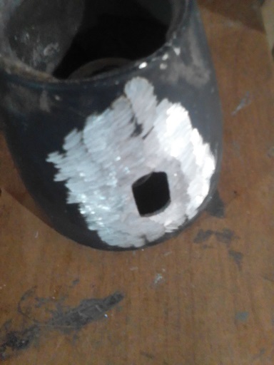

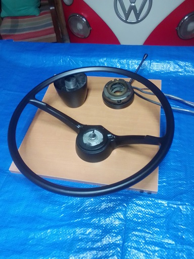

anyway, so I took out the honey pot and cut away the gearshift pivot and patched it up (I've got a NOS honey pot if I change my mind)
honey pot 1.jpg (46.86 KiB) Viewed 762 times
While I was at it I 'removed' some cracks from the steering wheel

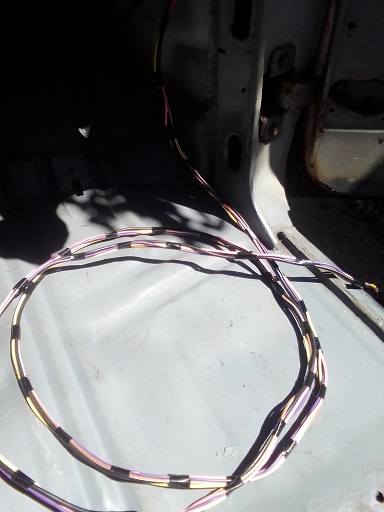

so I grabbed some black, brown, yellow, pink and purple and made up a loom for the rear

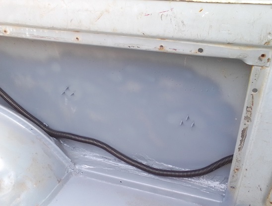

I decided to put the loom through a conduit out the back (I wonder if the wrecked loom started way back when they screwed in the tonneau hooks)
anyway, I got the rear wiring finished - then had to get ready to go out for early beer

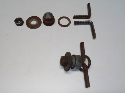

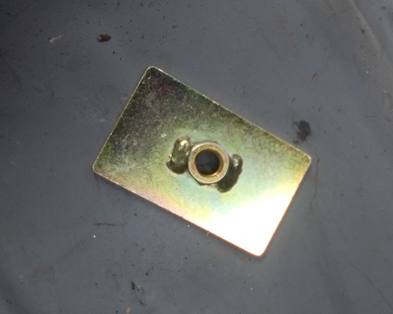

replaced the dodgy upper seatbelt mounts
seatbelt top mount.jpg (33.47 KiB) Viewed 700 times
with some of these
seatbelt mount 1.jpg (57.67 KiB) Viewed 700 times
seatbelt mount 2.jpg (44.81 KiB) Viewed 700 times

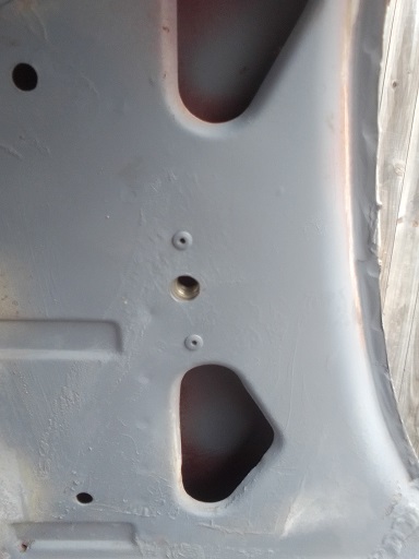

temporarily put the carpet in and went underneath with my whiteout pen and marked the carpet through the holes for the accelerator, gear stick, dimmer switch, seat and seatbelt mounts

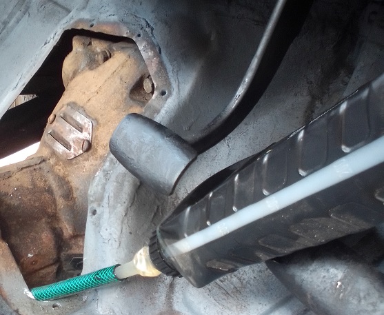

also put some new oil in the diff and gearbox
gearbox oil.jpg (103.54 KiB) Viewed 677 times

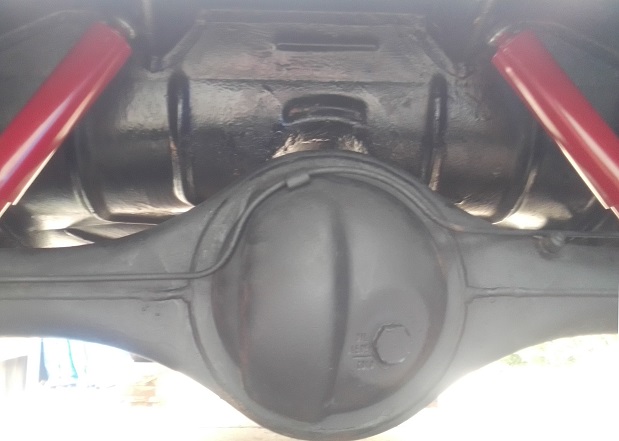

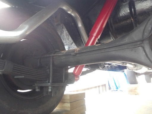

some more black paint underneath and new rear shocks for a bit of colour
shocks 1.jpg (68 KiB) Viewed 677 times
Posts: 11653
Re: Gimme 5 years
Swish’o those shocks. You’ve just made me realise why the inspection cover has that shape in it but there is no way I’m t@king mine off now I’ve got the interior in.

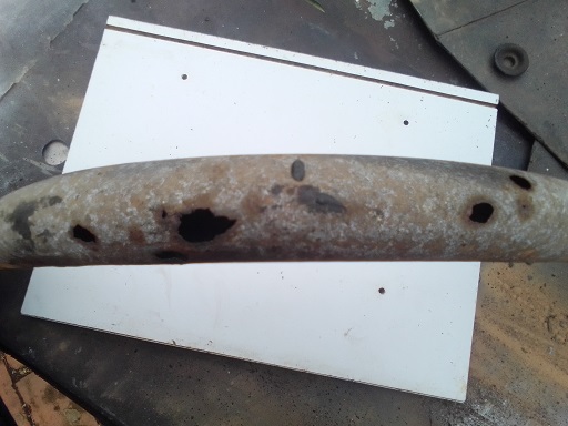

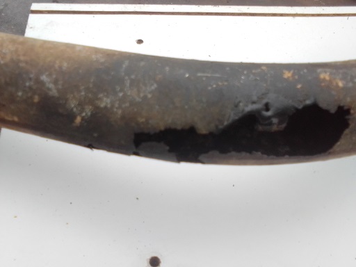

mainly a bunnings, repco, rares and exhaust shopping day today - I left the old muffler in for now but from there back wasn't worth saving

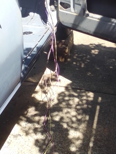

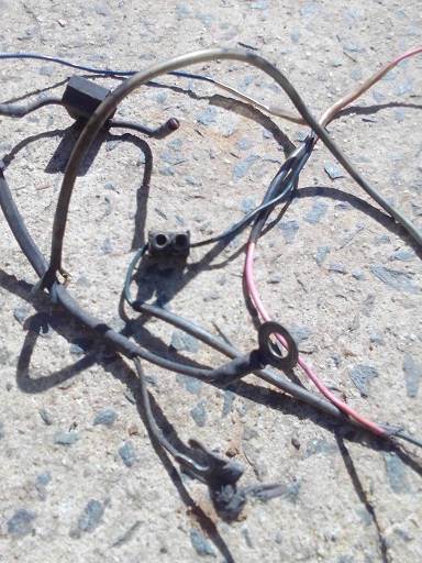

replaced a few more wires - exposed wires in the engine compartment were a bit rigid - a few had been patched (multiple times?) and the ignition to starter wire was hanging onto the connector by three strands. The wires are still perfectly good in the loom, so I spliced in some fresh ones
