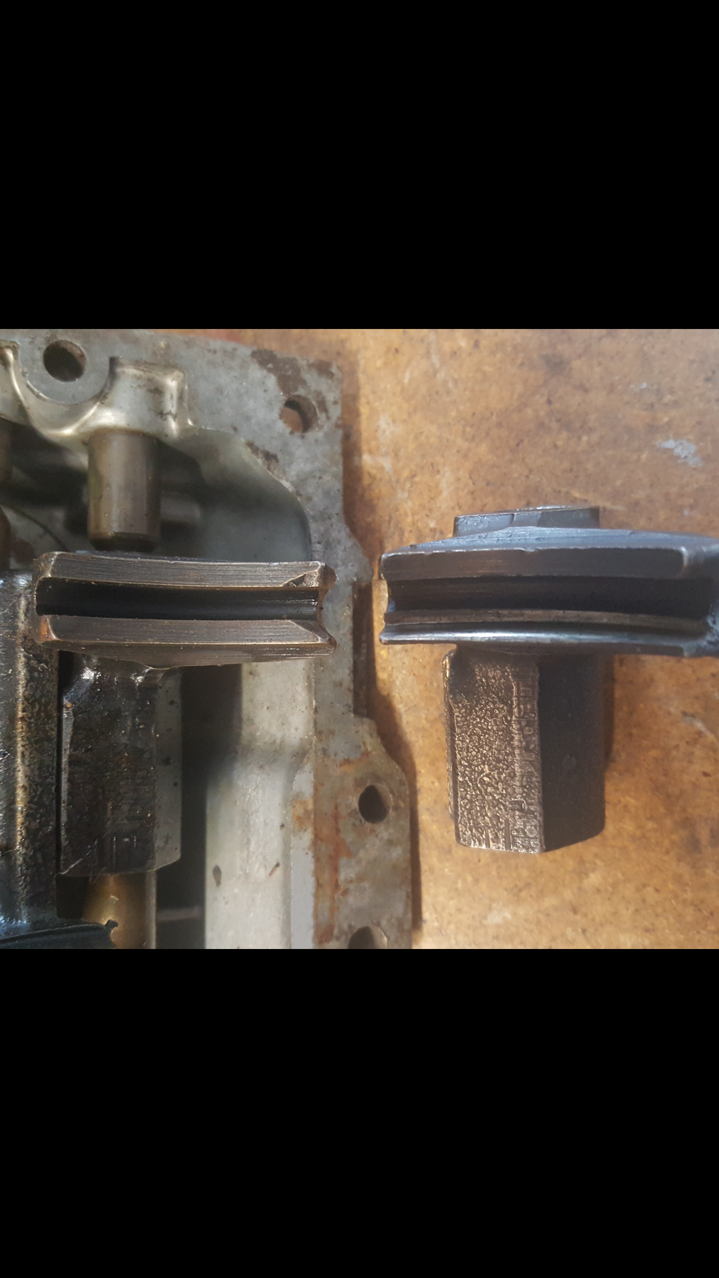

Vince,
You're right. The yoke on the left is the later part, but still for EJ. Better design, as the slideway on the yoke is longer, but it still shows wear in the groove. Side cover: gratis. But it may be the early, early type.

ardiesse wrote:Vince,
There's your problem there . . .
Your "other yoke" looks like the groove is worn out too.
Fractions of an inch: The detent ball in my 7431970 kit is 11/32" diameter. Your yokes take a 9/32" ball, which is less than 5/16". Drilling the bore out to take the bigger spring is a no-go.

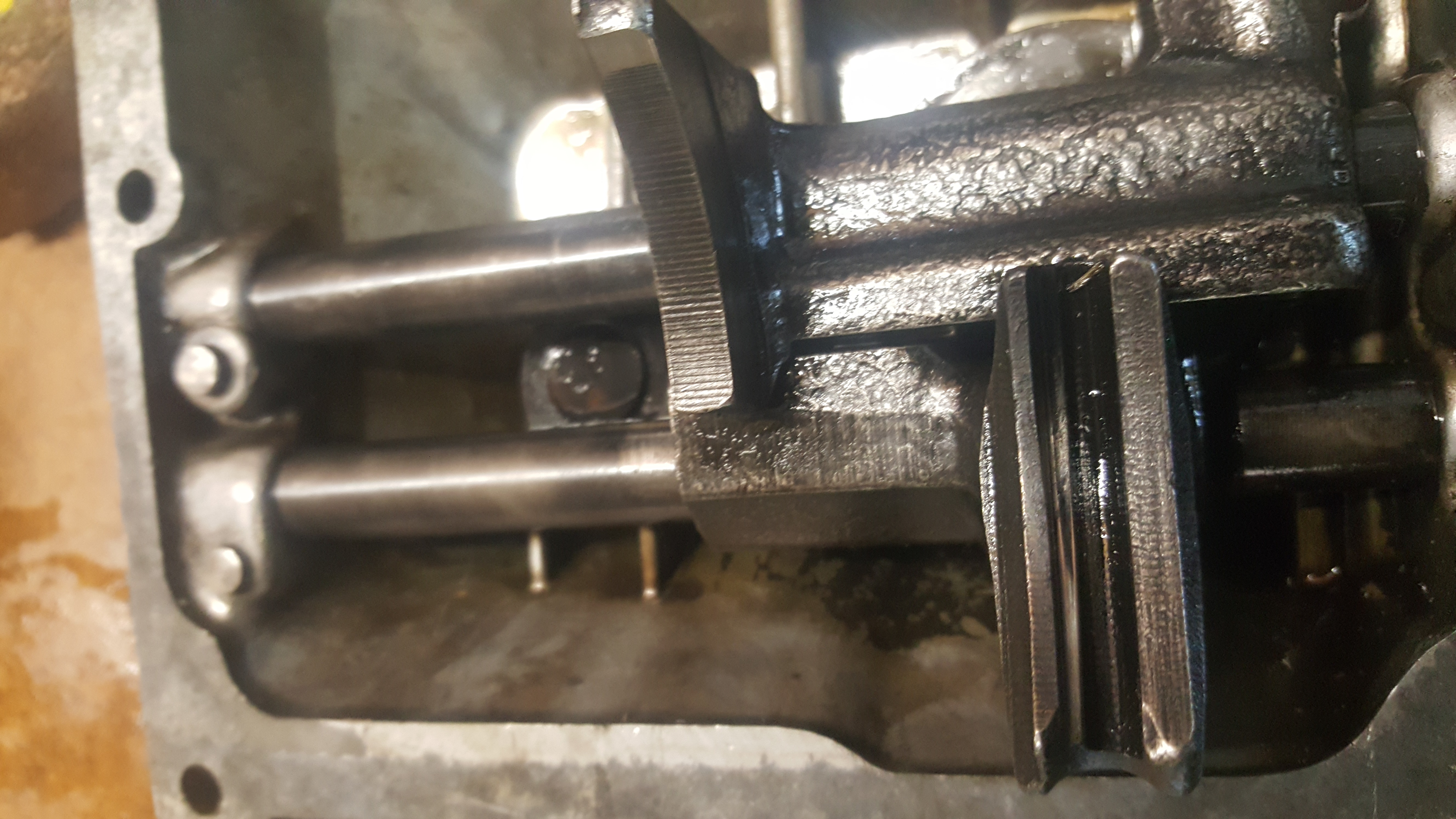

The side cover arrived today Rob, good timing as now given the missus the heads up working on car tomorrow
See the attached photo, parts not at same angle but really illustrates the difference in wear.
Thinking I will use both yokes, shafts and springs out of your side cover Rob, and I have brand new ball bearings to use. Combined with my nos parts I had, should be like a near new side cover.

Re: EJ gearbox overhaul
Try attaching photo again, doesn't seem to attach to post.
- Screenshot_20220225-180844.png (2.04 MiB) Viewed 4288 times

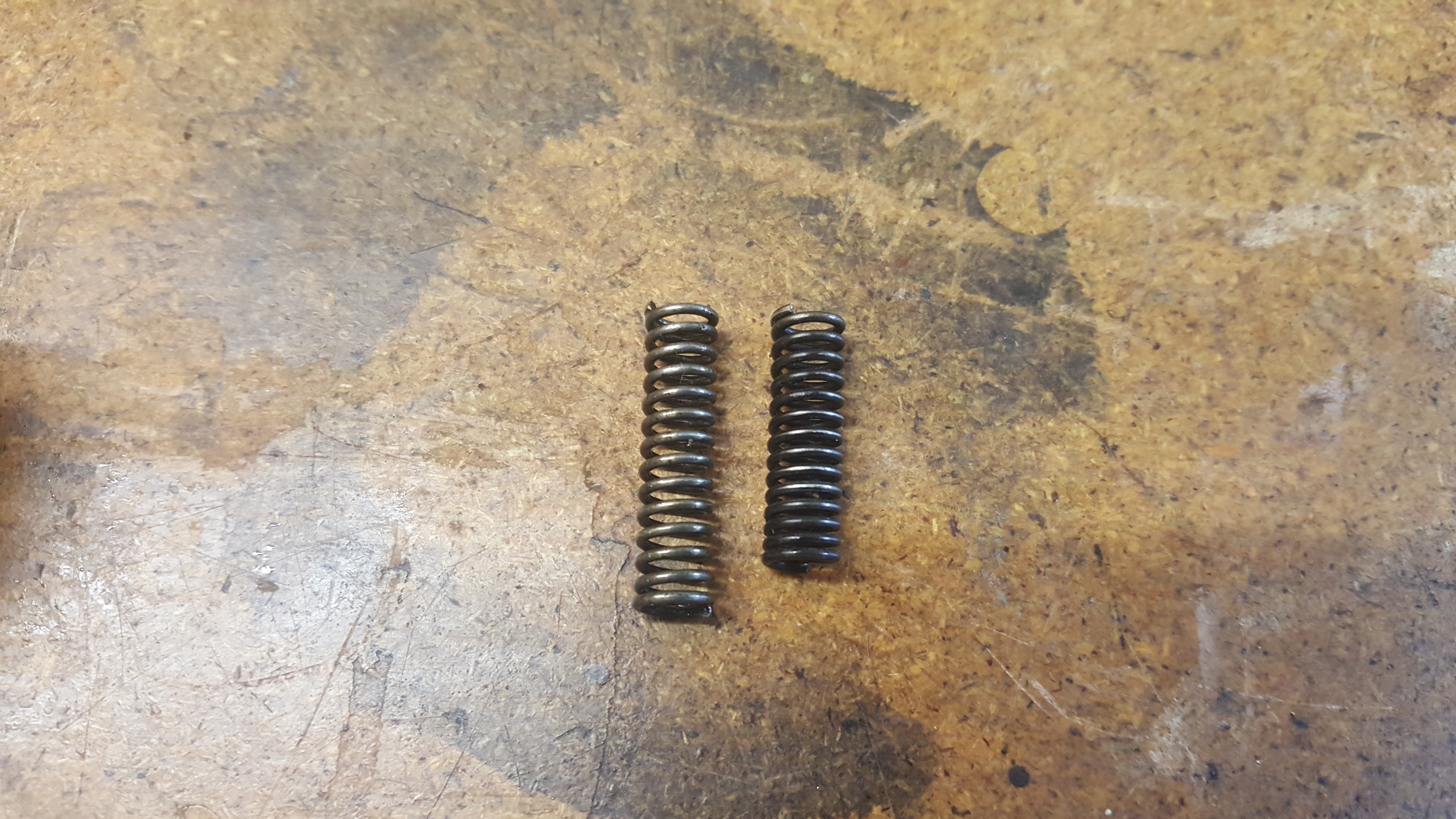

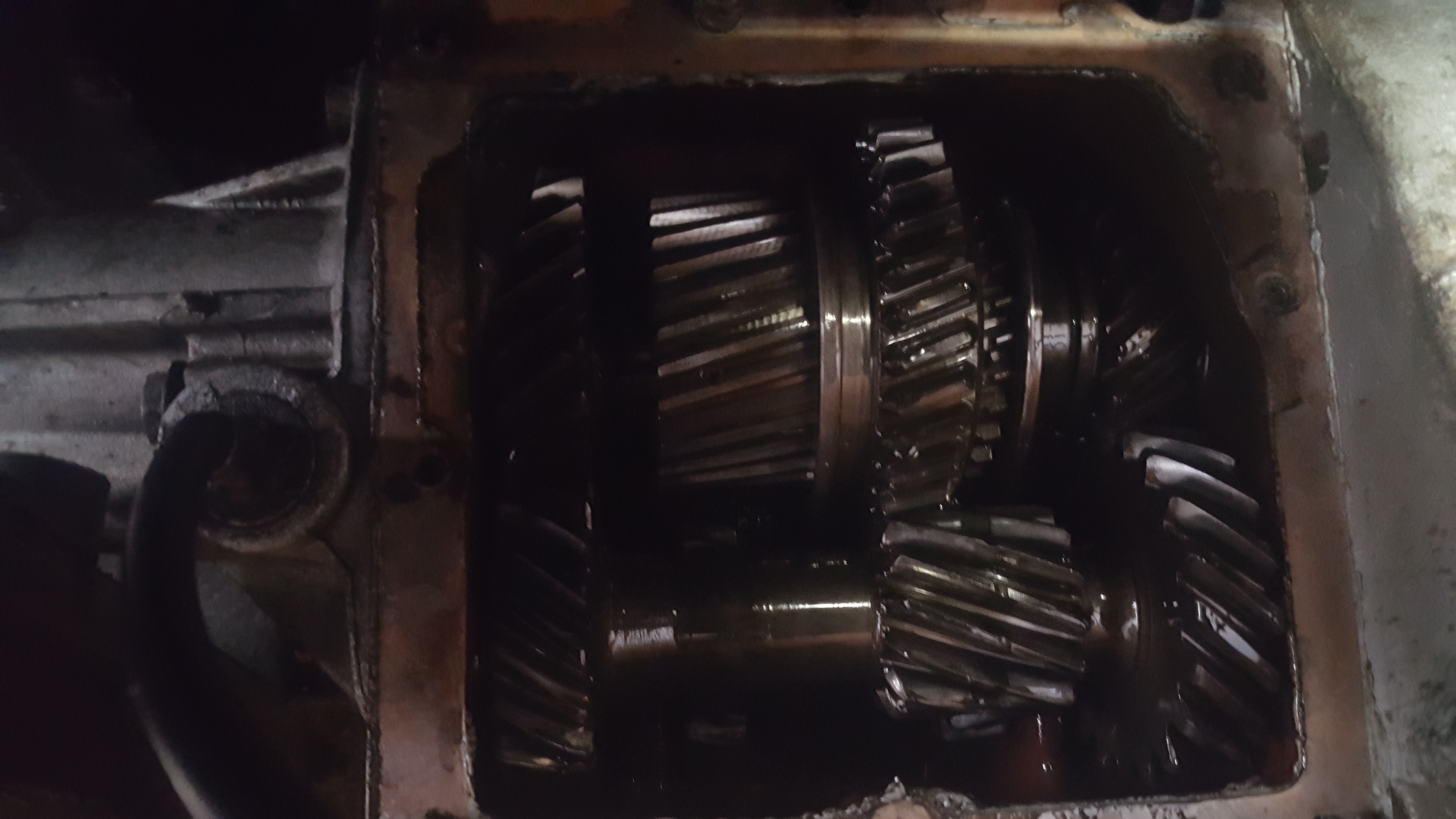

Unfortunately still kicks out of third after putting my new side cover on the existing gearbox, although see photo of side cover from box that was on vehicle and you will see same wear on 2nd and third speed yoke. See also photo of 2nd and third speed detent spring from the side cover from the box I was working on against the one from Rob's side cover which is dramatically different. Photo also of inside the gearbox currently on car, some wear in cluster gear and looks like a burr on 3rd speed gear maybe.
Will take stock and think what to do next, thinking next of switching the gearbox with one on bench to see if it is the box on car. If that doesn't work maybe change bellhousing. Just not sure right now.
