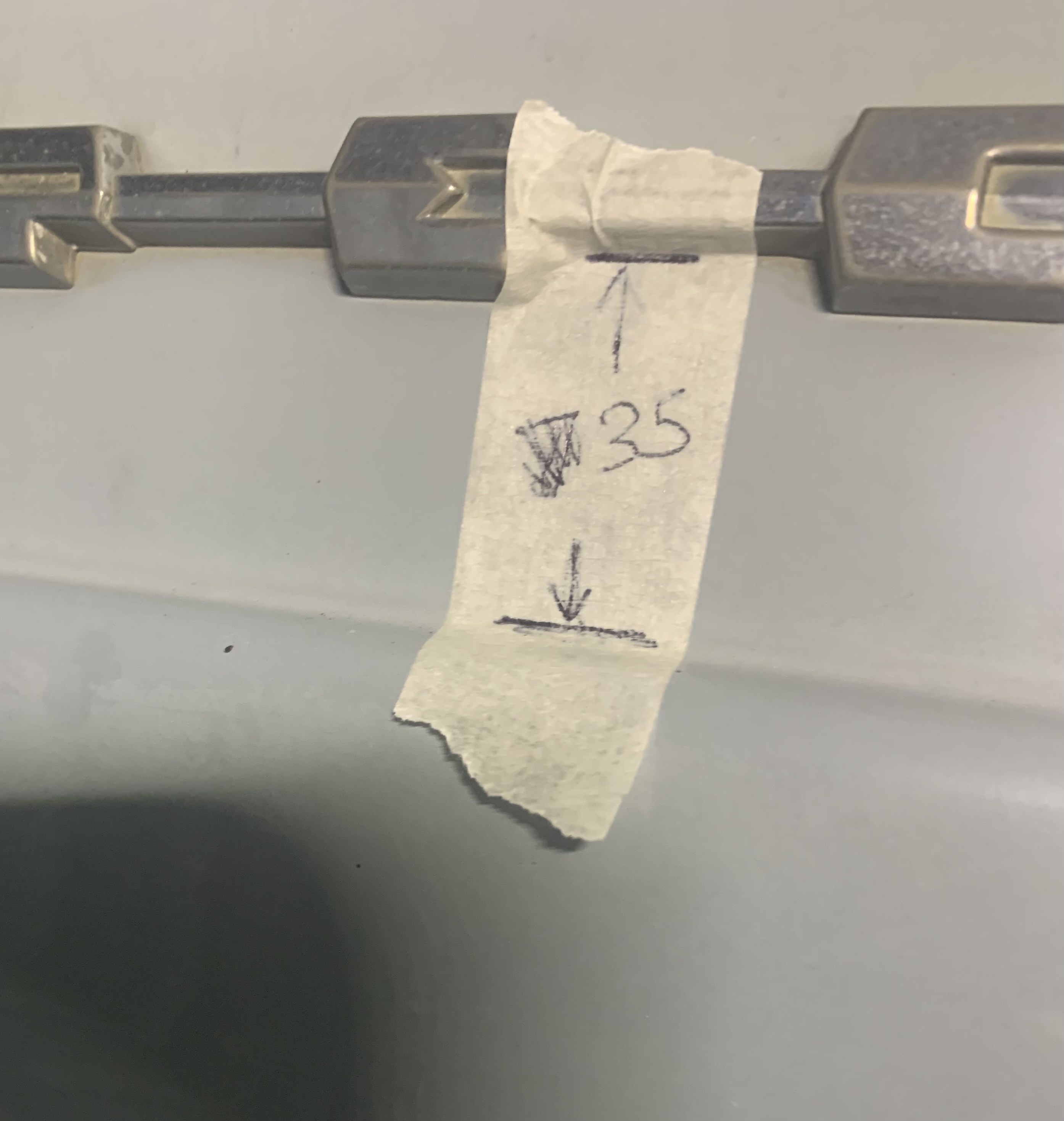

Here you go John
Height of Special badge as shown from guard ridge to underside of centre bar.
Posts: 2071
Re: fb wagon badge location
Photo. All measurements in mm.
Posts: 2071
From guard edge (where drivers door edge is) to vertical bar of first star is 415mm.
Posts: 2071
From centre vertical bar of fist star to same of middle is 105. Same (105) from centre of middle star to third star (closest to headlight.
Posts: 2071
From third star vertical bar to edge of centre bar (goes thro word Special) is 77mm
Posts: 2071
Hope that helps John. That is how the car left the factory. Passenger side should be the same but who knows quality control may not have been a thing back in 1960? :lol:
