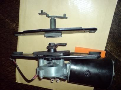

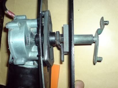

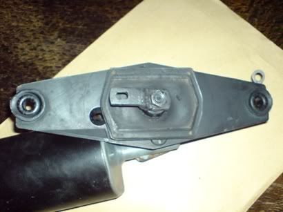

Hi there folks,
I'm in the process of fitting an electric wiper motor to my FB.
I'm at the point of connecting the auxiliary drive assembly to the
connector arms.
I was just wondering if there is any advice from people who
have done this before I go drilling grinding and welding it all to fit.

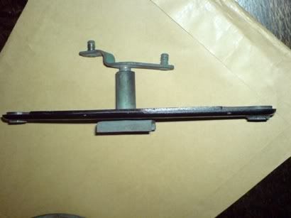

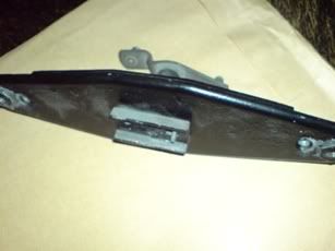

I'm guessing I have to drill out the old auxiliary drive pivot shaft,
shorten it and graft on a bracket to suit the new wiper motor.
See pics for more detail.

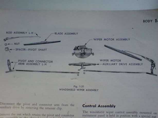

P.S. if someone could take a pic of the coresponding EK shop
manual page showing the electric EK set up I'd be interested
to have a look. Thanks :)
Original auxiliary drive assembly
New auxiliary drive

:) dominic
no cutting or grafting or welding
all you need is the other arm that go's off
the small arm on the back of the motor ( pm
sent ) :) jay
