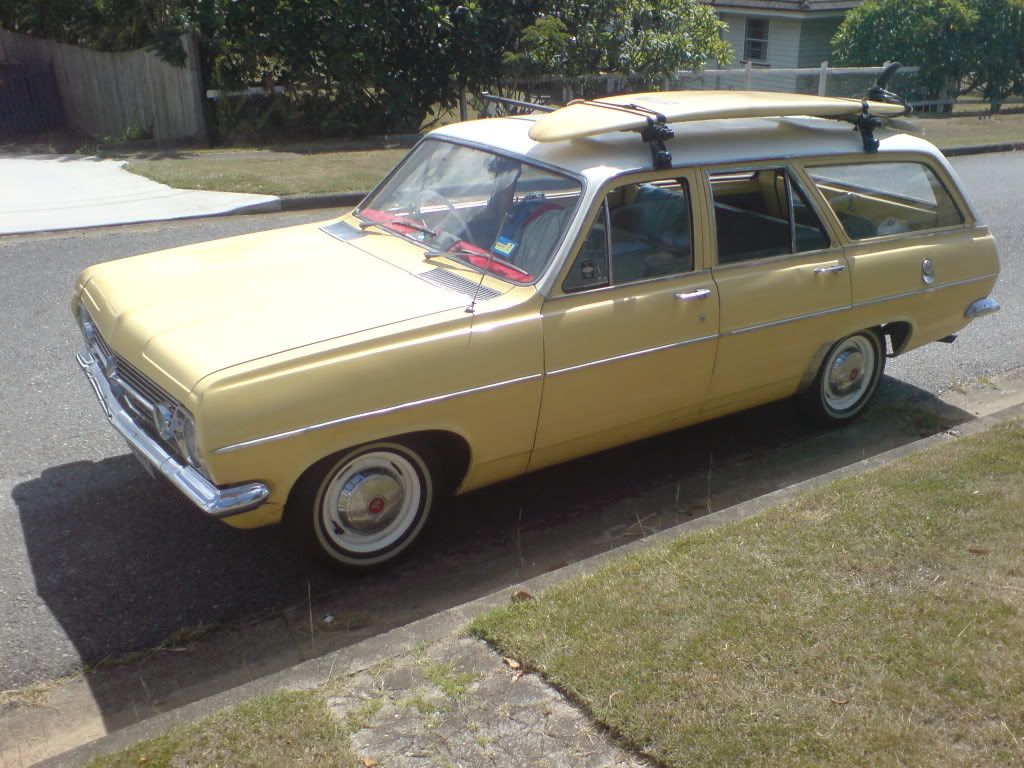

Can I get a set of 15 inch stock rims to fit the same stud pattern for an FB?
If yes what am I looking for?
I have an idea says he.... :twisted:
Does anyone else run 15 inch stockos?
My mate runs them on his HR and they set it off beautifully (see pic).
I was-a-wonderin if they might have the same effect on an FB?

Hate to say it but they're 14's.... HT/G fairly easy to get too.

yep u r right
Post by FB search »
You got it Devilrod,
I just spoke to my mate and told him what I had said...
and he said...
"errr they're 14's"
oops... I guess I'm showing my newness... I measured from the
outside of the rim, but I gues the 14 inches refers to the inside
tyre diameter. Is that right?
Oh well same question goes. Will they fit on standard FB stud pattern?
I'm planning on pinching them off my mate for a sneaky look if they do. 8)

Yeah they should fit fine. What I'm wondering though is with people fitting these to HR front/rear ends, does it matter if you have discs or drums with certain HT/G wheels???
From what I've learned lately is the HT/G rims will fit on a HR disc front, were I went wrong was that I thought I had HR discs on my car but they turned out to be Torrana, so I had to get the HT rims offset so they would fit :twisted: ,

I tried 14" Hk/HT/HG rims on my ute . it has a HR disc front end. They fit but the problem is a Trev has stated.. The offset. HK rims are widened inwards and you end up with a narrower wheel track than you have with standard FB/EK rims. :roll:
Yes you can get 15" wheels to fit your early holden stud pattern ... Volvo wheels have the same pattern and they make em in 14" through to 17"
I have seen them on some dic brake moddded holdens including the volvo rear ends.
Moral of the story.. Try one on both ends of the car to check for clearances before ya handover the money to the seller 8)
