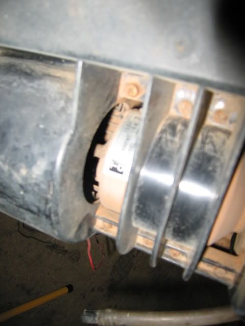

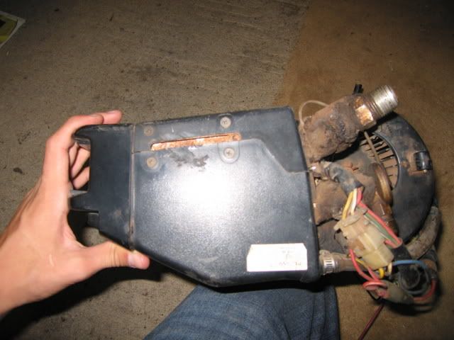

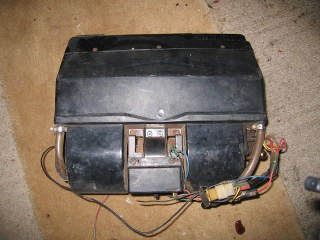

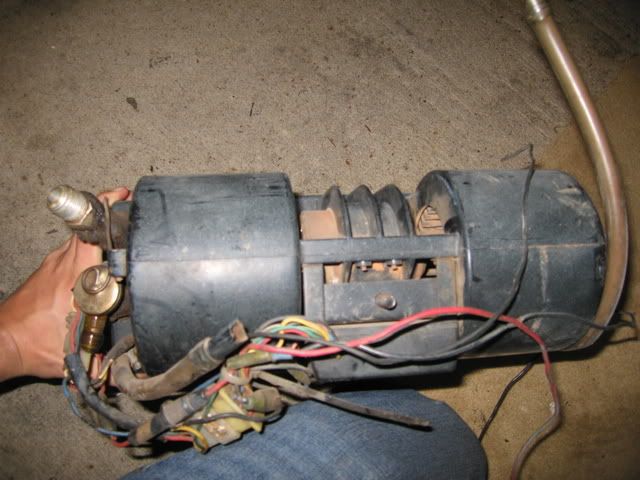

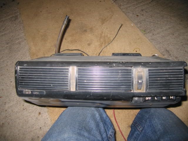

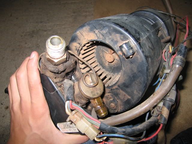

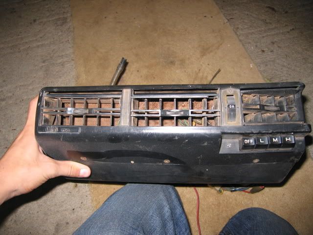

anybody know anything about this units use in my fb? I dont have anything else to go with it, so i guess it needs a compressor, condenser anything else? if i take it down to the local aircon place will they knwo what to do with it? its a smiths unit

i went down to pick a part in maddington and got compresor and brackets of commo blue mtr, its all bolts up to red with a bit cut and shunt. an approx 2000 magna condensor is a snug fit in front of radiator suport, just note that the compresor re-locates the altenator to sit above it, so there is a bit of messing around with drive belts etc.

cheers ben, i will look into it. can i ask how much it costs?

second hand compresor, condensor brackets etc allow 200, i would guess to get someone to hook it all up , ie new dryer, pipes, elec, etc 600- 700. best to try and mount it all up yourself, then get all the connections done

ben wrote:second hand compresor, condensor brackets etc allow 200, i would guess to get someone to hook it all up , ie new dryer, pipes, elec, etc 600- 700. best to try and mount it all up yourself, then get all the connections done
$600 :cry: i might just stick to the good old 1/4 windows:)
