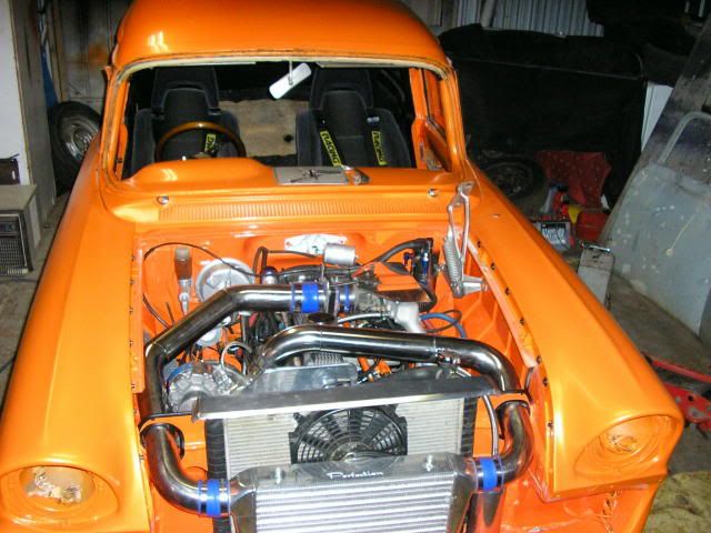

mate go with a blue or black motor from the start better internals
check out www.hotholdens.com
my mate steves ek van blown injected blue 400hp+ he will answer your questions
***just cruise***

just pm him some questions on the link i put up i dont want to give all his secrets away but i can tell ya its one hell of a ride in the old bus thats 4 sure
