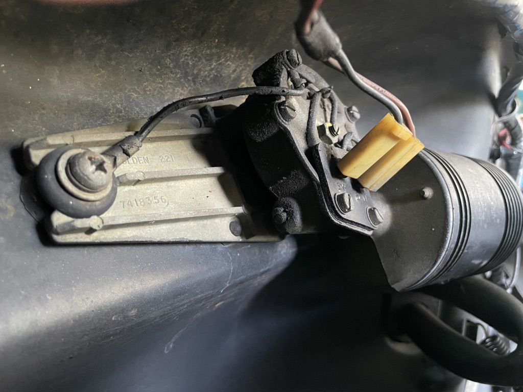

I reckon that will bolt up to single speed mounting plate Steve. A photo of the other side would help. I’m not sure about the switch but I wonder if you should be using a two position earth switching one from HR etc, rather than the later positive switching one you have purchased. I have a few of the HR type, which I would be willing to swap if this be the case.

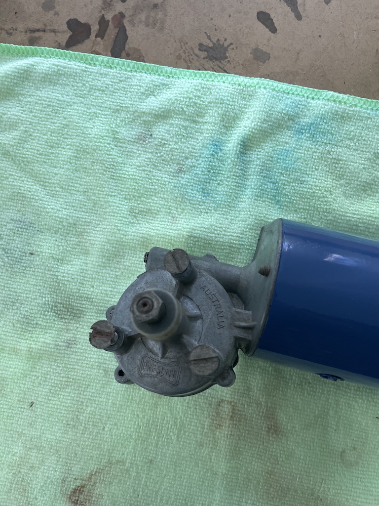

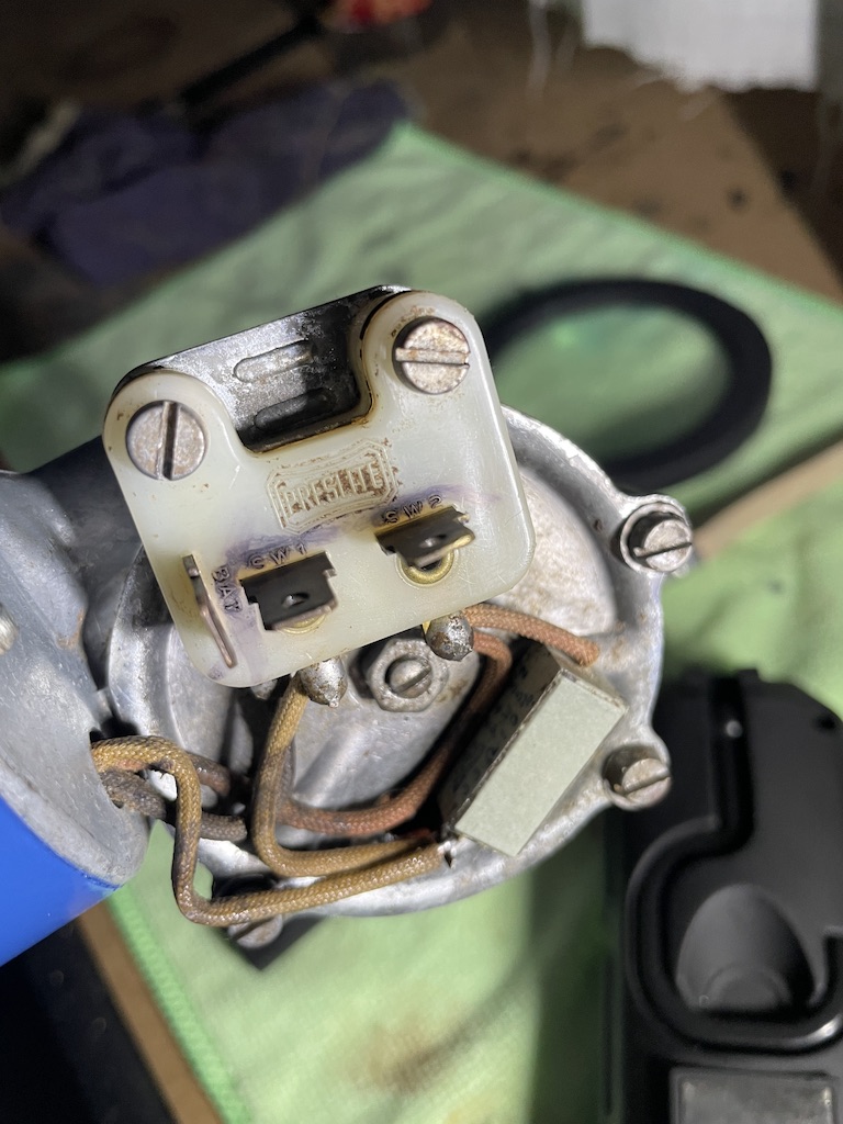

Sorry for the delay ... was cleaning/painting the new unit.

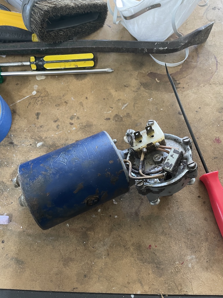

As requested, here are a couple of photo's of the mounting side. Does it look like the OE unit ? Any tips on "how to" for the mechanical swap would be very much appreciated.
Just to describe the current power/switch setup ... i note an earth wire connected straight from the unit to the mounting bracket. I also note the two posts on the current unit ...a brown wire (power) and a black wire (assuming to the switch). The current switch has a single pole for the black wire from/to the unit. The new Preslite unit has three electrical posts ... can I assume an Earth to the mounting bracket and two posts back to the two speed switch ? Had a quick look at a HR and EJ type switches and see they have three posts ... so alternatively could it be earth and two speed wires back to the switch from the Preslite ?
Thoughts ?

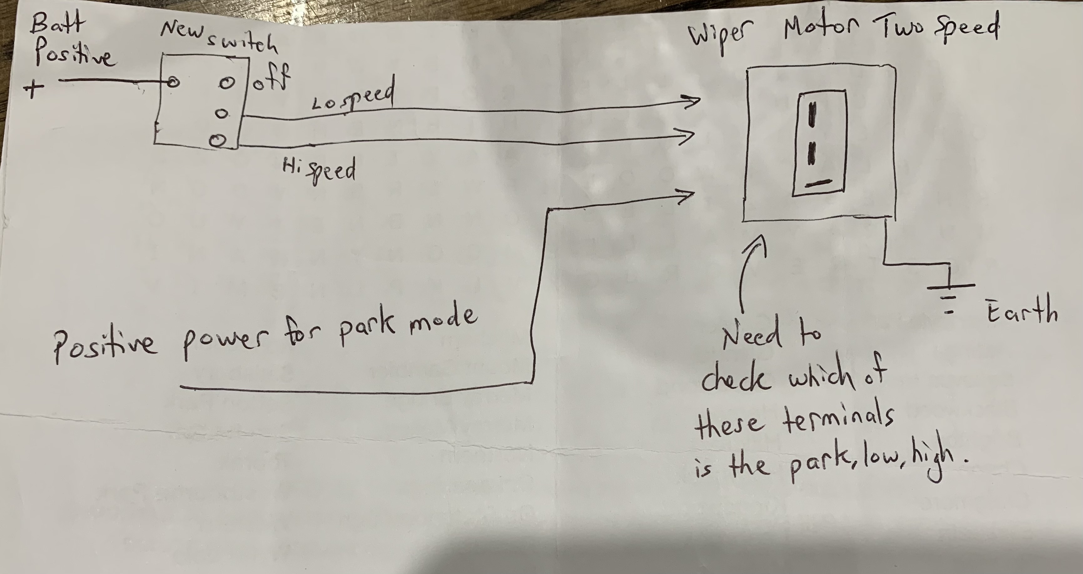

Can’t comment of mounting of the two speed wiper motor. I’m only running original single speed motor. My thoughts on wiring is as per picture. Unless someone else can confirm motor connections you may need a multi meter to check continuity. When the motor is in the “park” position one of those terminals will not have a circuit to the motor body (earth). The remaining two terminals will be low and high speed.
But those who have done the conversion will confirm for you. Hope this helps.

Thanks for the photo Steve. Unbolt your single speed motor from the alloy mounting bracket, and bolt that one in its place.
The earth strap is to park the wipers, so when you switch off the single speed wipers you isolate the motor from ground,earth, 0V, but the blades need to travel back to rest.
On the terminals I would havre thought one terminal to power and two to switch. Position 1 will earth the low speed circuit and 2 will bring in an extra winding. The lster ones are fifferent, being positive switched.

Thanks Stephen ... I appreciate that schematic. Its very helpful and pretty accurate after a closer inspection of the motor terminals ... being Battery, Switch 1 and Switch 2 (see photo below)
Errol ... thanks for the fitment confirmation. Good to know it's a straight bolt on. I'll ping you a PM regarding that HR switch and organise a swap for the Cole Hersee unit.

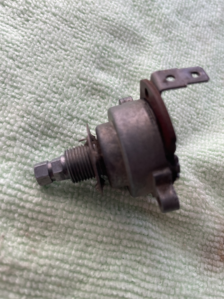

HD HR wiring diagram
Which is identical to EH and very similar to EJ Premier, which is when the two speed motor became an option, then standard from EH.
I hope I haven’t spoken out of turn regarding the Cole Hershee switch, which may have done the job.

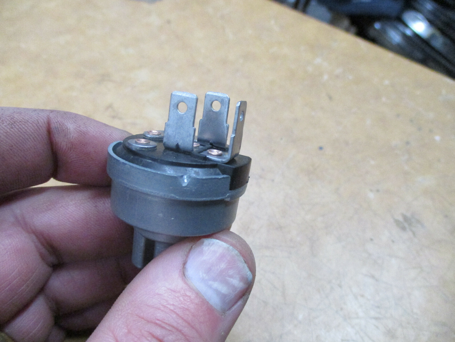

I have three different switch types here. This one definitely came from a HR.
It has 5 terminals, the centre one being for the washer. I get open circuit between the switch body and top terminal in the photo below in position 1.
In position 2 I get open circuit between the next two terminals to the left, as well as the switch body (0V, ground, earth). To me this says you may need to connect wiper 1 to two of the terminals if you want it to get power in both positions. The last or bottom terminal, and the centre terminal both appear open circuit go each other and ground when the squirted button rod is pressed. Hope this gets you sorted and I will post it off now.

Here is a two position switch I have which may be EJ and/or EH. Happy to send you this Steve.
