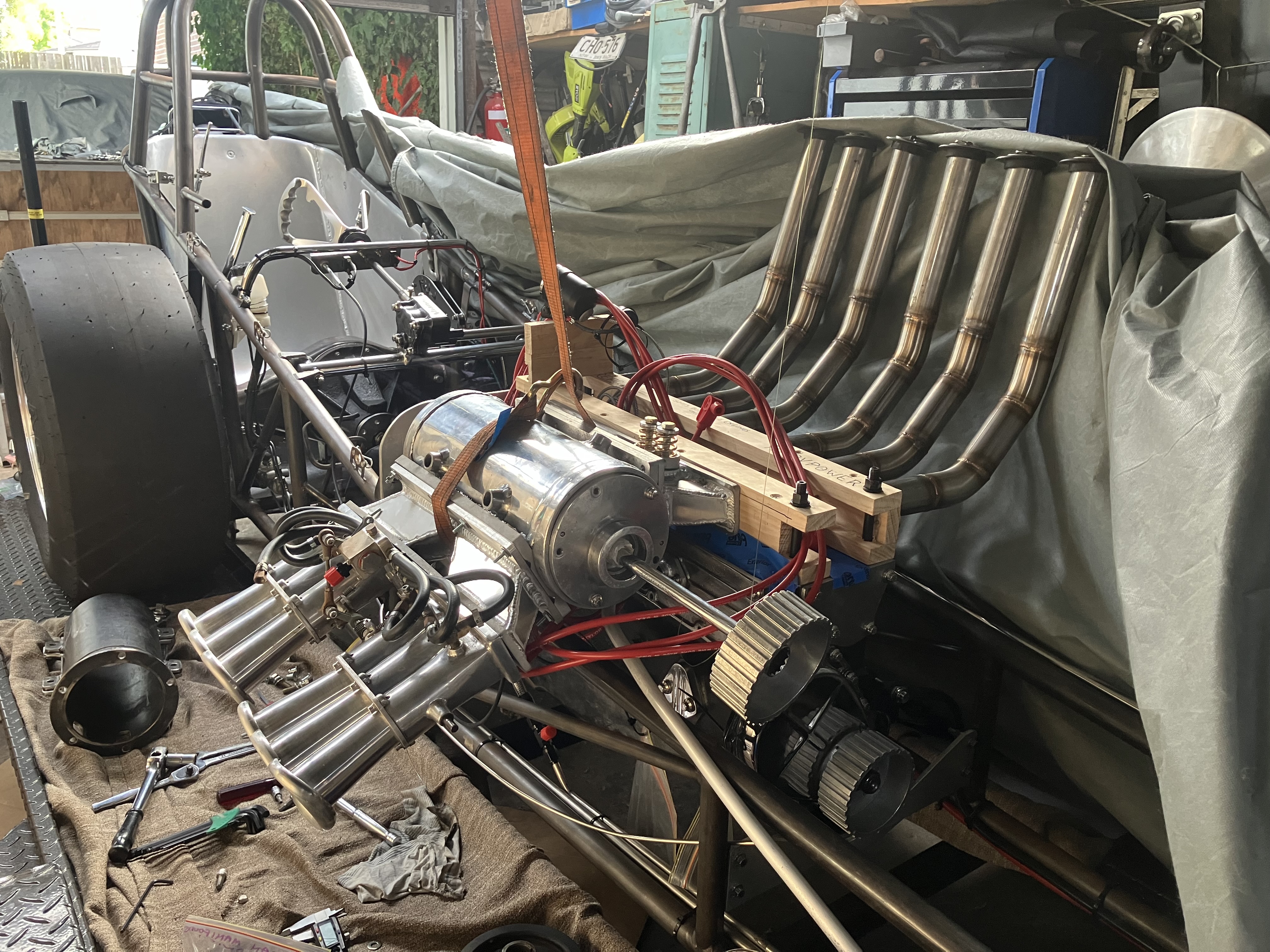

Optional NASCO orange skyhook shown to complement the three particle board screws used to mount the assembly to the wooden dummy head.

That's a very long and lonely shaft Harv

Brett027 wrote: Thu May 30, 2024 3:11 pm That's a very long and lonely shaft Harv
The Norman shaft is about 4” too short. I need to get it cut off, and a new shaft added. Similar job to what one of the Taswegian humpy boys did not long ago on a Type 65. I have a bloke locally that I think can do it. It will need a plumber block bearing to stop the belt tension bending the supercharger. This is the price I pay the get the Norman dead-center into the Repco inlet ports.
