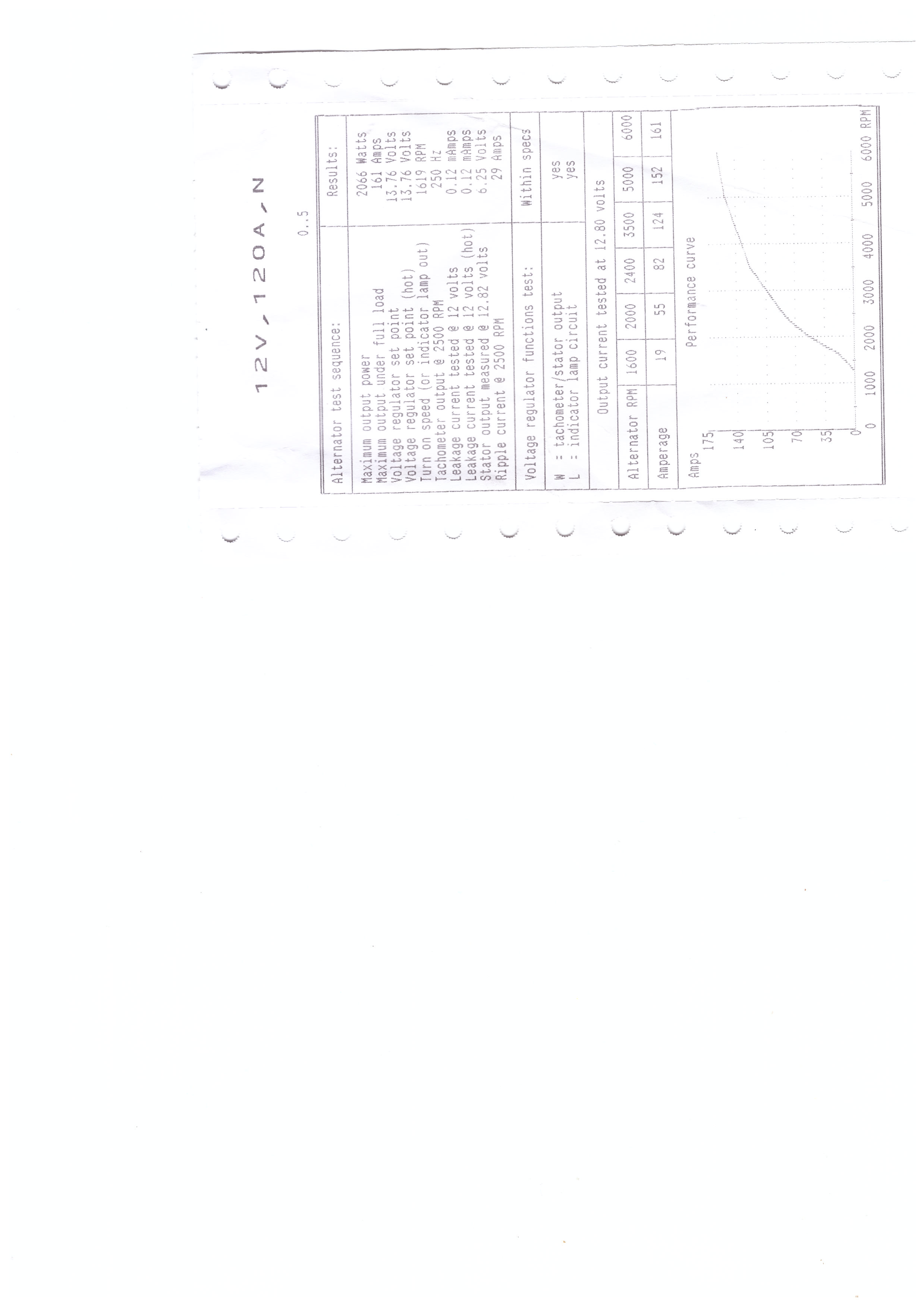

I'm running a knock off Bosch 160 amp. Pulley ratio is about 2:1 so alternator is theoretically producing 82amps at 1200rpm. Seems plenty for my needs. I have attached the output chart for info. Also running a 12inch Davies Craig fan set to come on with aircon. Shroud keeps everything cool.
output graph for 160amp Bosch
Alternator specs ute.JPG (421.34 KiB) Viewed 2807 times

Plenty of options, mine is rated 170A, test bench sticker reads 147 @ engine idle (1000rpm) and 174 max, does still have slight voltage drop as my engine idles @ 800. Depends how much people want to worry about flaring headlights, dimming gauges etc etc. :think: :roll:

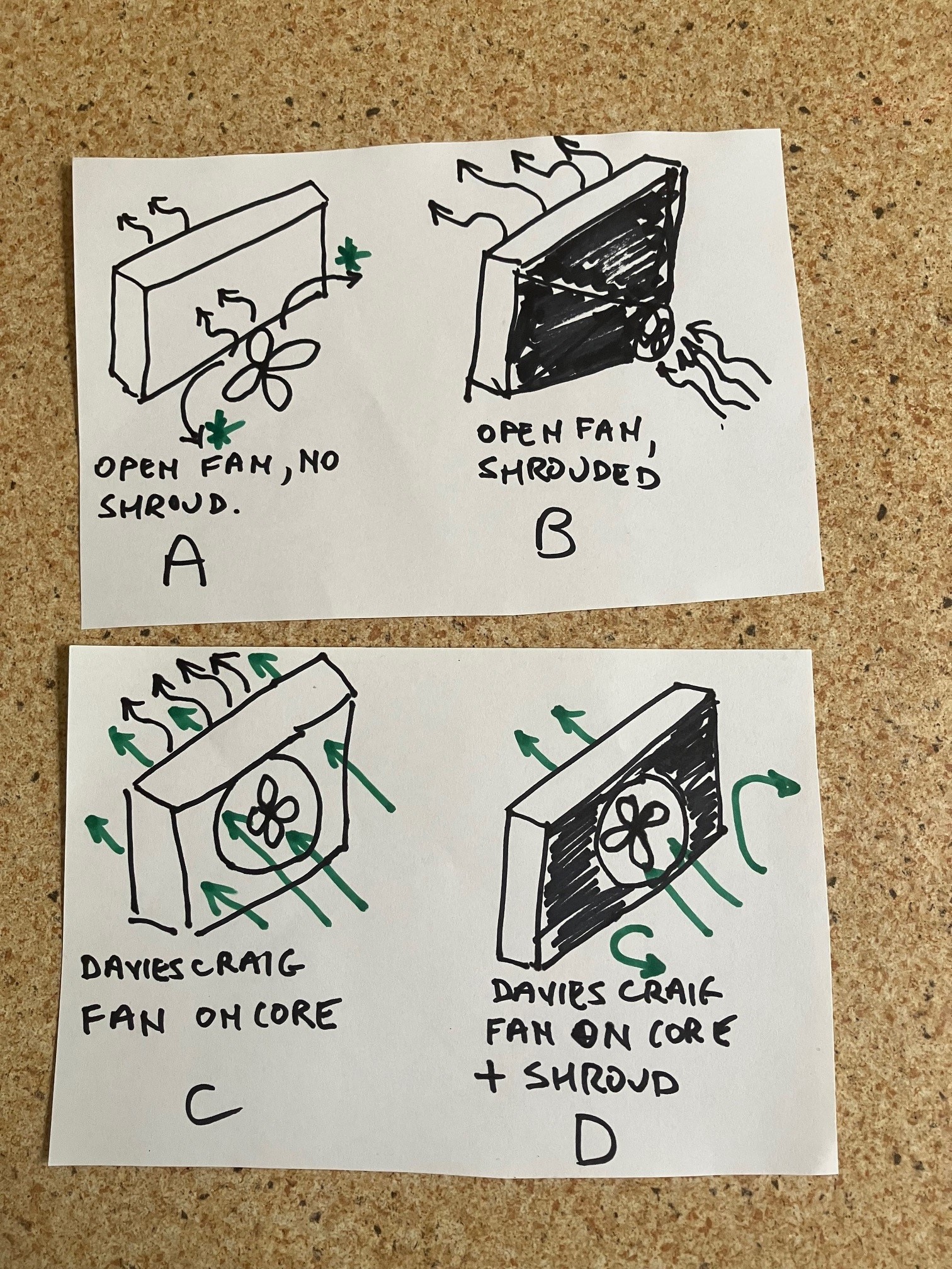

Brett027 wrote: Tue Feb 18, 2025 12:36 pm Also running a 12inch Davies Craig fan set to come on with aircon. Shroud keeps everything cool.
Interested in the shroud design for the Davies Craig fans - is your fan flush with the core face, or set back?
... asking for a friend who needs to put two into Number One Son's VL in the next week :lol:

Hi Harv, fan uses plastic tabs that go through core fins to mount and it sits flat on the condenser core and under the bonnet locking plate at front. It's a 'slim line' type. That plate limits the size of external fan. There is room for 2 side by side 12" fans, but one is enough for my set up it seems. Use the Davies Craig temperature controller.

Brett027 wrote: Tue Feb 18, 2025 3:17 pm Hi Harv, fan uses plastic tabs that go through core fins to mount and it sits flat on the condenser core and under the bonnet locking plate at front. It's a 'slim line' type. That plate limits the size of external fan. There is room for 2 side by side 12" fans, but one is enough for my set up it seems. Use the Davies Craig temperature controller.
There is a pic where you can just see it in Project 2 towards the end of the posts.
Sounds familiar - I've got two of the Davies Craig 10" units on the wagon, similarly limited by that bonnet locking plate. Number One Son's VL has more sideways room, but sadly not enough motor depth to let me run a SPAL fan. So two Davies Craigs it will be.
From what I understand of shrouding, the issue is mainly one where the car is at low speed. Diagram A shows an open fan, no shroud. Some of the air gets pushed through the core, but some of the air realises it is an easier path to flow sideways, around the core (like the arrows with the green asterisks).
By putting a shroud on, all the fan air is forced through the core, like Diagram B.
Diagram C shows a Davies Craig fan. They are integrally shrouded, as they have a plastic "ring" around the fan blades that covers between the blades and the core. Because they are intergrally shrouded, as long as they are up against the core then all the fan air goes through the core (the black arrows) at low speed. When the car is at highway speed, almost all the core is uncovered, and lots of highway air can flow through (the green arrows).
I have seen some people shroud the Davies Craig fans like diagram D. The shroud is a piece of flat steel/ally plate, with a circular hole cat for the fan. At low speed, the core gets all the fan air (all good). But at highway speed, most of the core is blocked off, and cooling is reduced.
I reckon diagram C is the way to go when using Davies Craig fans, but open to other views.
fan shrouding.jpg (1.01 MiB) Viewed 2784 times
Posts: 10820
Re: Drew’s van
Run the factory splash plates under the front, with the rubber wind deflectors on the bonnet underside, and you should not need a shroud. My 179 still runs cool on 40 degree days.

Errol62 wrote: Tue Feb 18, 2025 6:10 pm Run the factory splash plates under the front, with the rubber wind deflectors on the bonnet underside, and you should not need a shroud. My 179 still runs cool on 40 degree days.
Not much wind to deflect at idle Clay. That's when shrouds do their best work. 😀
