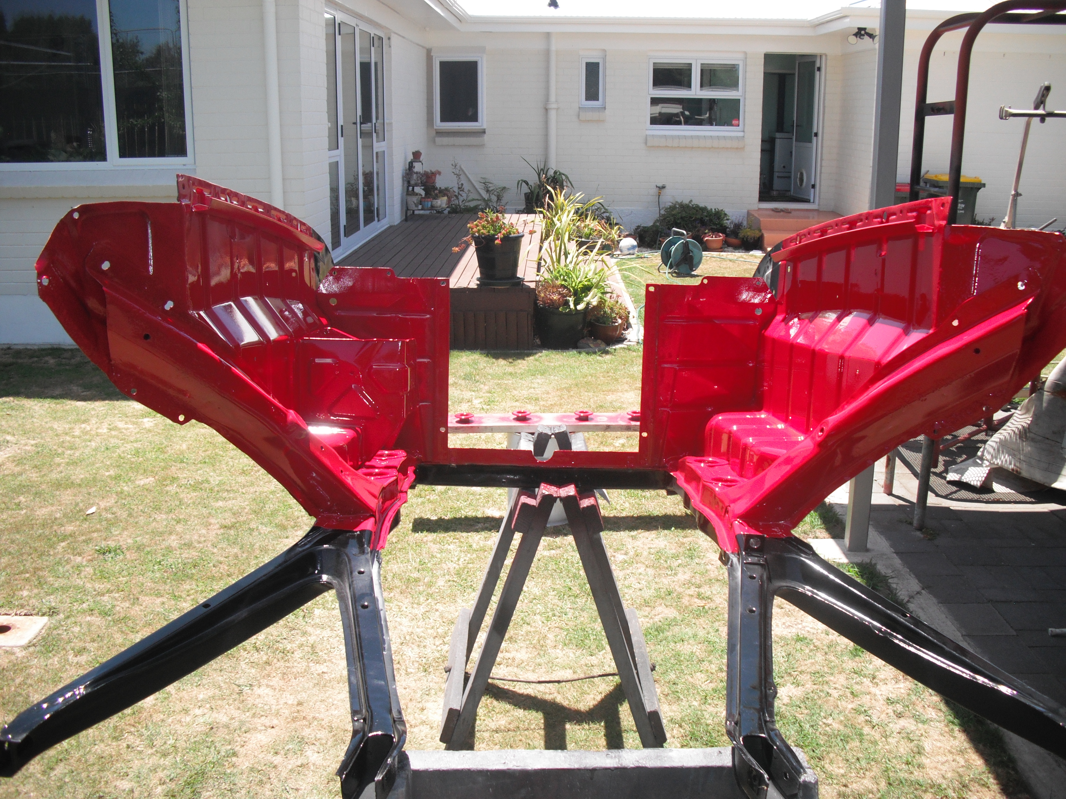

I de- nibbed the black on the underside and applied Raptor, which went on nicely. And also applied some colour to the inside of the subframe and Fire wall. I'm going with " Kia Tomato Red " with a Mercedeces off white for the roof. I thought long and hard about keeping with the original Cathay grey, but I have never owned a car with a colour I liked and once saw a red EK that blew my lights out as stunning, so red it is.

Nice work Daz, red will go faster than the grey 😊
That hoist holding the sub frame looks like a lifter used in aged care? They are usually good for 200 - 220 kg.

"That hoist holding the sub frame looks like a lifter used in aged care? They are usually good for 200 - 220 kg. "

I got that hoist from a Garage sale at a rest home. Very handy as it's not as cumbersome as an engine crane. My mate has lifted his "94 Road king with it. It also came with the sling that you put the person in for lifting.(But the missus isn't keen to try it out.)

Another update. I painted the firewall but was unsure where the subframe skirt wrapped around the firewall so will brush on some black later

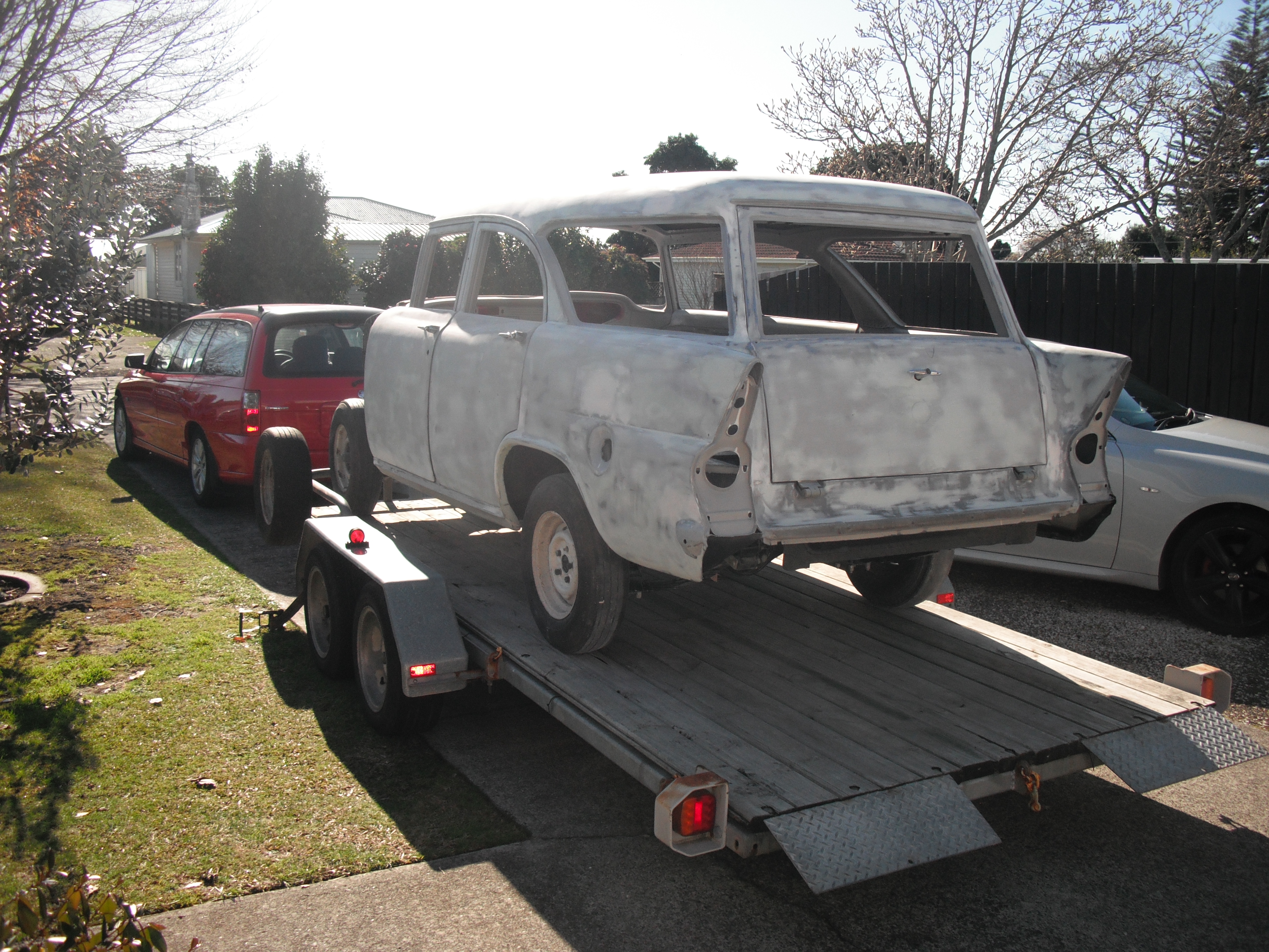

Hi All ,Long time no post.Lots have happened since this last post. Sent the body to a more experienced panel man who ironed out a few wrinkles

Sweet - are you going to paint it yourself ???

I will be doing the Primer/filler. My workmate over the road is a car painter with his own booth and said he wants to do the painting. Just bought another 4 litres of De Beer top coat and hardner yesterday ant the princely sum of $800.00.
Also got some chroming back during the week which was $700.00 worth.
