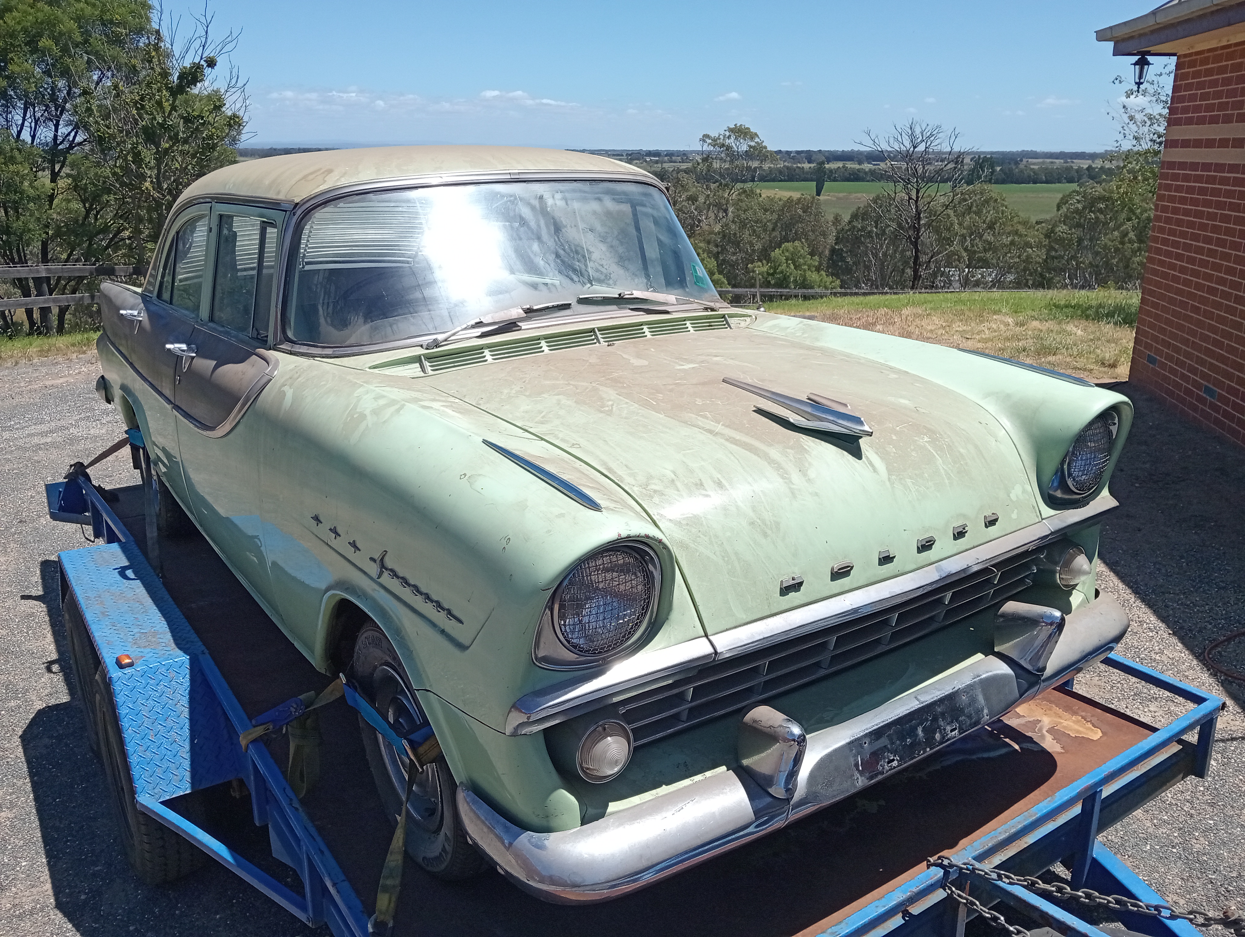

It's home now after 41 years. Sadly it's been let go over that time. I'm happy I have it but bloody annoyed too. Same air filter on it, I doubt it's even had an oil change. Radiator is blocked solid and so on.

Body and paint look pretty good Craig. A few days cleaning and fettling will cheer you up I hope.

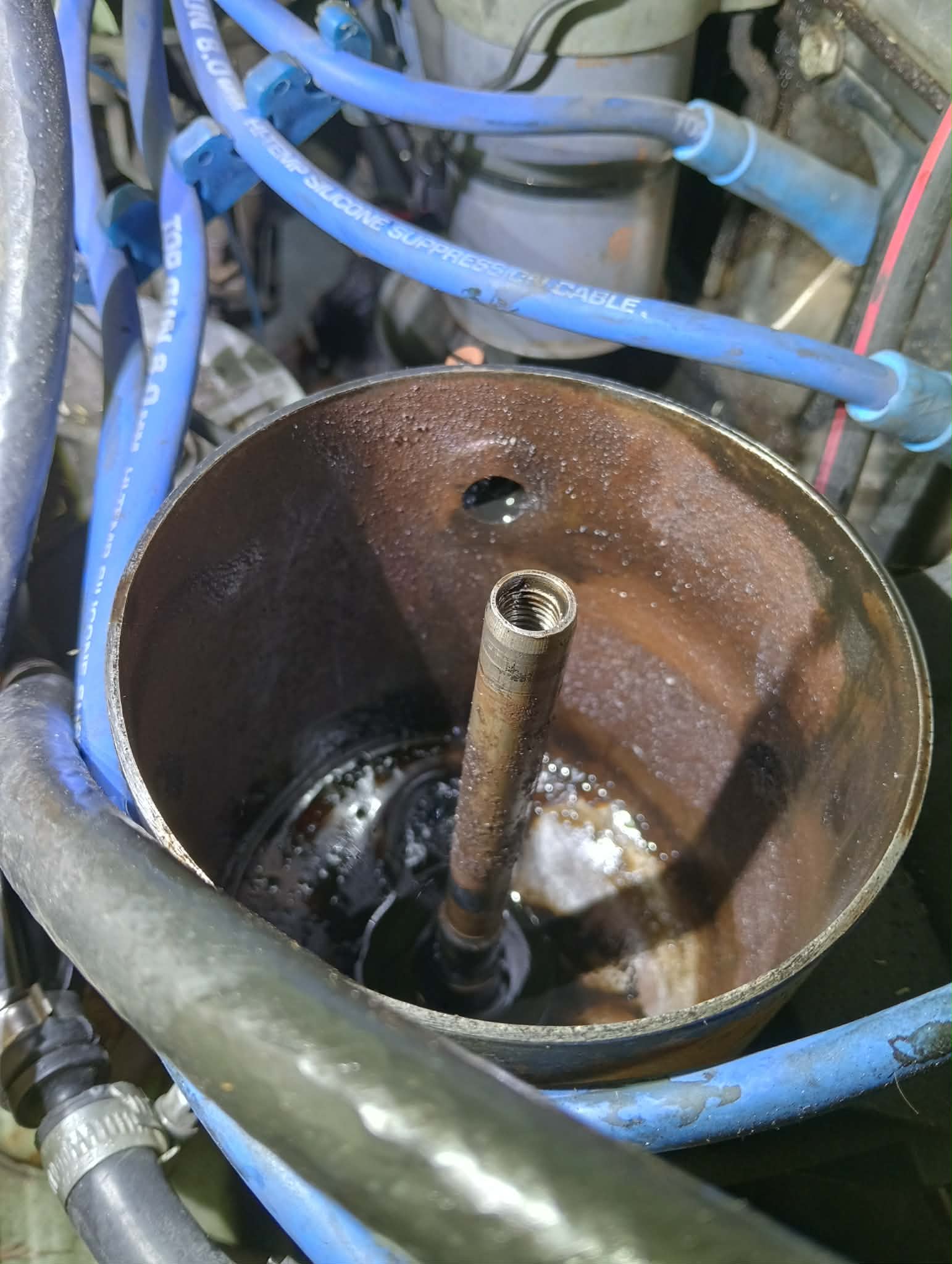

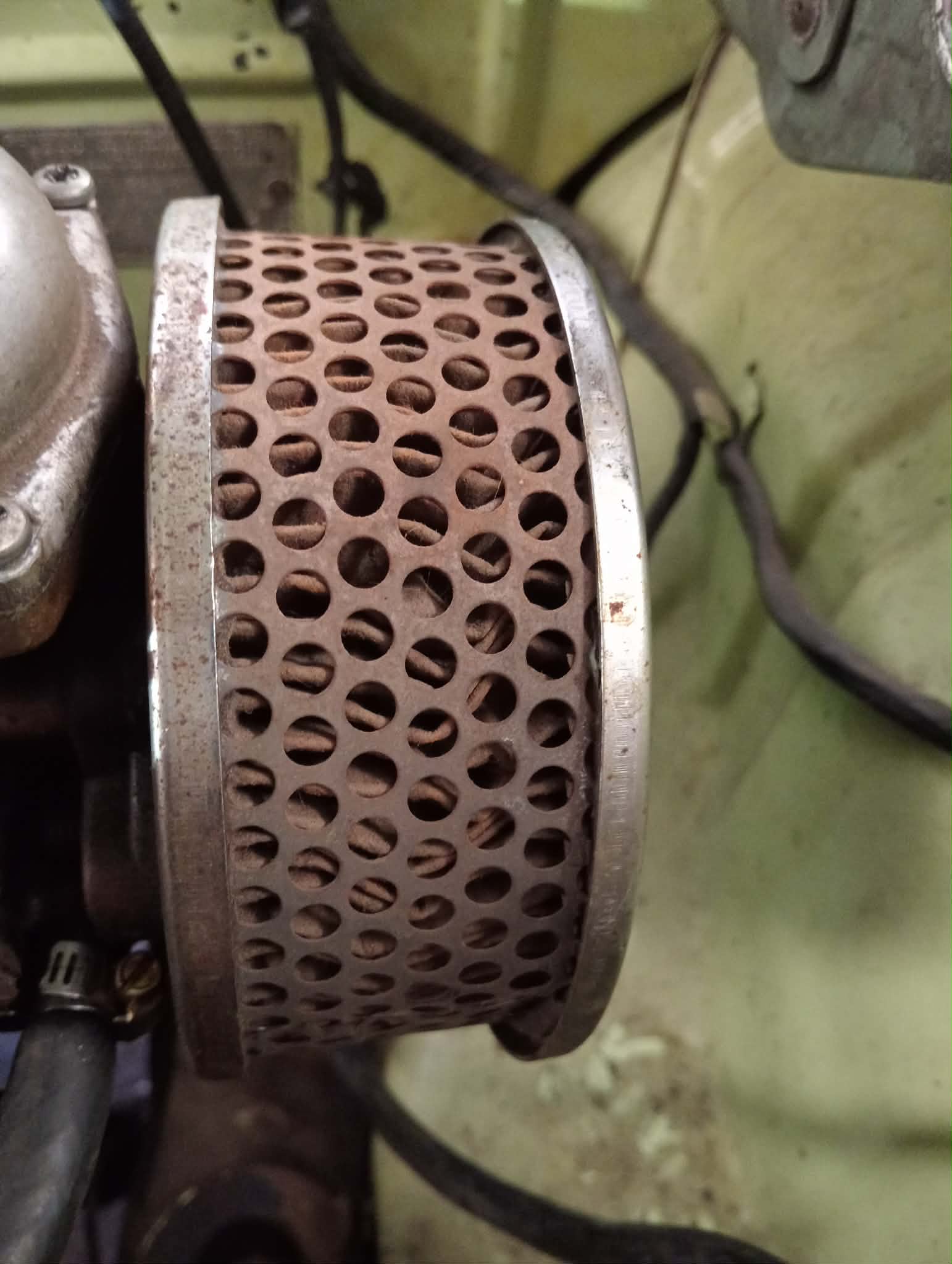

Well looks are deceiving. I'm somewhat disappointed, but not suprised. Sheer neglect is all I can see, plus a lot of rust.
Hasn't had a air filter change for 40 years. Oil filter is rusted internally, fuel system is badly varnished, and so on.

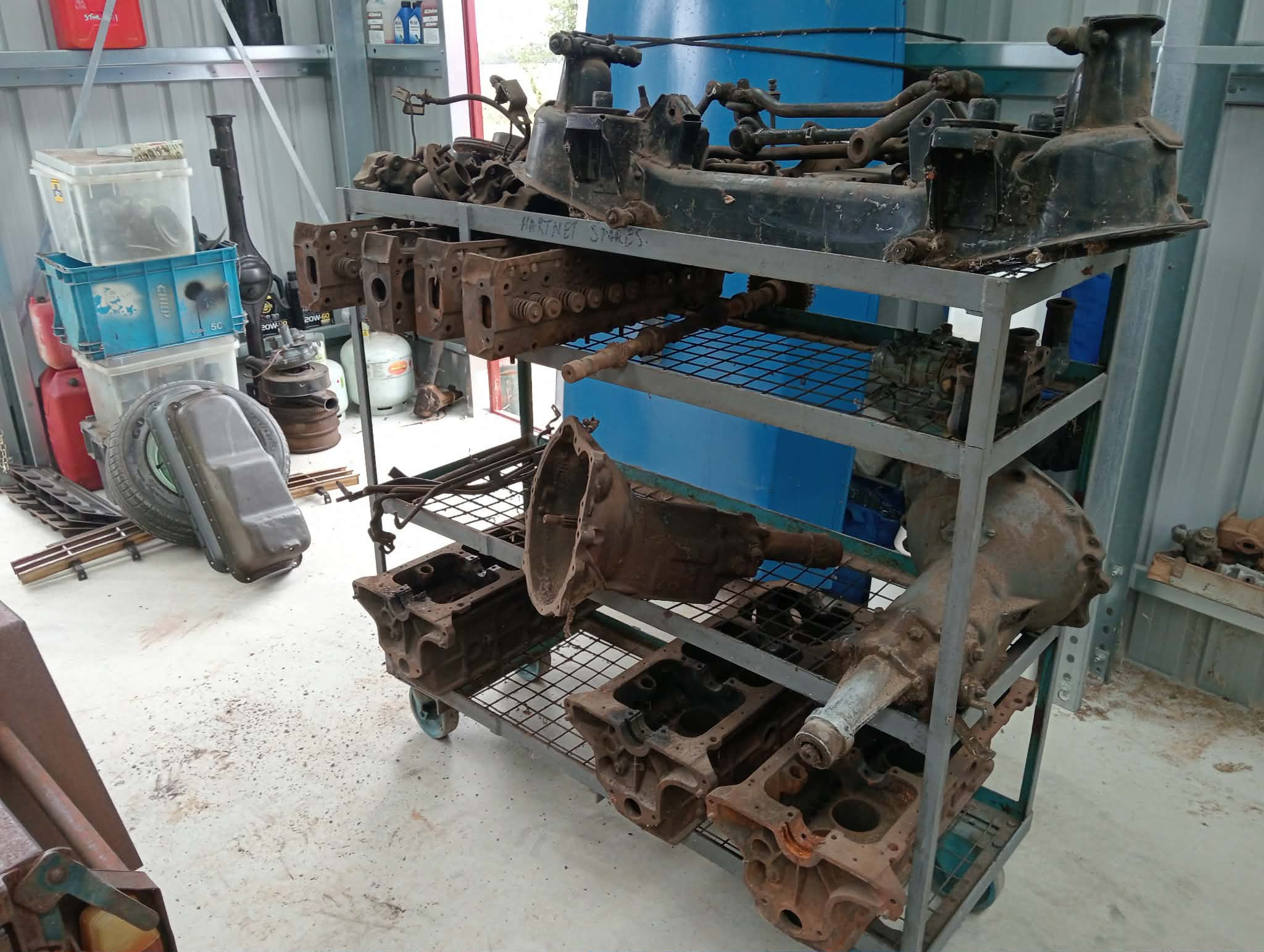

Great day today. Closed the circle on the car after picking up all the parts and documents. I'm so glad all the rego history has been kept.
I have lots to sort through though. Awesome find though, 1 x Army spec gearbox! There's so much to mention but I'll stop here.

OK - I gotta ask, what is an Army gearbox? Never heard of one ?? I assume if it was an Italian army gearbox it would have 3 reverse gears and one forward??? 🤣🤣

My guess, FWIW, is that it is an early box that got the double-row bearing upgrade.

FX-FJ gearboxes have the extra ribs on the bellhousing. The one in the photo is a late FX/early FJ gearbox: 14th day of can't make out the month 1953, with an alloy rear extension housing, which is consistent with a 1953 build.
