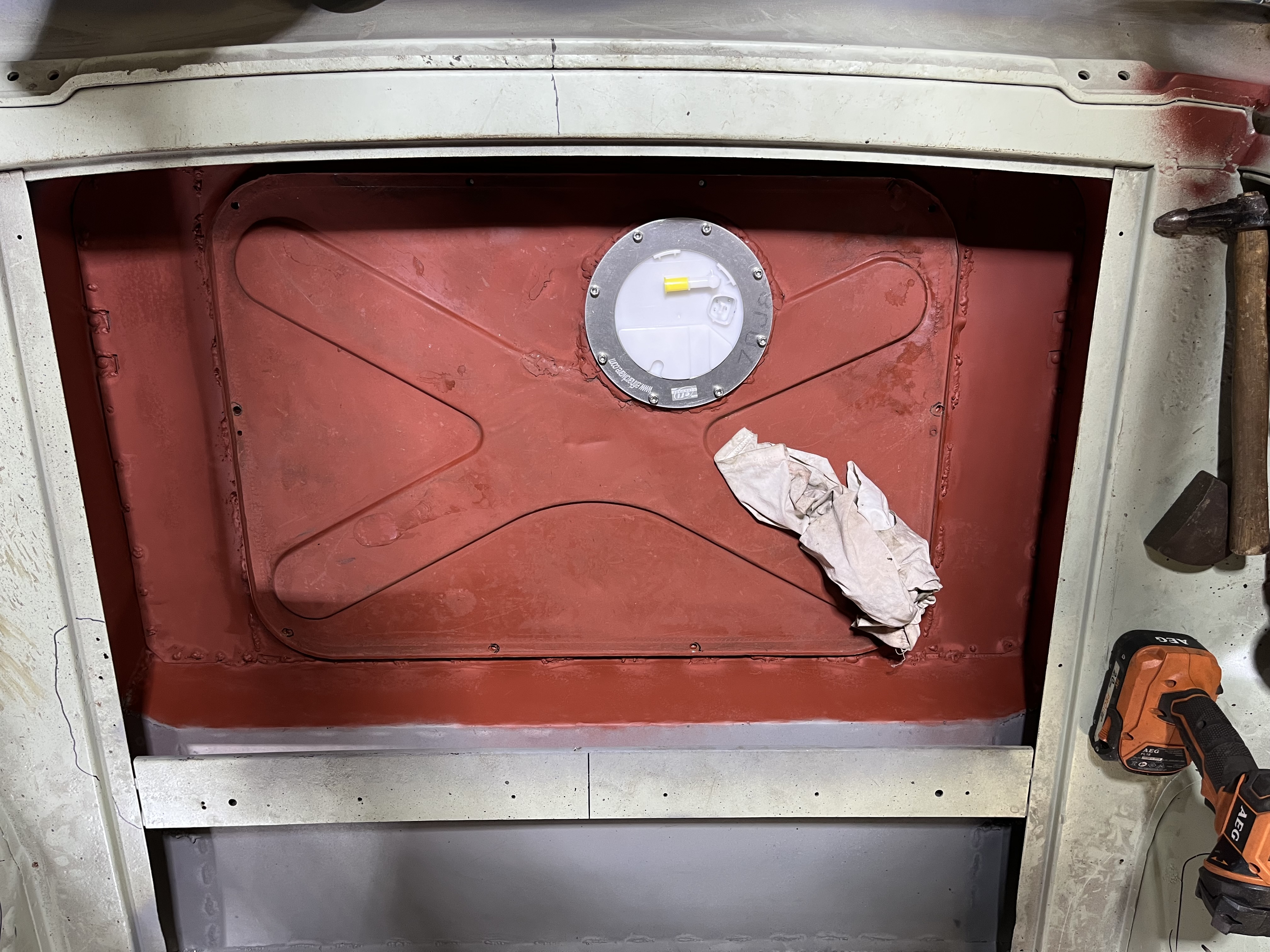

Pretty happy where this has ended up, went and stitch welded the the tank surround every 2” (advise from Keith 😜) still need to seam seal but that’s everywhere and have to do the filler neck.
Still a couple of smaller rust repairs to do 🤔😫

Yeah guys I'm going to use a hose joiner but probably need to extend the neck on the tank and direct it towards the hole through the body in the wagon that goes up to the rear quarter.
Cleaned the outside of the tank and gave it a coat of primer

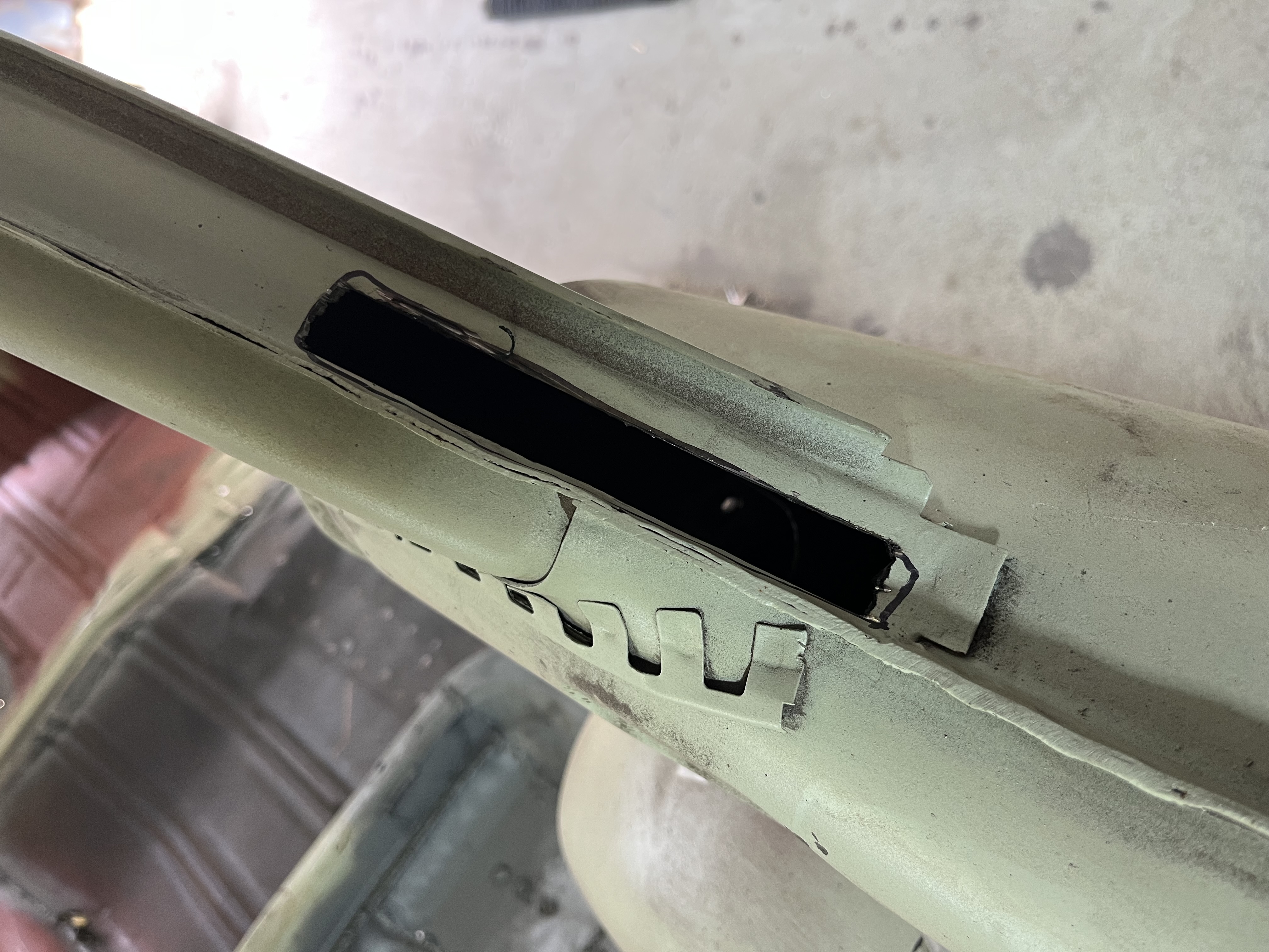

Tackled a repair on the driver side C pillar
