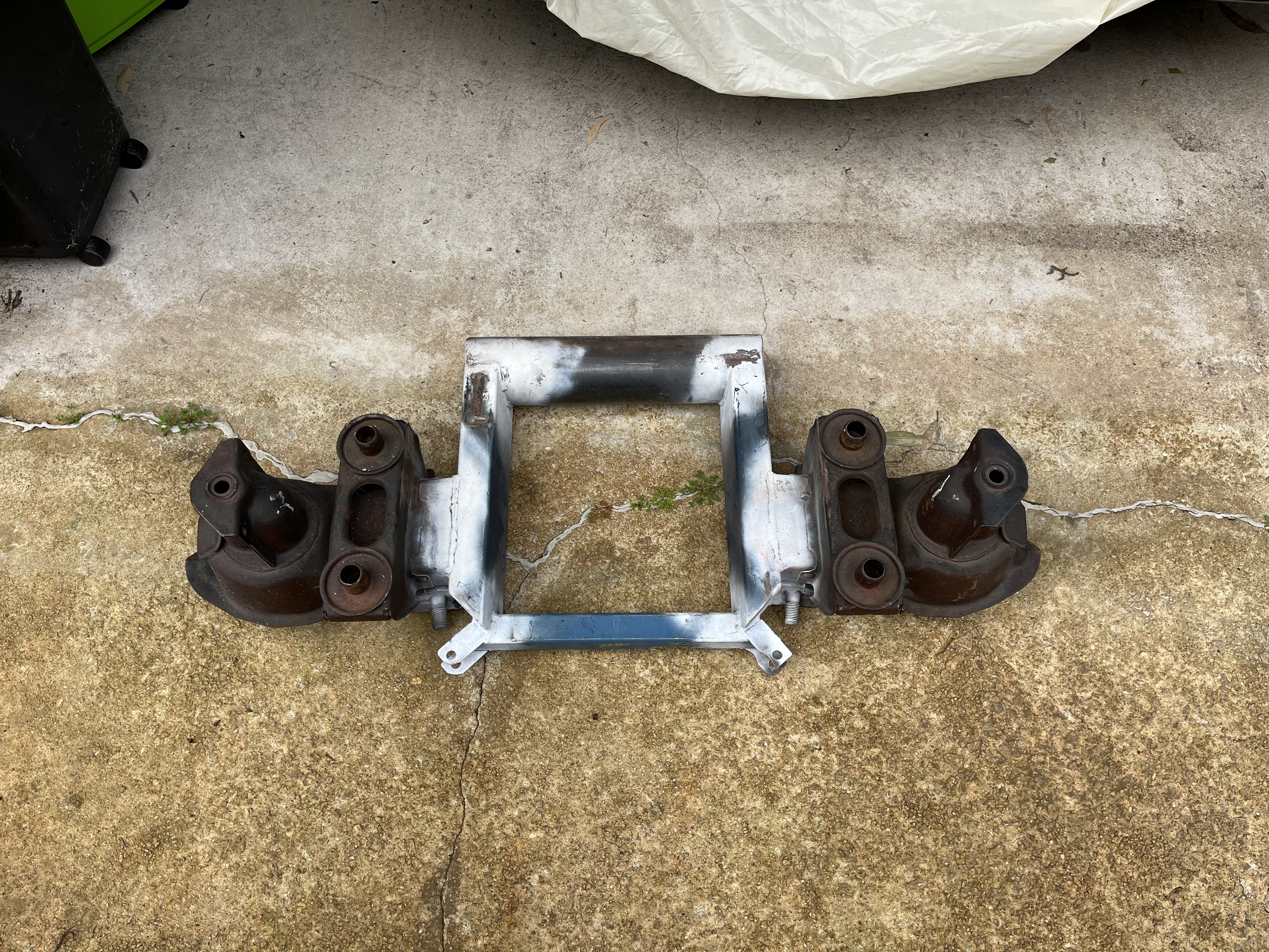

I'm going to use the HR front end that I have cause I've paid $1500+$475 for MPI to certify the welds from Albert.
I know it looks a little agricultural but it allows me o use the original sump and retain the original sump capacity instead of losing capacity with the V6 conversion sump, it will also work if I change my mind to a 5 Lt.
I have to put engine mounts and a modified (shortened) outrigger.

Before it goes in you can lower the top wishbone mounting points, will improve your camber, can also buy Camaro top ball joints that will help in that regard.

GMH did this on the UC Toranas. It also improves dynamic camber under cornering suspension squat. Another option here is to fit a taller top balljoint, although I suppose it could lead to clearance issues to the rim. There is a moog brand balljoint available from the US for this application. Shorter springs have a similar effect.

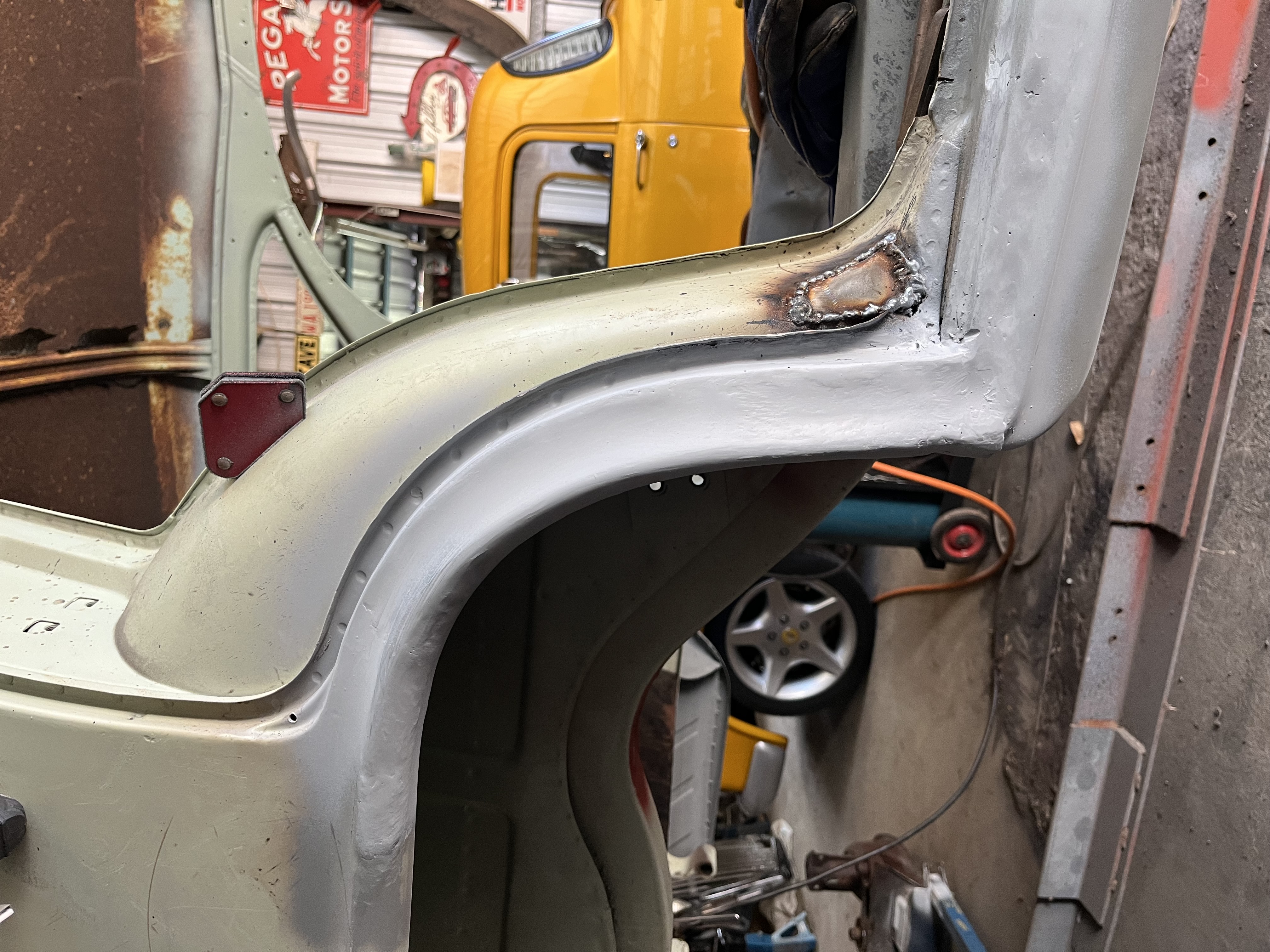

Now I don't want to hear the word "Dog Leg" said again for a long time :roll: I've been fighting with the driver side one for a while now, it doesn't look pretty and still needs a little work but at least it is basically finished, have one more patch as you can see to dress up and another small repair on the inside of the wheel well and this side finished.

You aren’t “pussy footing” are you mate?! Nice work.
