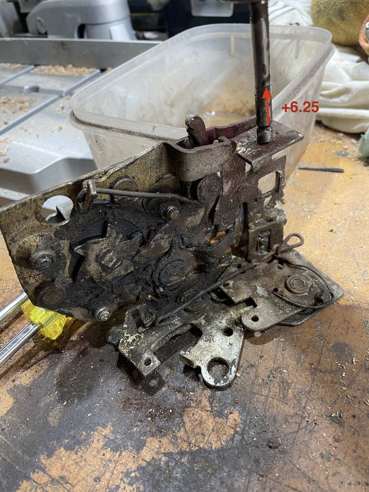

Spent the morning looking for an internal rear view mirror. This slowly drifted off and I ended up searching for exterior door handles, which I either need to get re chromed or replace. Checking the current price on Resto Country, and discovered that they are currently selling REAR door handle pairs at 33% off (168.50), but FRONTS are still around $250. So out to the shed to work out what the difference is between front and rear.
Grabbed the front and rear RH handles. Same part number.
Layed out the 2 different length buttons from the front and rear. One is 6.25mm shorter than the other. Had all 4 in the same container, and labeled one passenger, not front/back so not 100% sure which is front or back. Got the rear door out of storage and grabbed a lock, confirming that front and rear locks are the same part numbers. Attached the lock and measured the depth from the exterior to where the shaft presses against the lock 'paddle'. Was about to grab a front door down and measure it when I had the craziest of ideas.
Check the workshop manual. Nice one idiot!

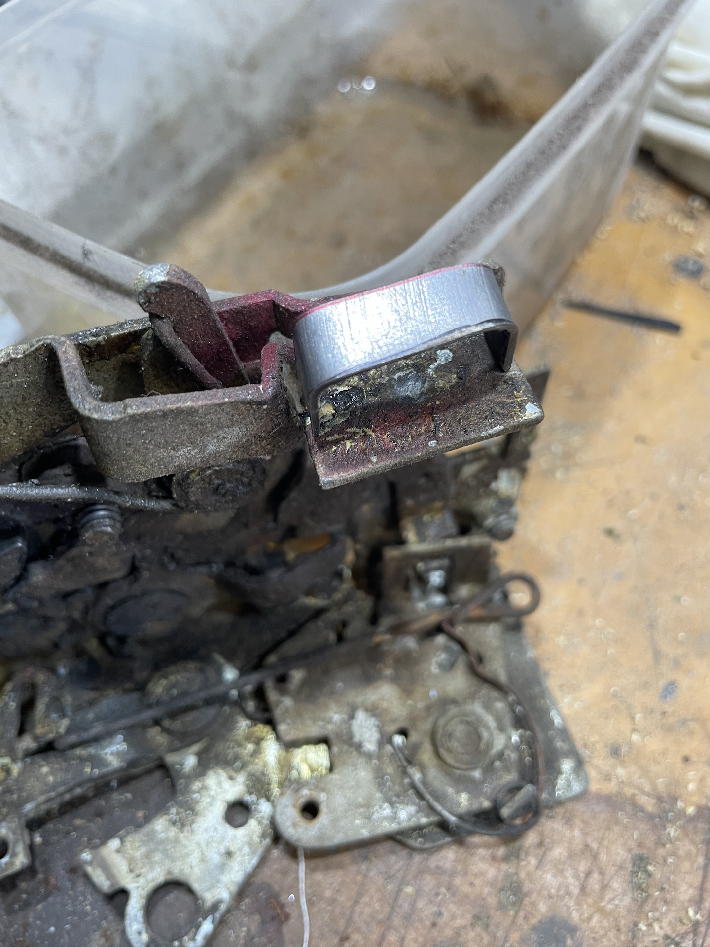

Anyways this has confirmed that to mod a rear exterior handle to a front handle, I could either....
A: extend the shaft by 6.25mm or B: add 6.25mm to the 'paddle' as roughly mocked up here. With my limited tools I will most likely go with B. Unless someone has an option C that is not "stop being a tight arse and pay the extra $80 for a combined 1/2in of steel rod"
Extra bonus, ebay has a $15 discount if you spend over $150 so 4 handles and a bit of additional required effort for $322. I guess I will know soon enough if this was a good idea.
Scott
Re: Ol' Rusty - FB/EK Sedan
Love your lateral thinking Scotty. Yes, the pin length is the only difference. Maybe a front knob could be used from a manky front handle, in a good rear handle?
