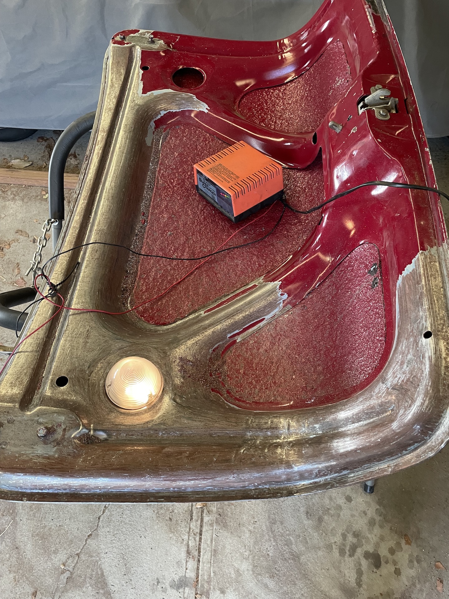

Before After Flipped it over and got distracted by the holes in the bracing. Boot lights! Well I am not someone who would waste a perfectly good $50 lens on a boot lid light, instead I think I have wasted a good few days modelling and 3D printing my own.
Version 1 It's a start, not sure if I like it, and while I mulled over it I stripped and cleaned up the inside of the boot. No big hidden rusty surprises here.

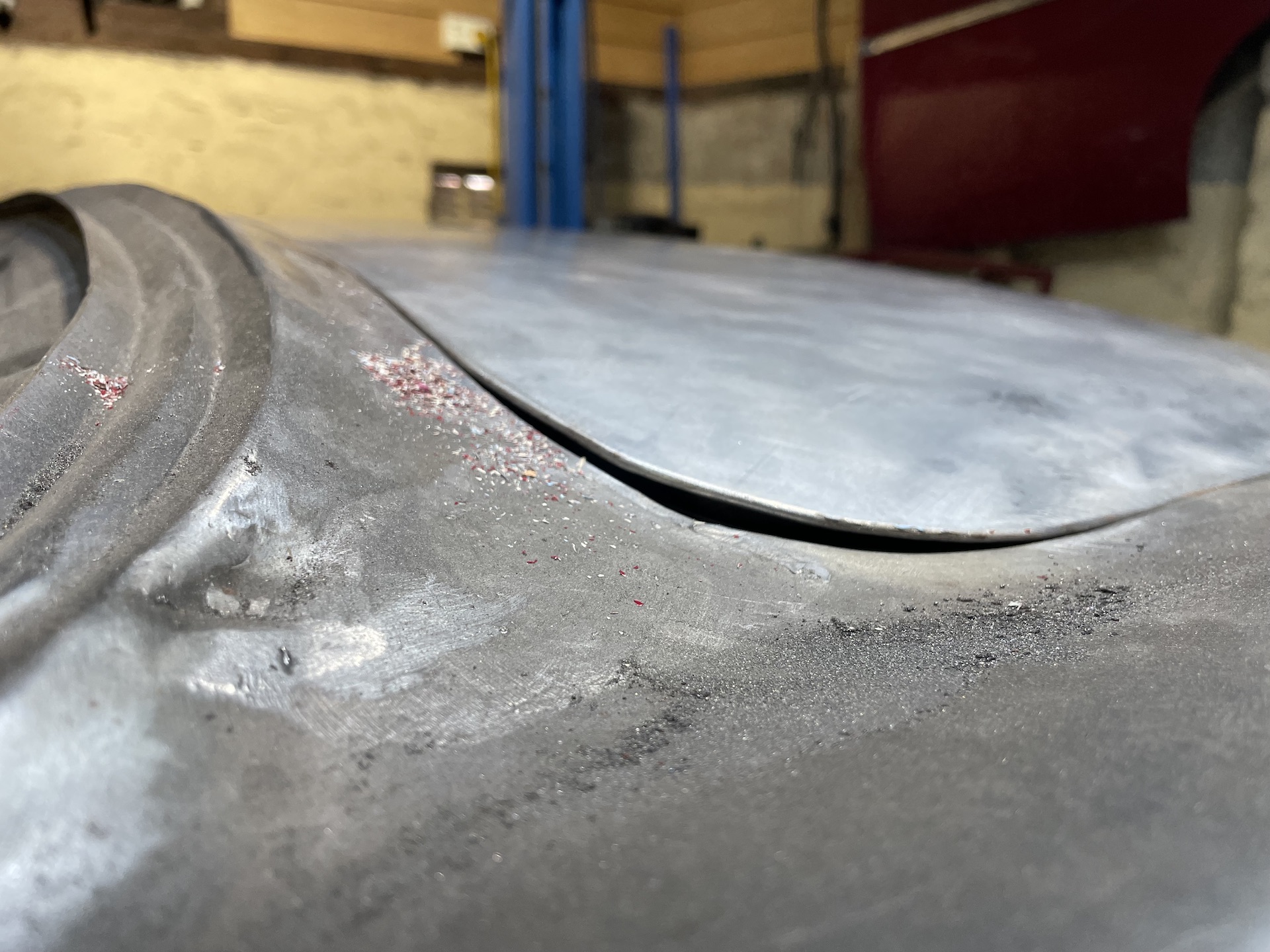

Fit the boot, recheck gaps etc.
Tried to get the best fit I can shimming as per the instructions in the shop manual. This is it!?
Really not happy with these. Seems like a lot of filler will be needed to get this to flow a little better.

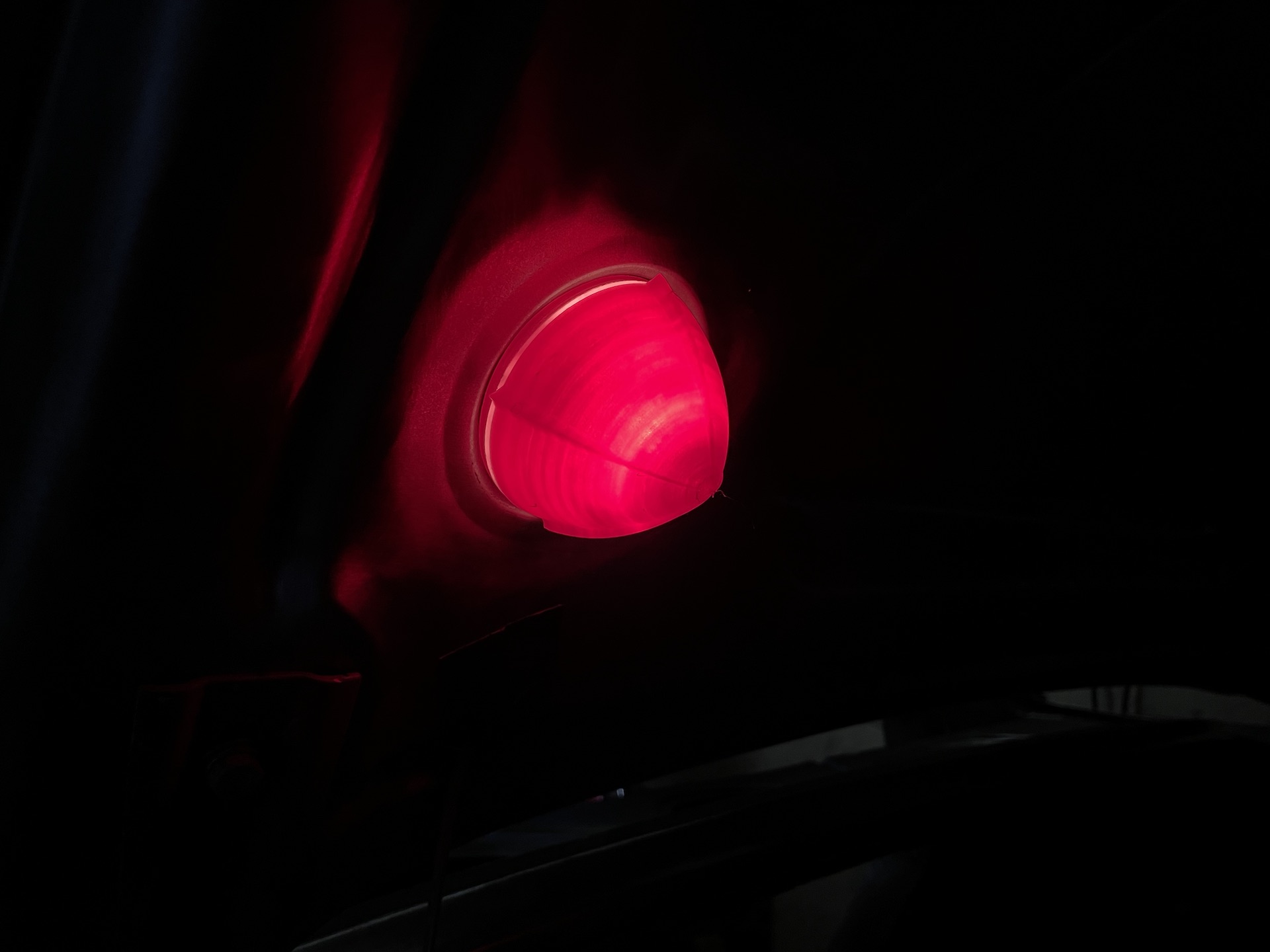

Then back from holidays, still no decision with the bad boot lid, so I distracted myself with version 2 of the boot lid lights.
This one has a better profile and I printed up a mounting plate. The lens twist on.
Then I added a clip on safety red warning cap thingy that stops you getting blinded by the light. Might try this colour coded to the car down the track. Then a full red one with 4 ribs. Impossible to get a good finish with this due to the shape. What was I doing again.......

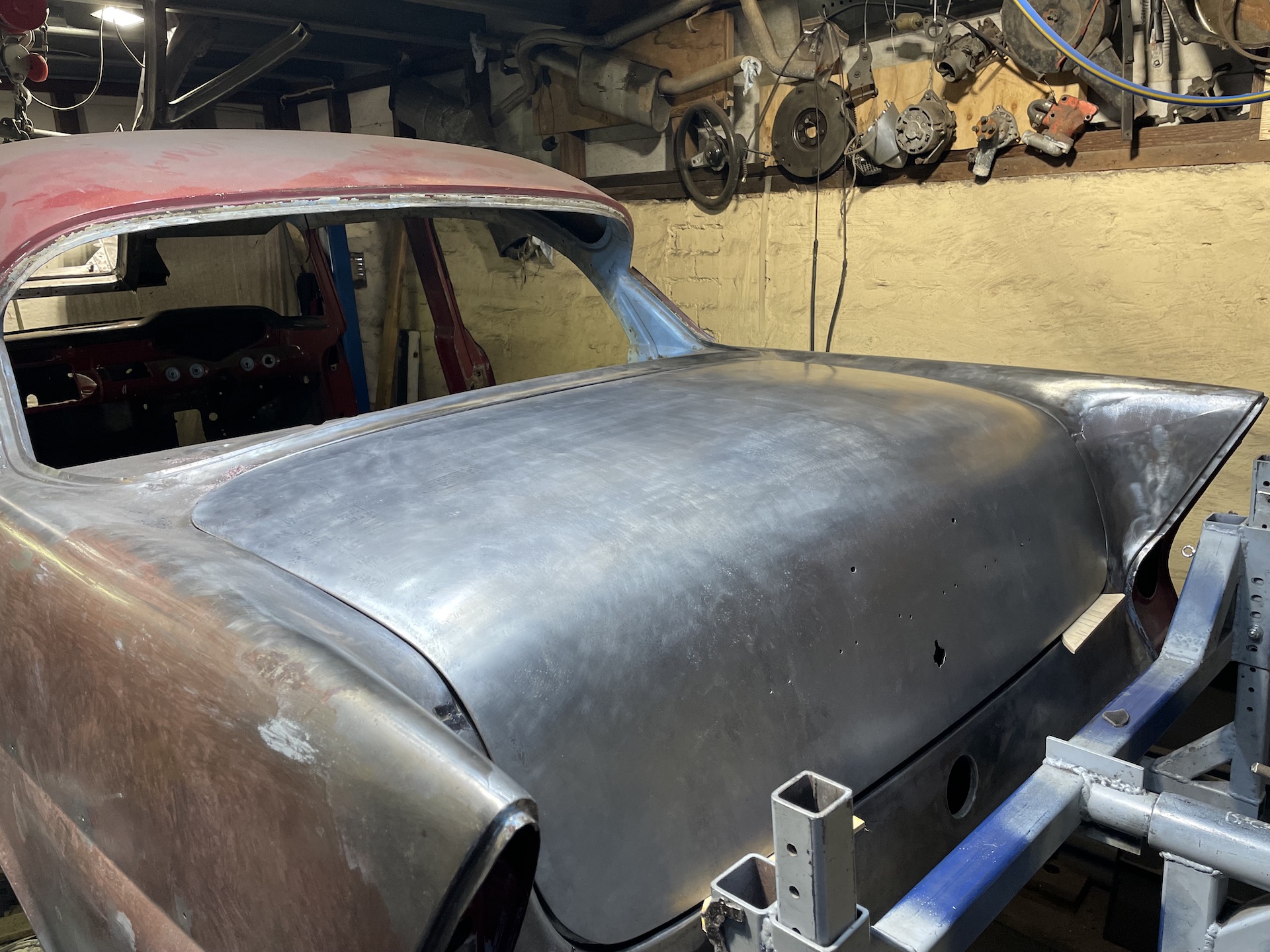

Oh yeah trying to decide if I really want to cut out and raise the body to match the boot.
So after much forming and shaping and general hitting and twisting later I managed to get these. And on the drivers side.. They are ok. There is a lot of work that I need to do around the rear window on the drivers side rust wise, so I might tackle that first.
I have also thought about taking a BFH to the lip of the boot but it looks correct as is. Or I could just fill it in with body filler.
What I need to do is make a decision. So I'll go and remove some body deadener off the front guards and think about it.
Or try to repaint cars with AI
Scott
Re: Ol' Rusty - FB/EK Sedan
Scott,
Take to the lip of the boot with Mister Hit. It shouldn't (famous last words) take too much effort.
If it were me I would have a go at bending or shimming the boot to hinge mounting surface so the hinge is swinging further in the shut direction, bringing the lip lower. Possibly you've considered this already.
