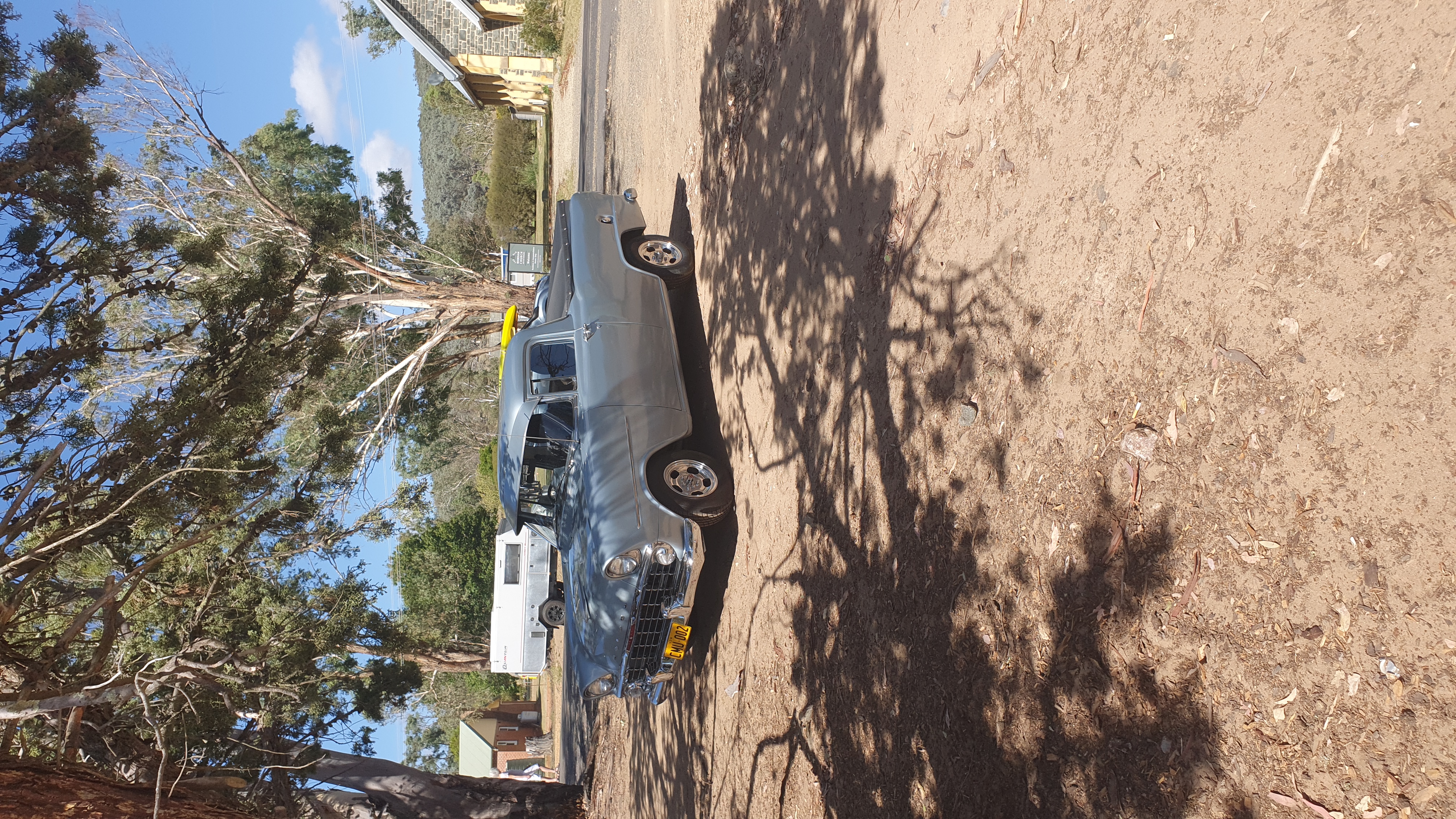

Trip to Gundagai and back today to get my certification paperwork updated by the engineer to reflect change to Celica 5 speed.
Stopped at (very unsettlingly named) Bookham for a rest. Ute kept up with the best of them on the Hume.
Bookham

Looks very tidy Brett :thumbsup: Can you remind me what size rims you have 13” or 14” and the width? Also the tyre size please. Just curious as I am still fiddling with my jelly bean mags. Two of them won’t hold air :roll: :roll:
Posts: 2410
Re: Project 2.
Hi Stephen.
6 inch wheel width and 13 inch diameter. Tyres are 185 80 13's. No idea what the offset is, but it works😀
I have tubes in mine as they all leaked air too.

Barney is looking great Brett
Posts: 2410
Re: Project 2.
Thanks Neil. He is going nicely as well. Engineer and I chewed over the Prius power steering upgrade. He came up with an interesting option that I would never have thought possible. And then made me promise not to tell. 😀
