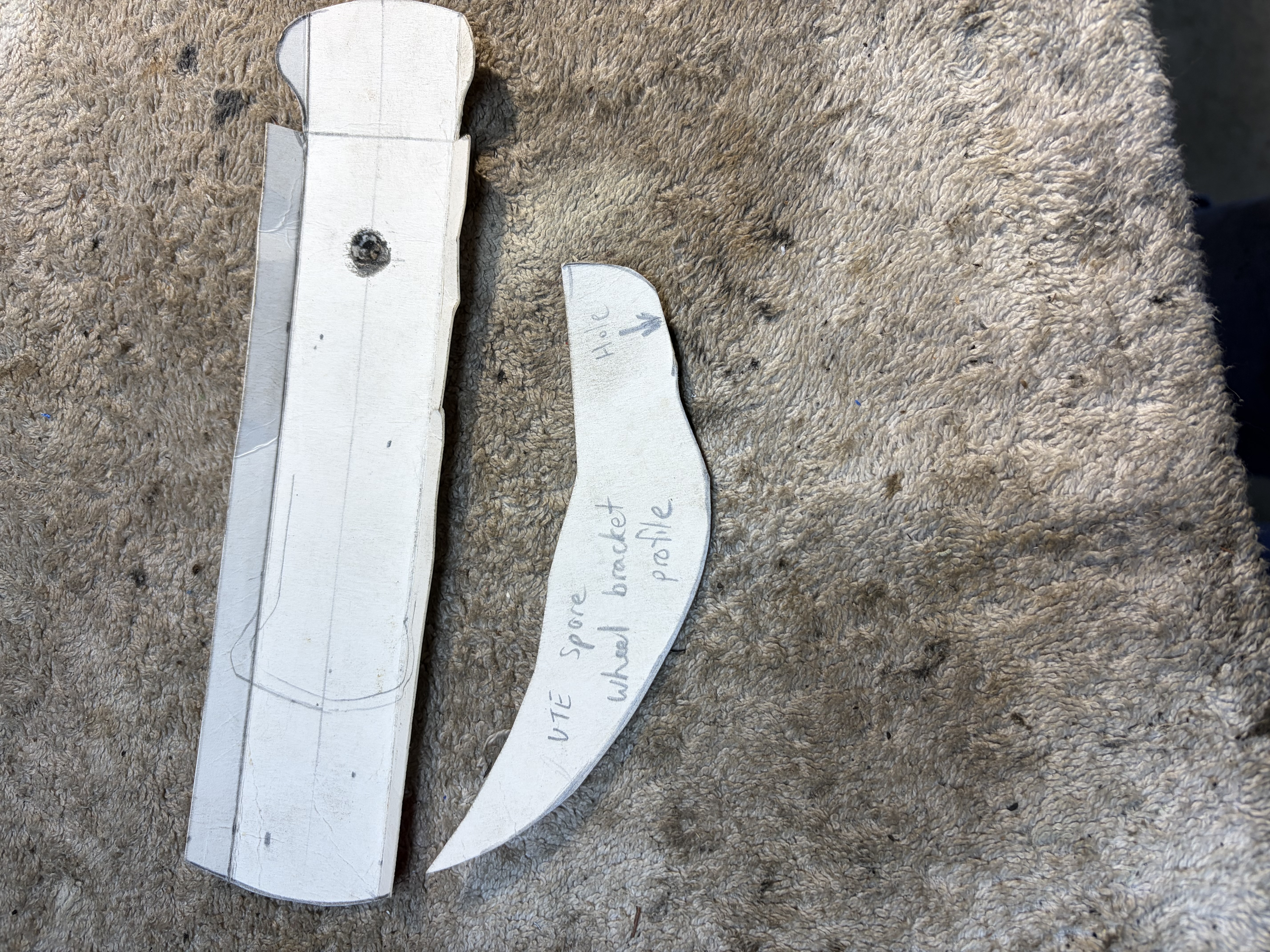

Made up a cardboard template as below.

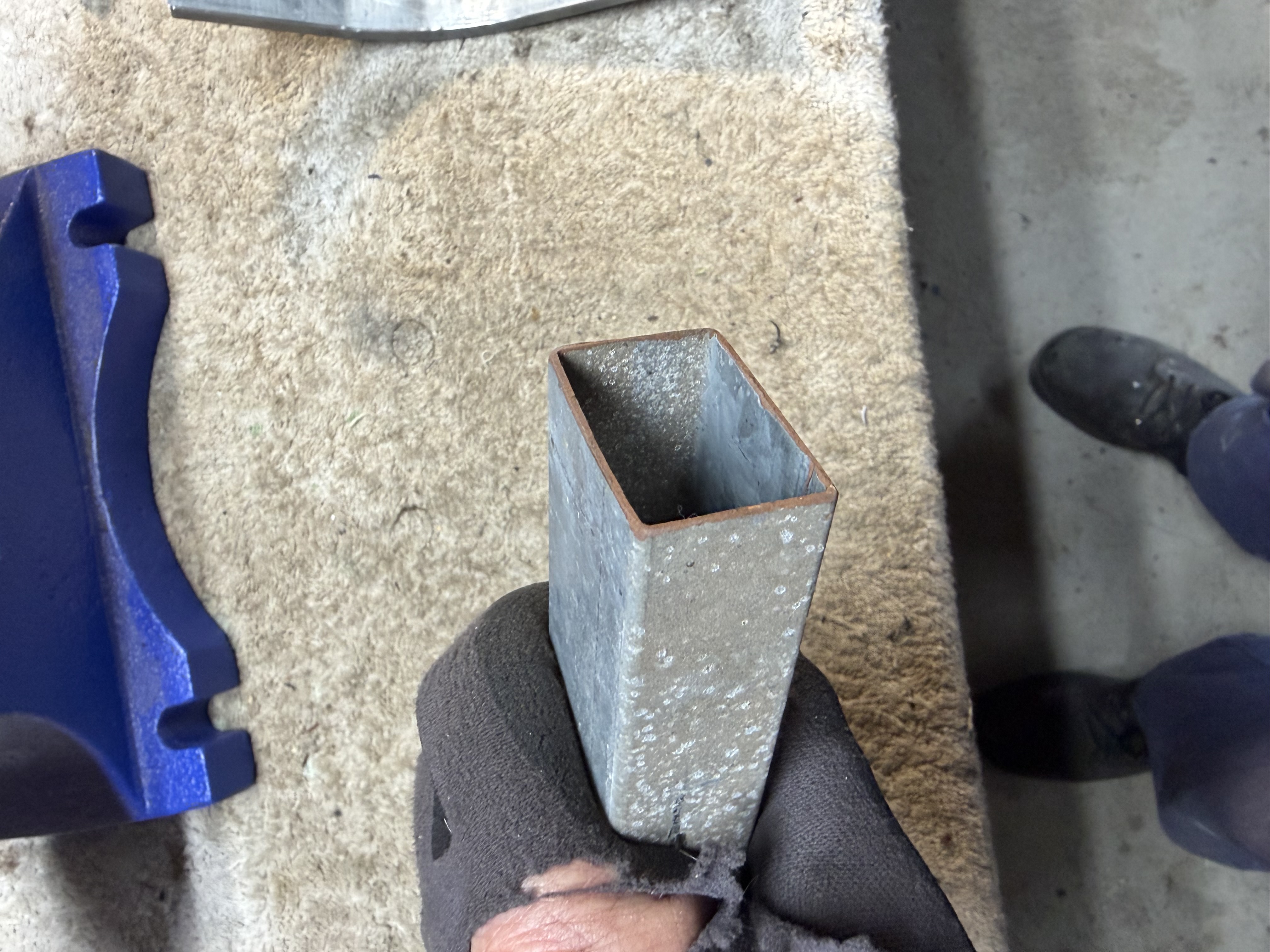

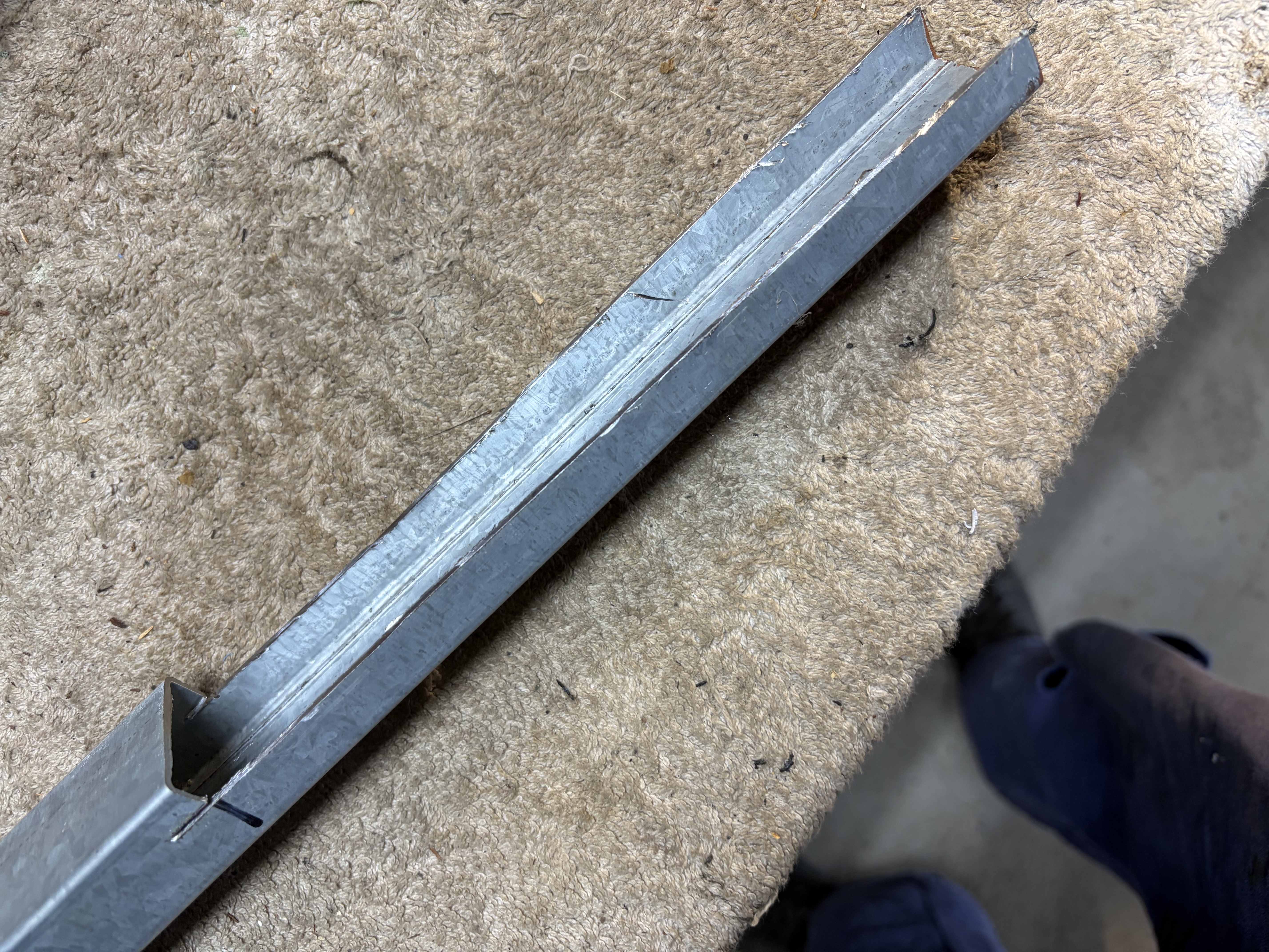

Cut a piece of RHS steel (fence rail) 38mm x 25mm. My piece is 1.2mm, ideally a piece in the same dimension but 1.6mm would probably be better.

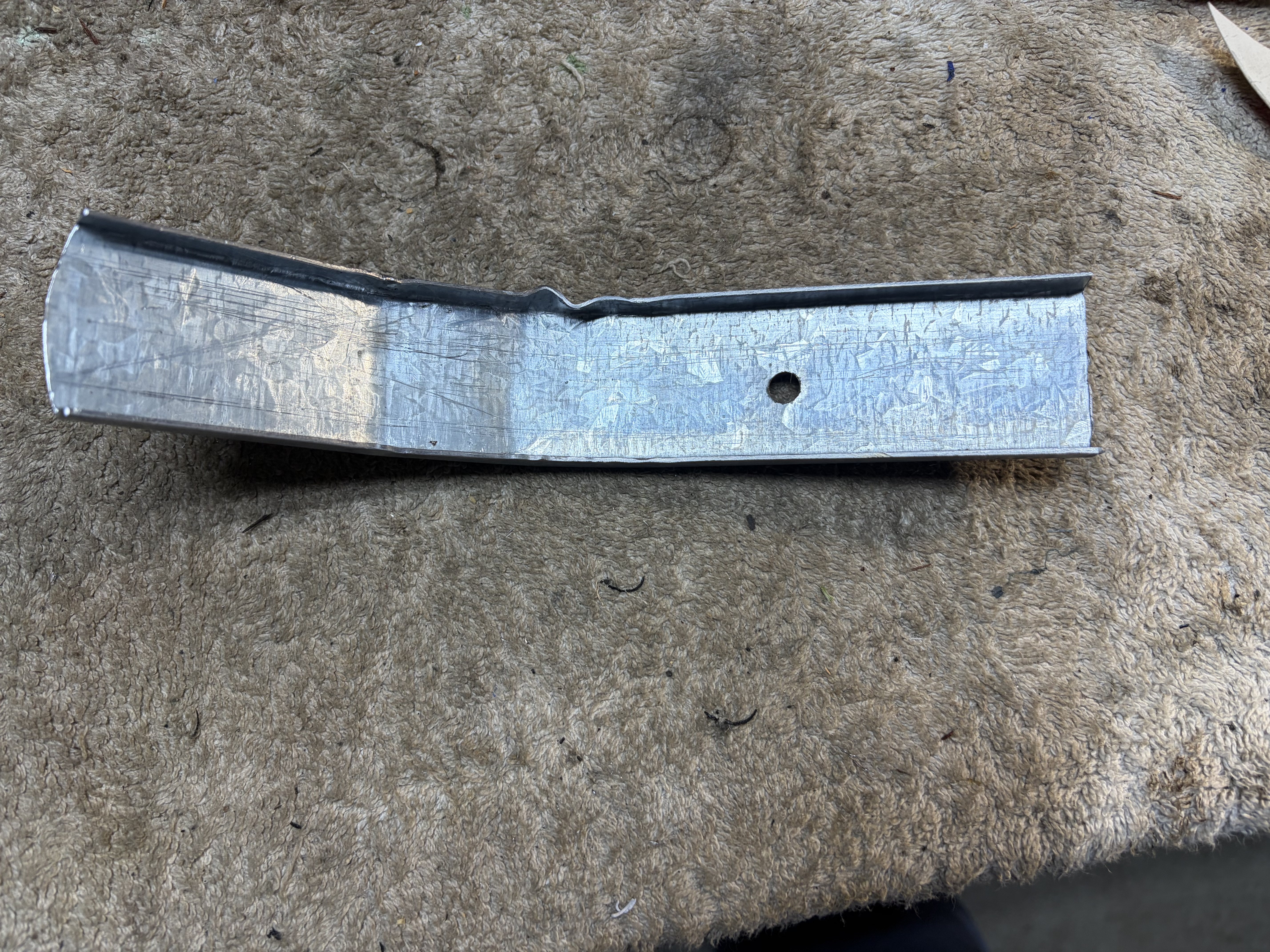

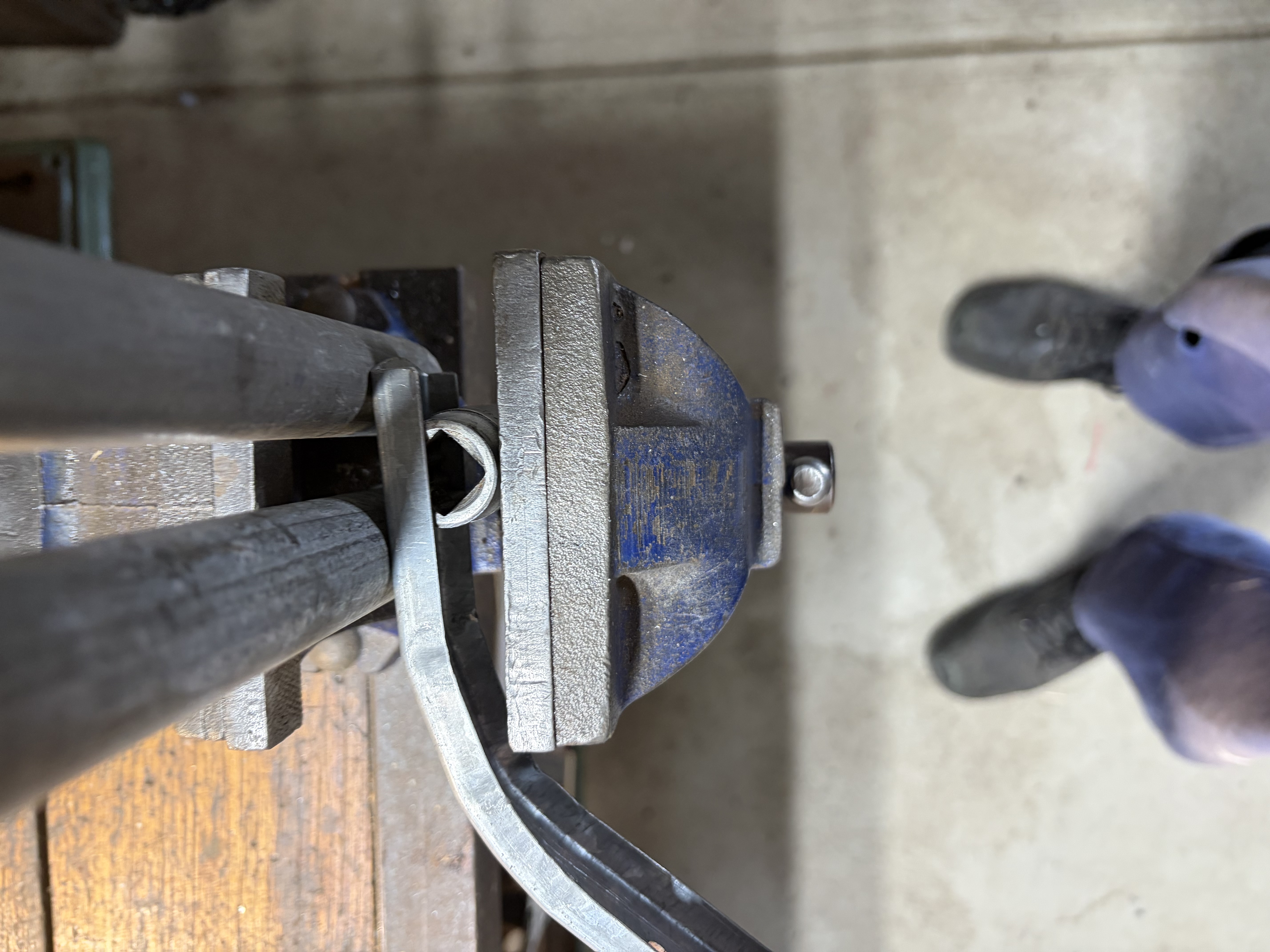

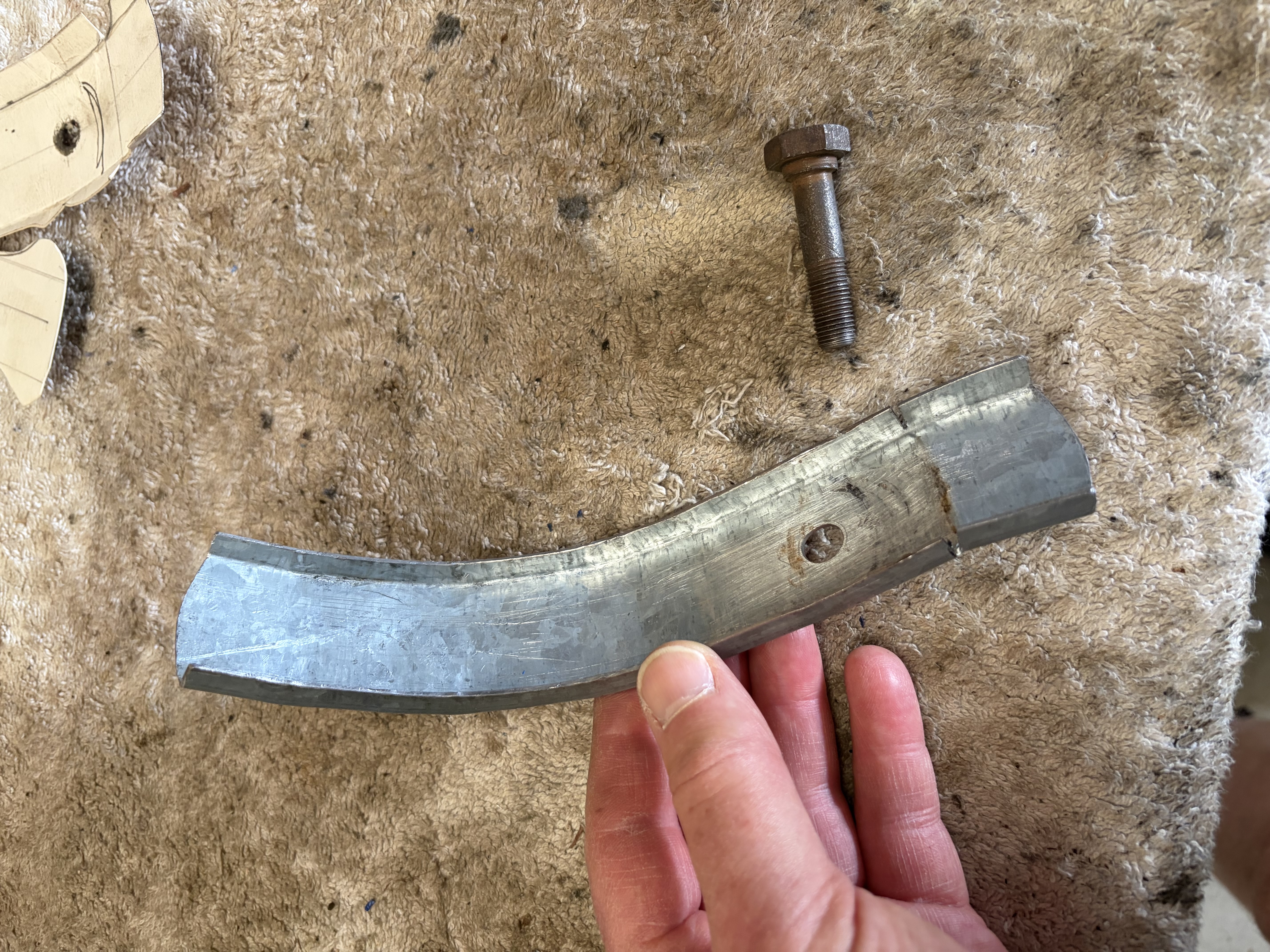

Drilled a hole and finished the ends, then had a go at bending the piece into a curve using the vice. A hydraulic press would be better but I don’t have one. Used some pipe and a socket.

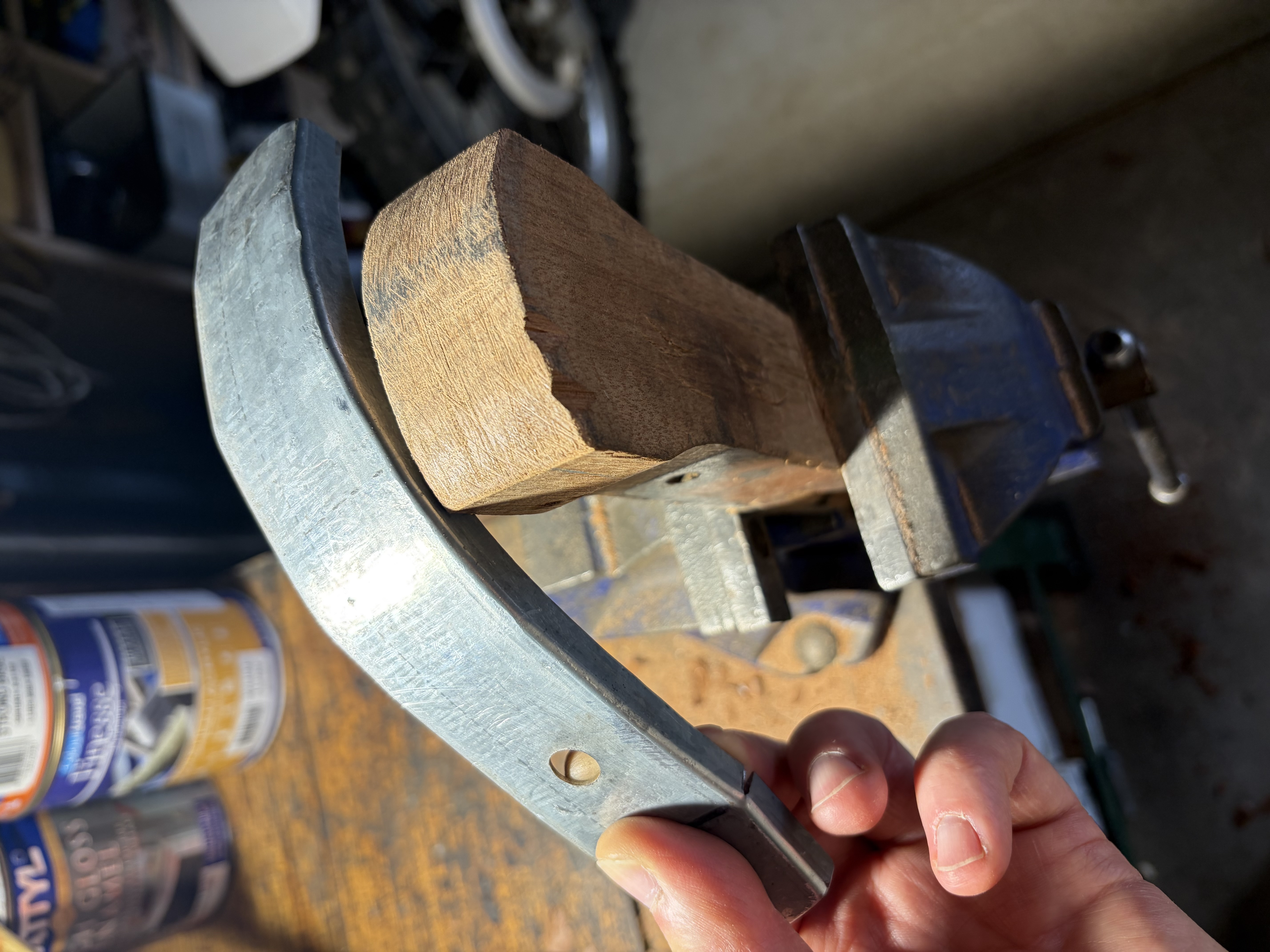

The steel had a bit of a lobster back so use a formed block of timber to try and smooth the curve out, with some success. Used the anvil to flatten the side pieces.

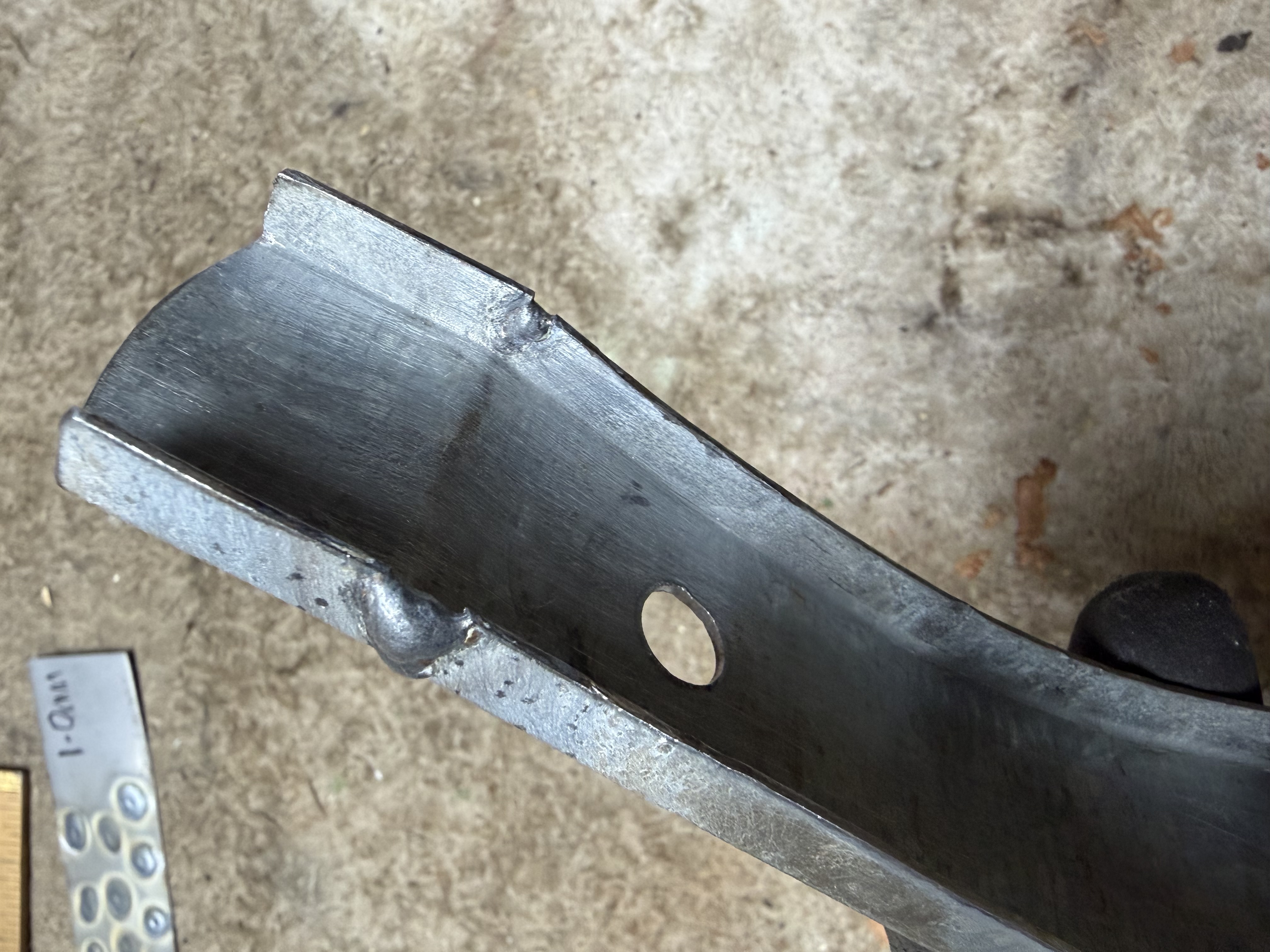

Made up a retaining bolt with a crush tube & spacers as well as tacking the side pieces where I had made a relief cut. Threw some paint on it and it looks like this.
