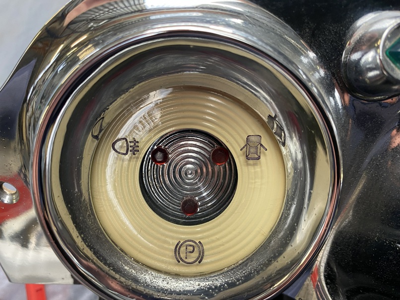

Now iI need some help wiring up the handbrake warning light. Yes
i can tie my own shoelaces but electrical wiring requires wizard grade thinking. :oops:
I'm using a HQ style handbrake which has single wire.
The warning light will been one of the idiot lights but update engraving,( P )
LH Gauge.jpg (210.28 KiB) Viewed 116 times

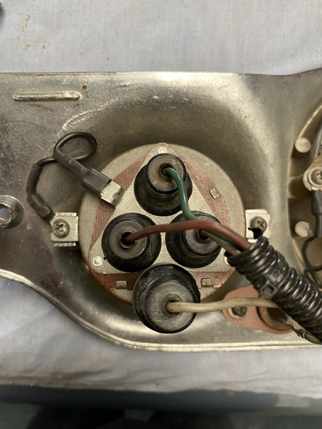

I bench tested the power to globe suggested setup but the idiot light are grounded via to gauge cluster.
idiot light earth.jpg (96.43 KiB) Viewed 28 times
I would need to insulate the globe holder then run a wire to the handbrake switch.
Does this sound correct ?
Posts: 2538
Re: Ammo's Ute
That mounting plate is usually +ve from ignition switch, not grounded. Normally wired to ignition on and bulb wires go to ground through temp, oil switch and gen. If you changed what you ha ve back to standard, your handbrake switch and light would work as they were designed.

Post by Wrongway Roger »
Brett, that makes so much sense. I thought I was being clever grounding each gauge cluster.
There are several gauge clusters in the shed but all the gauges have been removed so I check the crusty wagon, not that I should have doubted you.
Tomorrow I will grab an ignition wire to power up the gauges if my back holds out. I'm too big to be bending over or putting my boof head under the dash.
