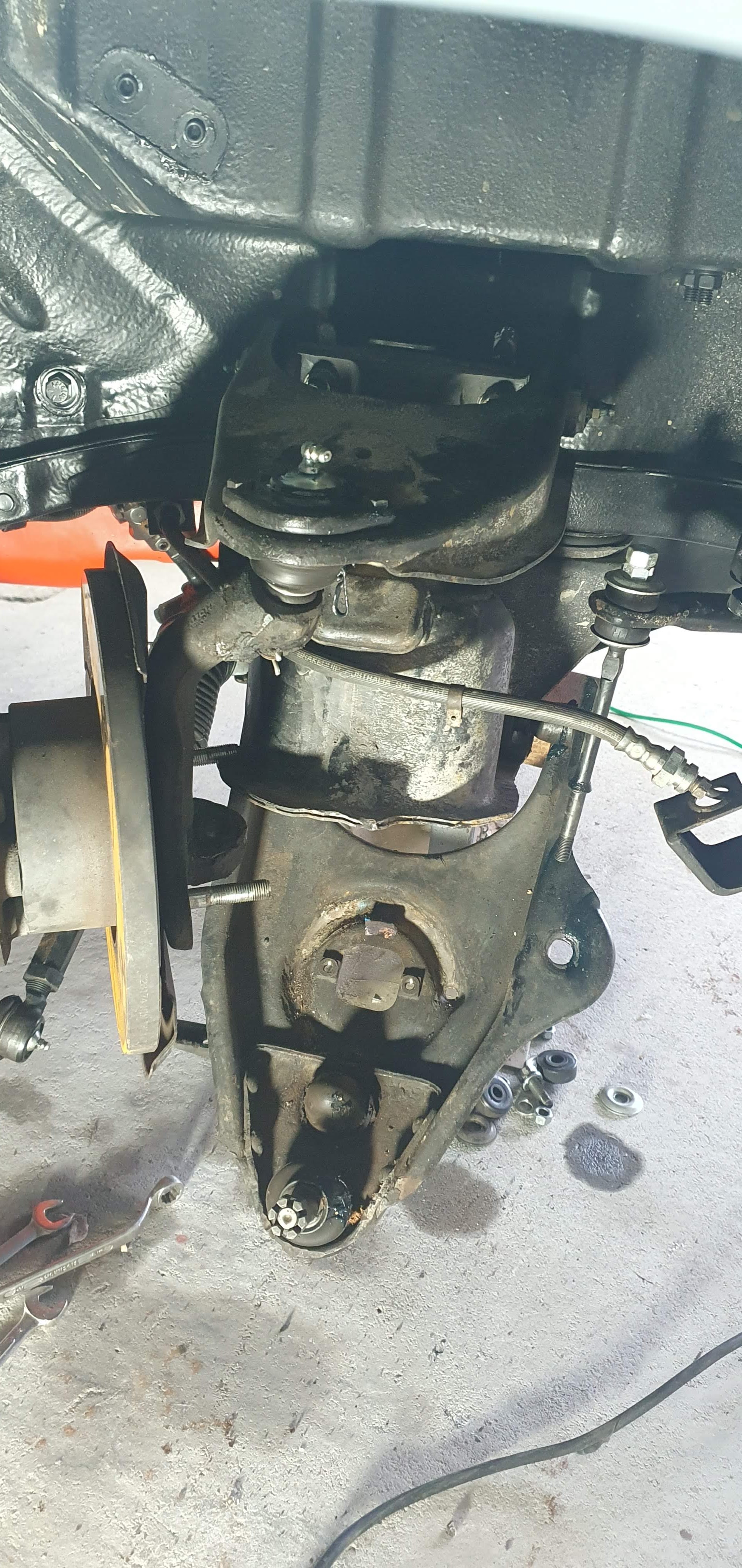

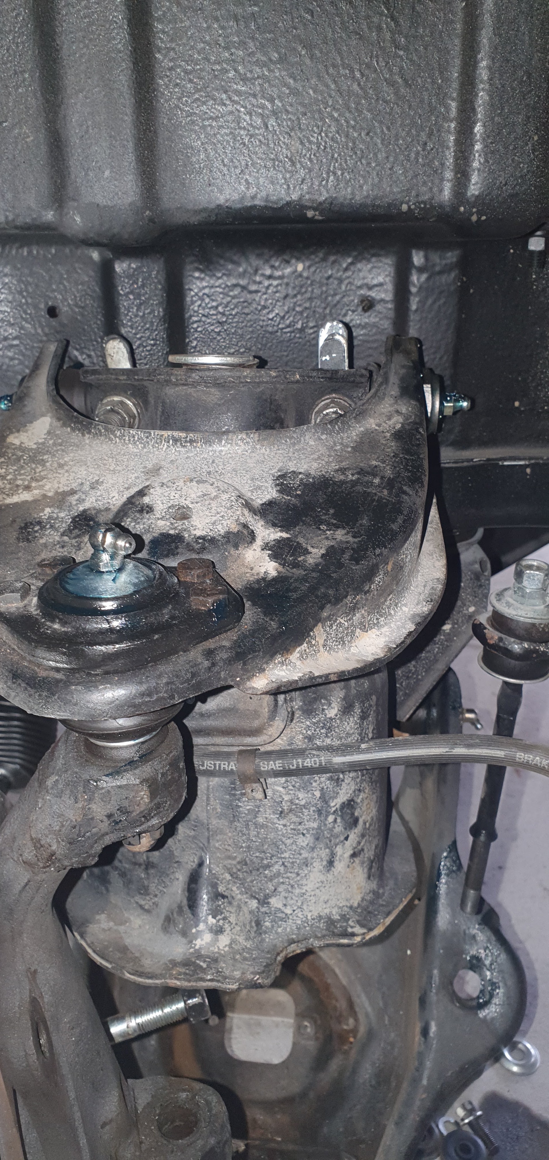

A bit of work to get the ute's front suspension back to spec.
The drivers side top wishbone was 10mm offset to the firewall, and the lower wishbone 13 mm offset to the front. They are meant to be equal each side. The reason I went looking was there was an increasing squeak on that side of the car and when I went to grease everything, the top wishbone front grease nipple would not take any grease. Some rudimentary investigation found that the pin was hard up against the bush and there was no way grease could get past and these two bits were rubbing against each other- hence the squeak.
This is not a job I was happy about, having paid someone to put the new bushes and ball joints in about 12 months ago. Anyway, took my time and now they are done.

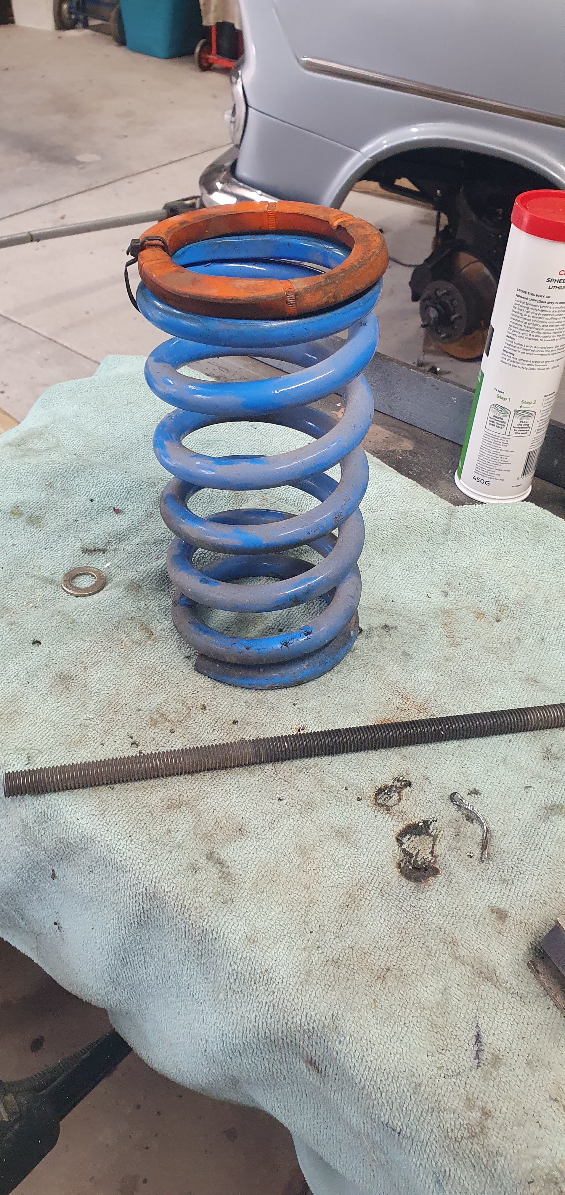

I had a spring compressor made from a threaded rod, but in the end just used a trolley jack to compress the bottom wishbone against the car's weight after putting the front on stands. My springs are 3inch shorter than standard (9inches compared to 12.5inches standard) and because the length is shorter, this makes the jack method much simpler and a little less risky. I unbolted the steering arm and brake caliper, removed the shock absorber and sway bar and moved them out of the way and tied up the caliper. Didn't disconnect the steering arm ball joint, or the brake lines, so an easy reassembly.
To remove the lower front ball joint I supported the lower wishbone with the trolley jack, reversed the castelated nut and released it a few turns, supported the hub with another jack so some weight was on the axle and gave it a couple of solid taps. The spring force encourages the ball joint to release easily this way. Once the lower ball joint is removed, gently lowered the wishbone until the pressure is off the spring. It only takes a few minutes, but you need to be carefull. I had my spring compressor rod sitting in the top shock absorber hole, just in case the jack slipped to stop the spring flying out towards me.
My biggest fear in this job was that the wishbone bush holes would be worn out, but luckily they were fine and after a few goes removing and screwing back in, I was able to get the even spacing required and retorque the bushes to 60ft/lbs.
For Stephen, who asked some time ago, the front springs are 16.5mm thick wire and 9 inches high when free. There is a 15mm cushion on top.
