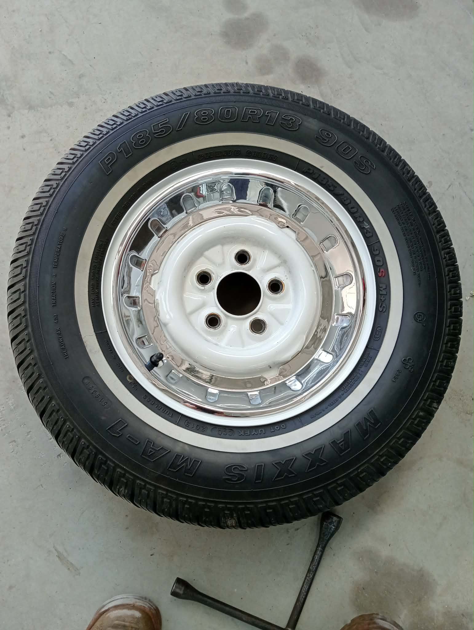

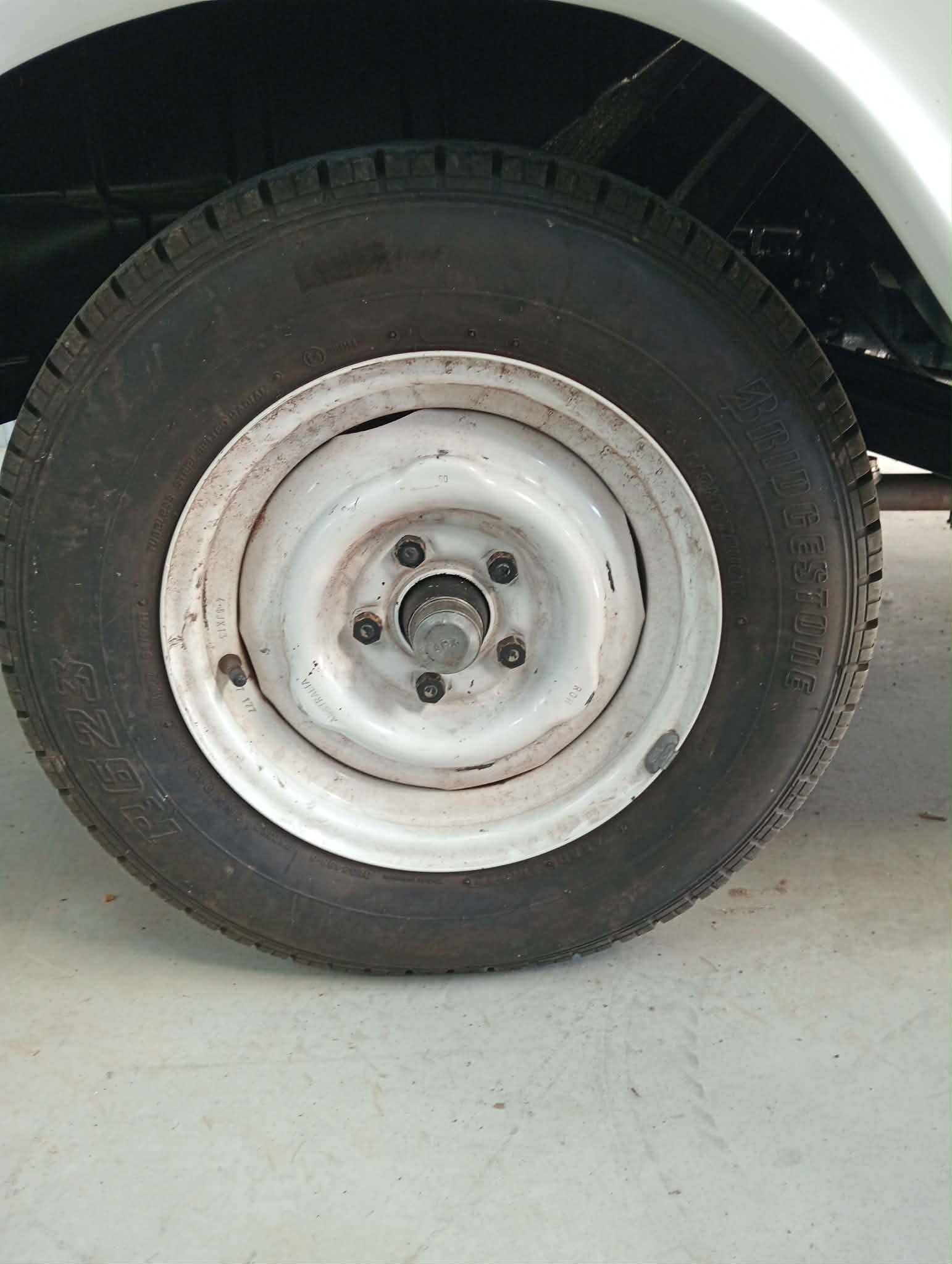

Well after running these Maxxis whitewalls since I've rebuilt this car I've decided to ditch them. I've struggled with steering wander since I put it on the road after the resto. I've been through the alignment, drag link, and steering box thoroughly. Everything was rebuilt back then (7000 miles). I was suss on the worm nut and steering shaft for wear but it never seemed to appear as excessive play at the pitman arm. I even stripped the box twice to recheck the shaft bearings and do a full bench adjustment with the preloads using spring scales to set the correct steering wheel turning torque.
That last few drives was enough. I ended fitting some spare wheels I had fitted with Bridgestone R623 8ply radials. I had these fitted to my EK ute and it steered really well, but I thought this may have been due to the slightly lower vehicle weight and the ute being a bit lighter in the arse end.
Well today proved its all in the tyres. It was chalk and cheese. I think the aspect ratio, sidewall height, and slight increase in width, created a sloppy tyre on the rim. The Bridgestone is about an 1" smaller in diameter, smaller in sidewall profile, and no doubt a more rigid tyre being 8 ply.
So now I'll have to work out my options with getting them whitewalled.
Posts: 11675
Interesting. Makes sense that they would steer better. Possibly the ride will be a bit harsher. There is usually a trade off somewhere.
Posts: 11675
Are those rims the same offset Craig? I see one is FB EH and the other after market or Torana.

The ride is still pretty good. No harshness noted.
Yes they are the same offset.
