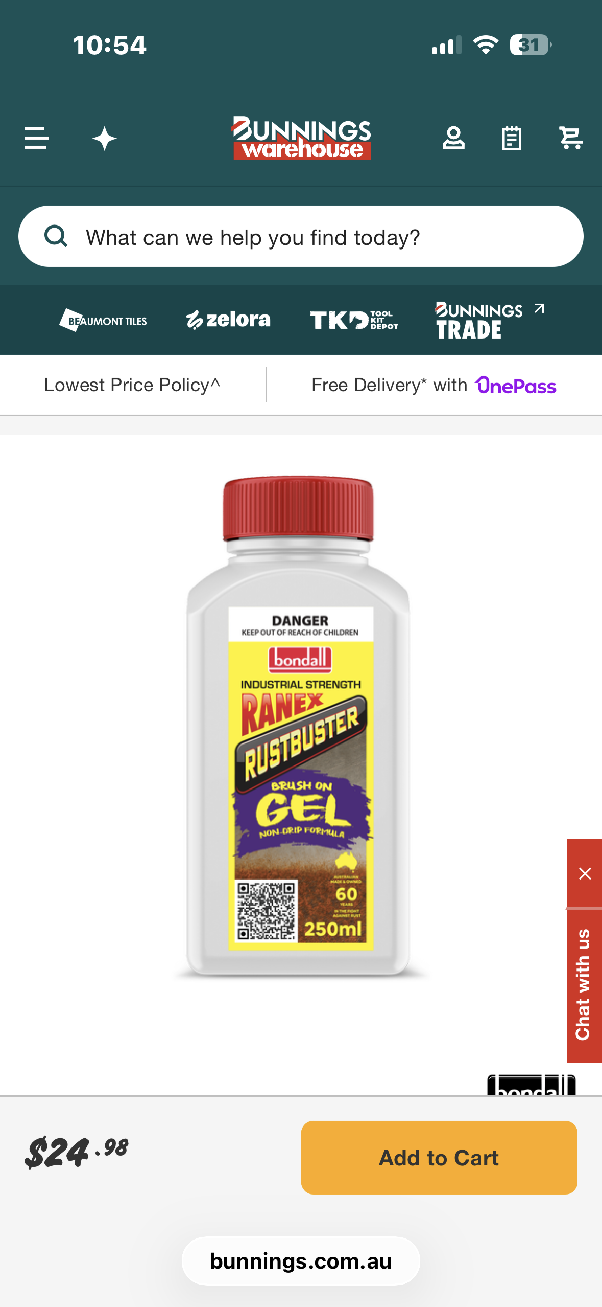

Finally, after much sanding, de-rusting, more sanding metal treating then more sanding, then more de-rusting I have an engine bay in epoxy.
FYI Bunnings sell a very good de-rusting / metal treatment gel that will stick to vertical surfaces.

Looking good. Do you have details of the Bunnings product you mentioned?

In the Shed wrote: Sun Mar 29, 2026 5:44 pm Looking good. Do you have details of the Bunnings product you mentioned?
A very good product, I just brushed it on but had to reapply it in some very badly pitted areas from battery acid.

I hadn’t seen the gel, but been using liquid Ranex for a while. Works well.

Thanks Taz for posting details of the Bunnings stuff :thumbsup:
