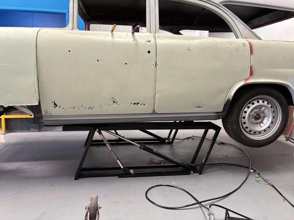

I don't have a hoist or anywhere to put on know so decided to buy a Quickjack hydraulic stands.
Gets really good height and much more clear when sliding underneath than being on car stands.
After I filled them with oil and bled them they worked really well.

Went to the workshop on the weekend sand got the engine into the engine bay so I can set the angle and work on getting the engine mounts welded in also come up with a gearbox mount.

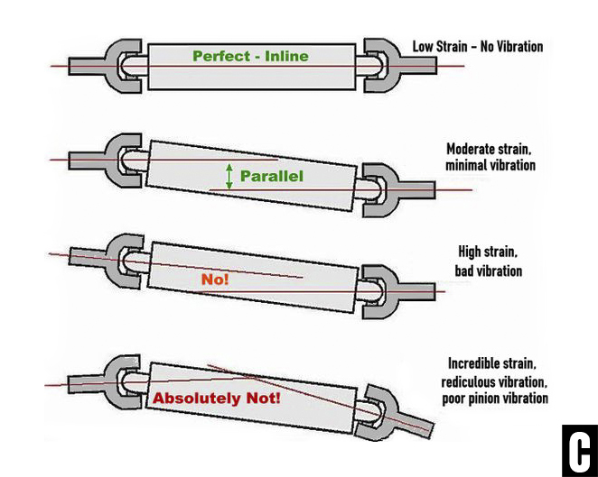

Great stuff mate. The lower you want the back end then the higher the rear mount needs to be, or you end up with too much angle between driveline and tail shaft. Less than 3 degrees preferred. Most likely you know this after doing a few cars now.

Clay the thing that I have with the rear is that the pinion angle of the diff does not change (lift when accelerating) because of the way it is bolted into the cradle (replacing the leaf springs) and being independent it doesn't go up and down like a solid axle on leaf springs so I have to get the engine mounts lower then probably cut them to the angle and make sure that the output of the gearbox is as close to in line with the pinion of the diff as I can get it.

That’s good, so you can keep the two axis parallel. That doesn’t negate the issue of the driveline to tailshaft angle though. This shouldn’t be more than three degrees, so I’m told. By the same token, there needs to be some angle, or the needle rollers don’t precess and therefore wear unevenly.

Surely the rear end has some degree of driveline angle built in, as Clay has suggested 3 degrees maximum.
If you get the gearbox shaft at the same angle that should eliminate drivetrain vibration, i would hate to do all that work then end up with the dreaded teeth chattering !
Actually because your diff center dosent move that is really optimal if you get it right.
Look foward to the progress.
For those who are scratching their head, this picture explains it.

Greg’s first example I was advised to avoid as it doesn’t allow the roller bearings in the uni joints to precess and share the wear. The issue I am tslking about is the opposite extreme of this, the extreme version of example two, where the angles between tailshaft and the two parallel axis is more than three degrees.
