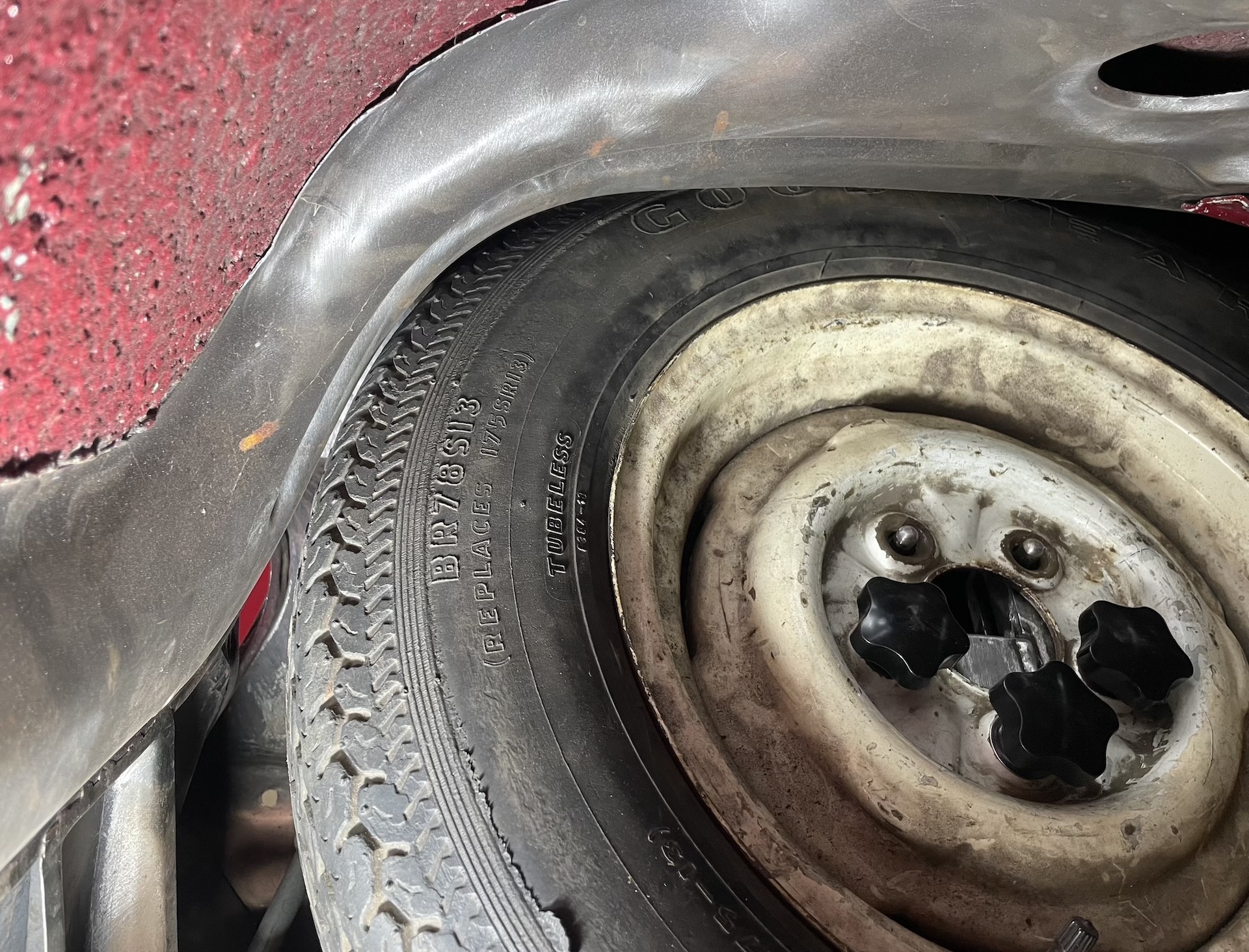

And after much grinding and cutting to try and shed some weight - and make it look a little less agricultural - here it is, with mock battery in place.
Two locating pins at the top accept the wheel as you tip it over, and the sliding tilting base flips up against to back of the rim. Install 2 bolts to fix the rim to the base. Then brute force to slide it up and drop the bottom bolt in and tighten to lock everything in place.
Do we have clearance Clarence? Just - roughly 10mm all round.
And what about with the boot closed? Well that’s even less.
Ended up wth the most space under the tyre.
Was not expecting the fit to be that tight, and happy to get away with it. Mind you, it has taken me a good part of a week to get it sorted, with lots of unexpected tweaks along the way. If I didn’t have the time I would have definitely just welded a few lugs to the floor for some straps and bolt the old battery box down.

Damn dude, your CDO is next level !!!!! Nice work :thumbsup: :clap: :thumbsup: :clap:
Posts: 5558
Re: Ol' Rusty - FB/EK Sedan
Thats some Tetris level space usage - looks good.

Ha yeah that thing is as hard as a rock - last put air in it 25 years ago and still holding.
Not sure what size the tyre is - its stamped BR178/13R (replaces 175/13). Going to try for a 165/60/13 so should give it a bit of extra space.
