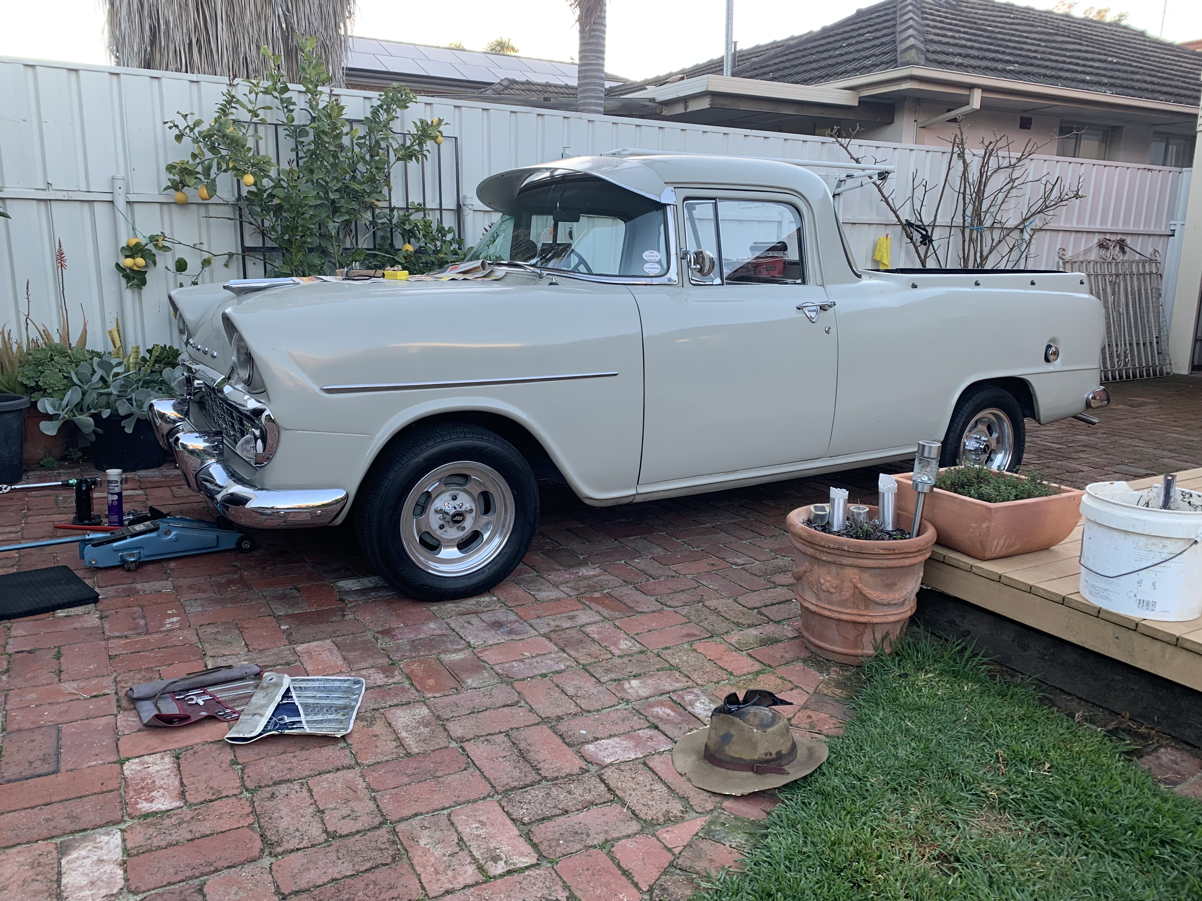

I have not changed the rims / tyres from those earlier.

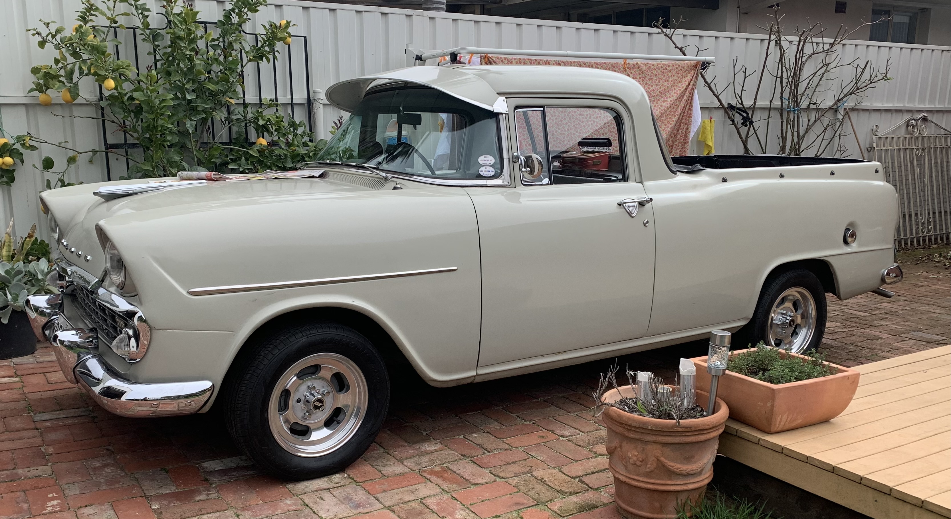

Cut 25mm off springs and reinstalled. I think the car needs to come down another 15-20mm and that should do it.
The car has been lowered approx 45mm after the first cut.- Attachments

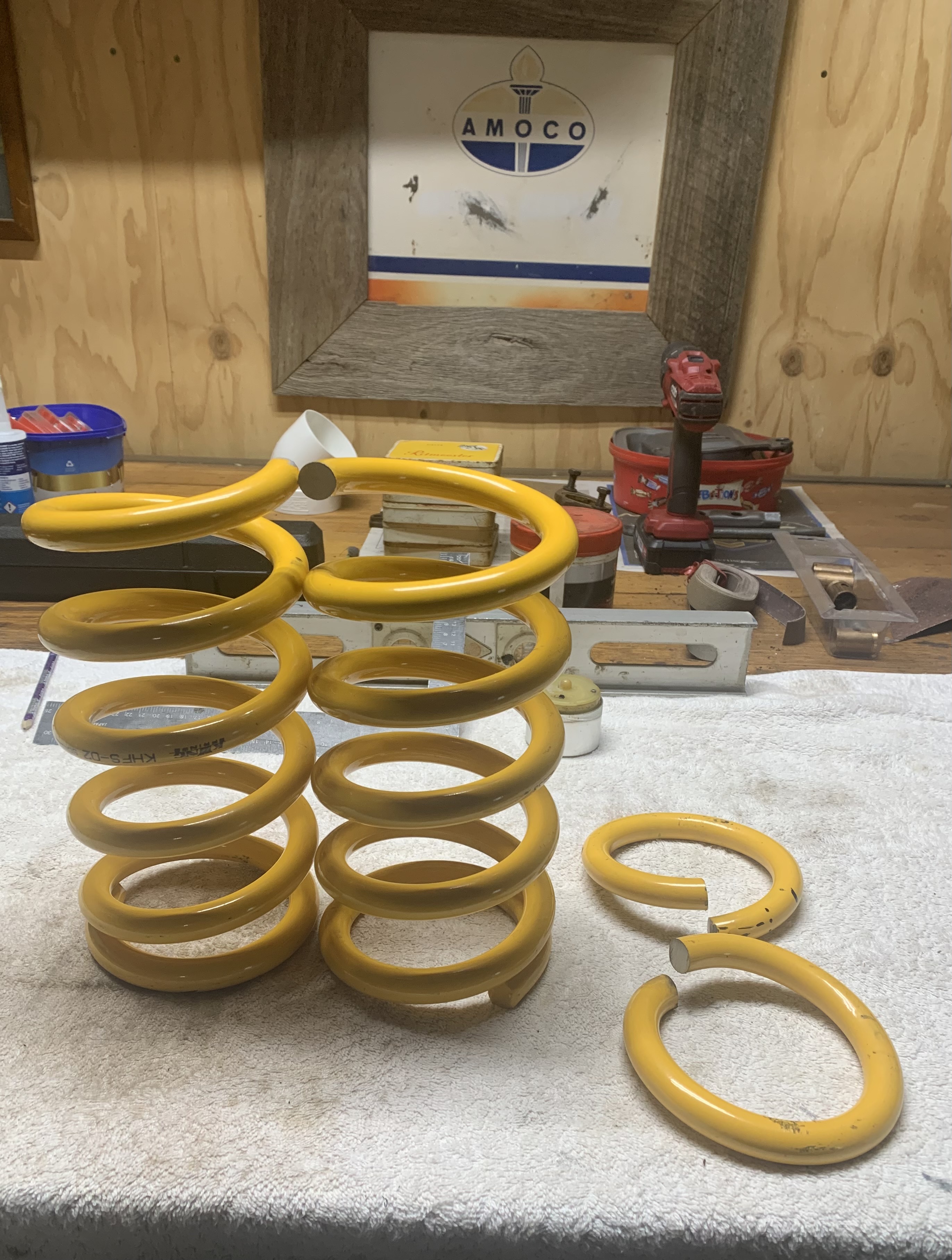

Took another 10mm off spring length. That is the limit as the spring only required a small amount of compression with jack to fit lower control arm bolt.
Will do a road test tomorrow.

Good result - it may settle a little over the next few days mate - maybe adopt a wait and see attitude ?
Looks great Stephen. I wonder if they are a heavier gauge spring, or are they original spec?
King springs say they are a direct replacement but you can see by the Stephens photo on page 13 that they are heavier gauge.
Maybe page 14

The King Springs I fitted were standard height plus 20mm lift as I wanted to solve front tyre scrub. The wire dia is 3/32” bigger than what was in there originally. Probably should have gone for standard springs and saved myself all this fiddling

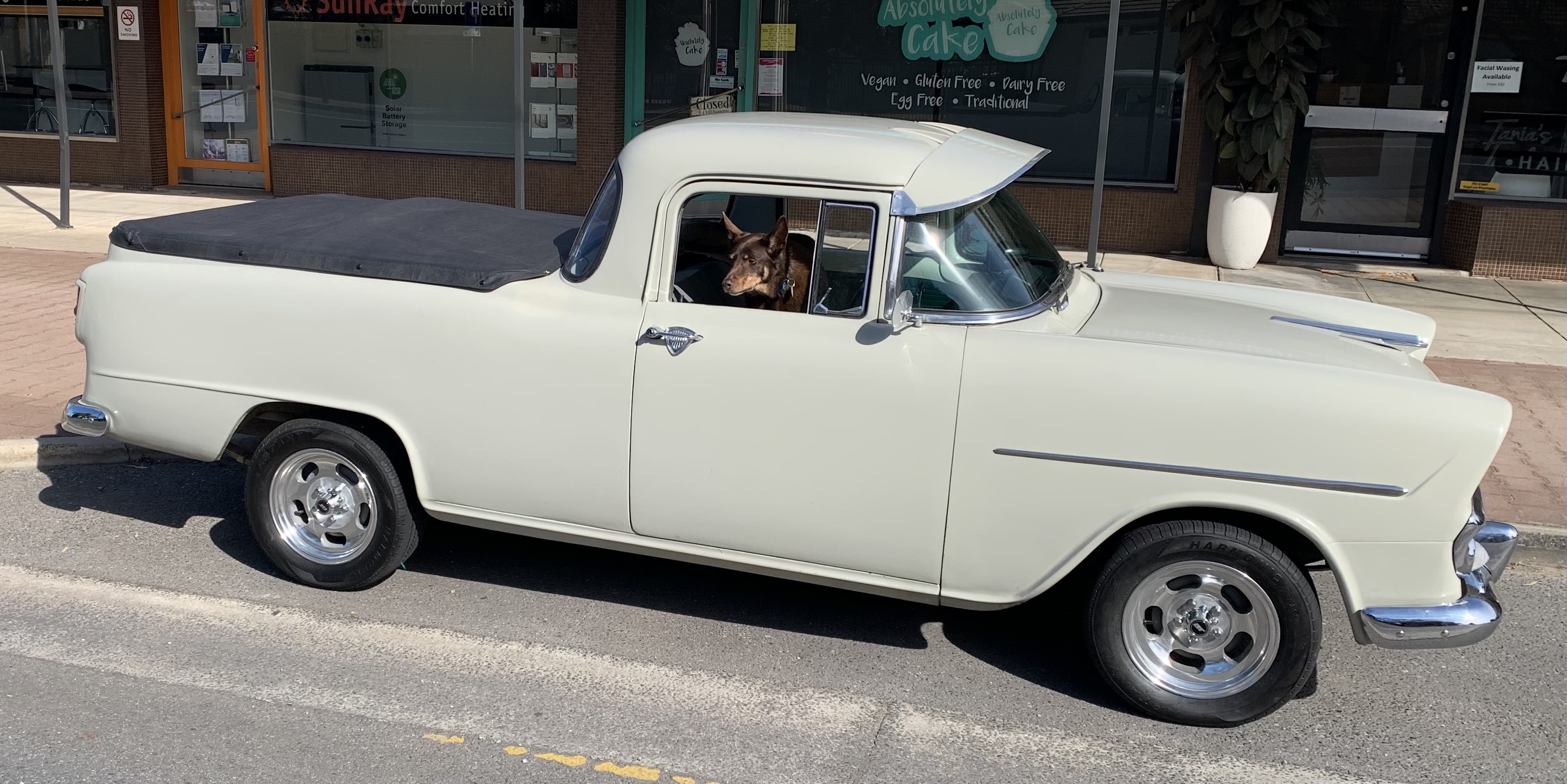

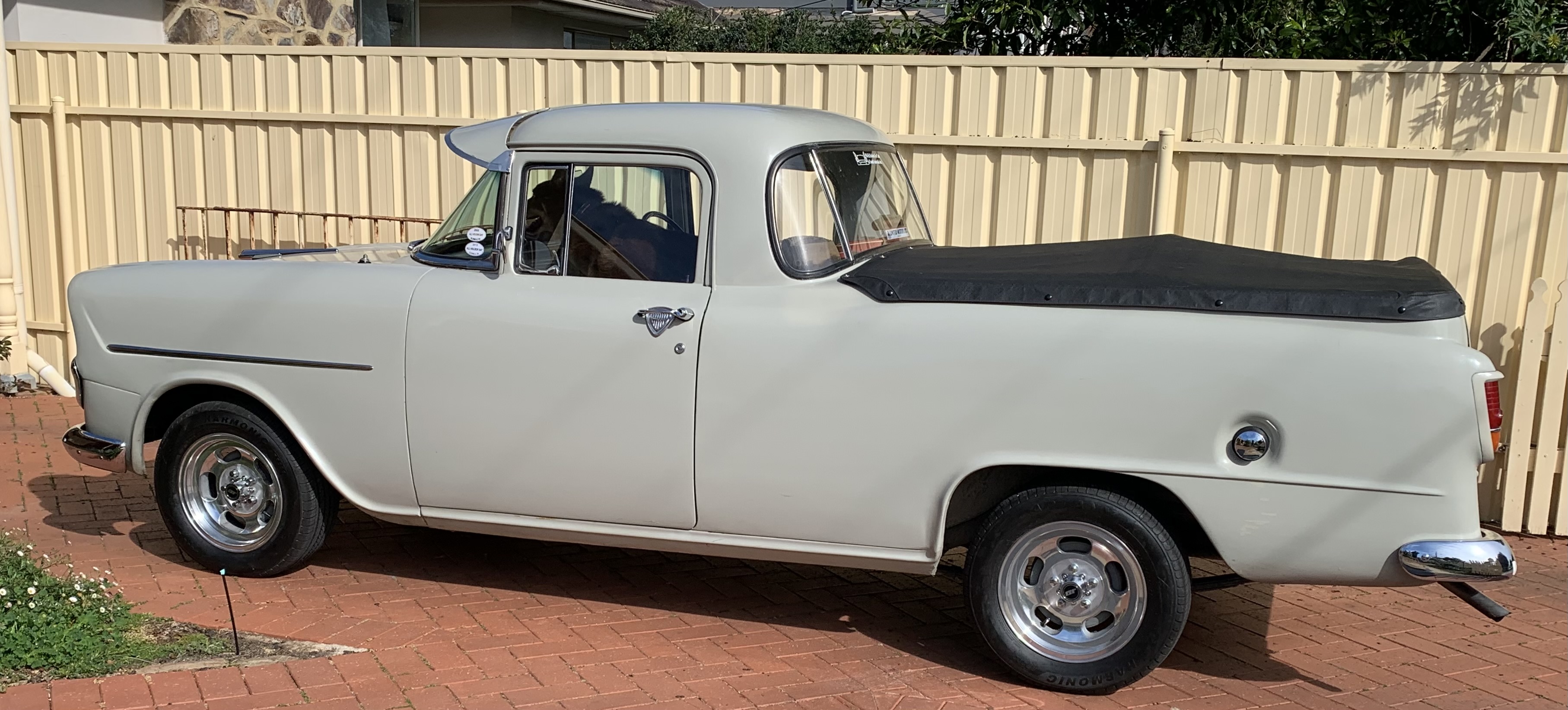

After the two spring cuts here it is. I’m happy with how it stands and I have increased the tyre / guard clearance. With new stiffer springs I am hoping to have solved the tyre scrubbing. I won’t know until I get on some undulating roads at 80 km/hr.
Here is how it looks now. Next job is to replace the tie rod ends then get a wheel alignment.

Looking great Stephen. Similar stance to my old beast I'm thinking. My fronts were 2 inch shorter than standard but much thicker and firmer. Rears were standard 6 leaves with no work done other than new nylon spacer thingies. Even your wheels are similar
. I have a reasonably solid Selby sway bar on front, and bought one for rear but it handles so well I haven't bothered to fit it. Doggo looks wonderful too.

Funnily I had the same problem as you many years ago with my old EK sedan. I had the stock HR front springs and wanted it a bit lower. I got my mechanic at the time to put in some lowering springs. When I picked up the car it was higher than before. We scratched our heads and lopped off 30mm or more, which fixed the height ok, but the ride was pretty harsh. Not long after I pulled them out and replaced with original HR springs again but with 30mm lopped off. Prolly by hacksaw back then knowing me. That setup is now in my ute and works well for me, however I only run 185 tyres on 6” rims.
You know how I love mucking around with wheels. She looks like business with the 14x7” and 225s. Makes me want to polish up the ones on my ute. Good on you for persevering and getting a result you are happy with. Looking forward to seeing it out on a run.
