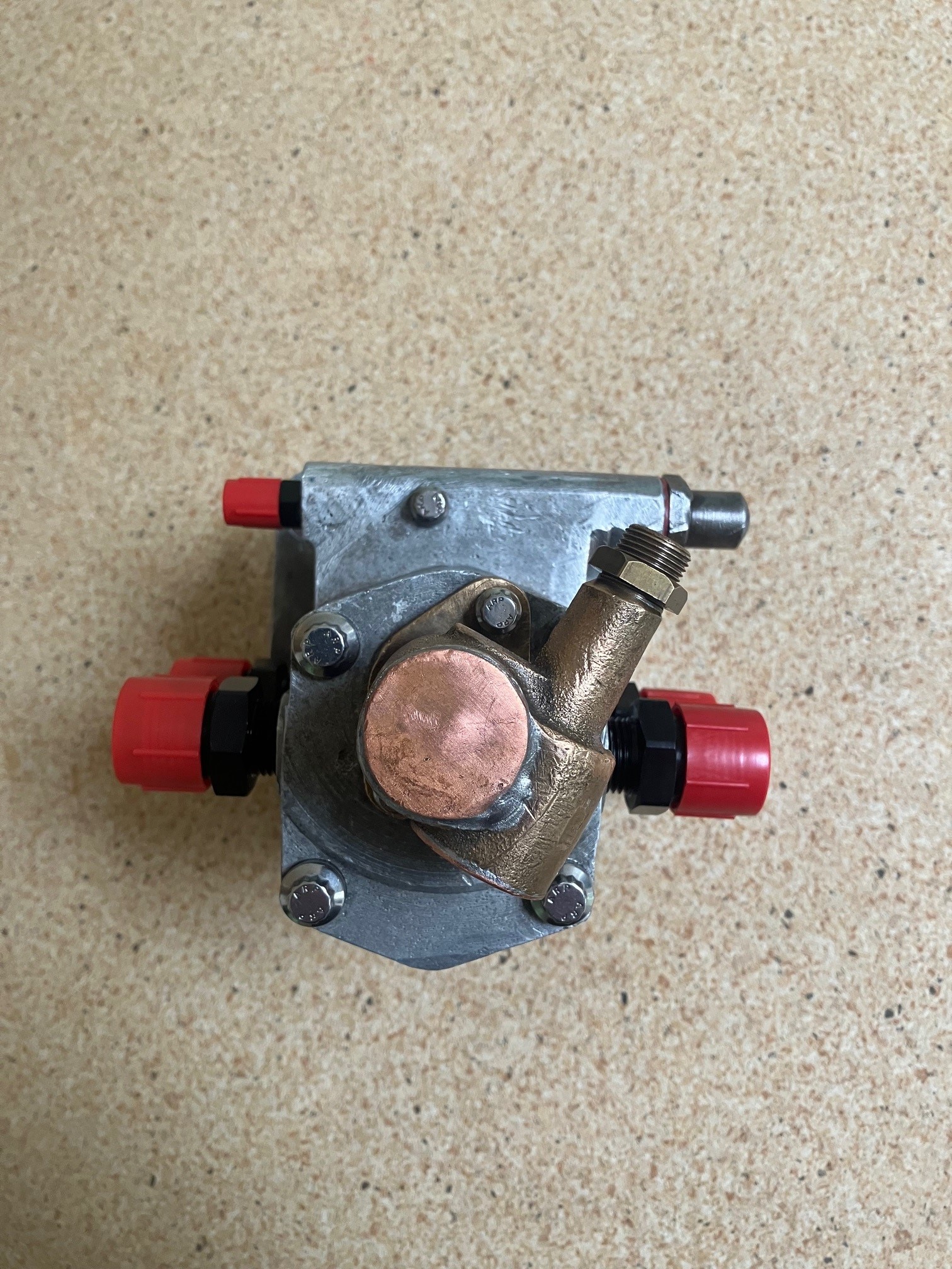

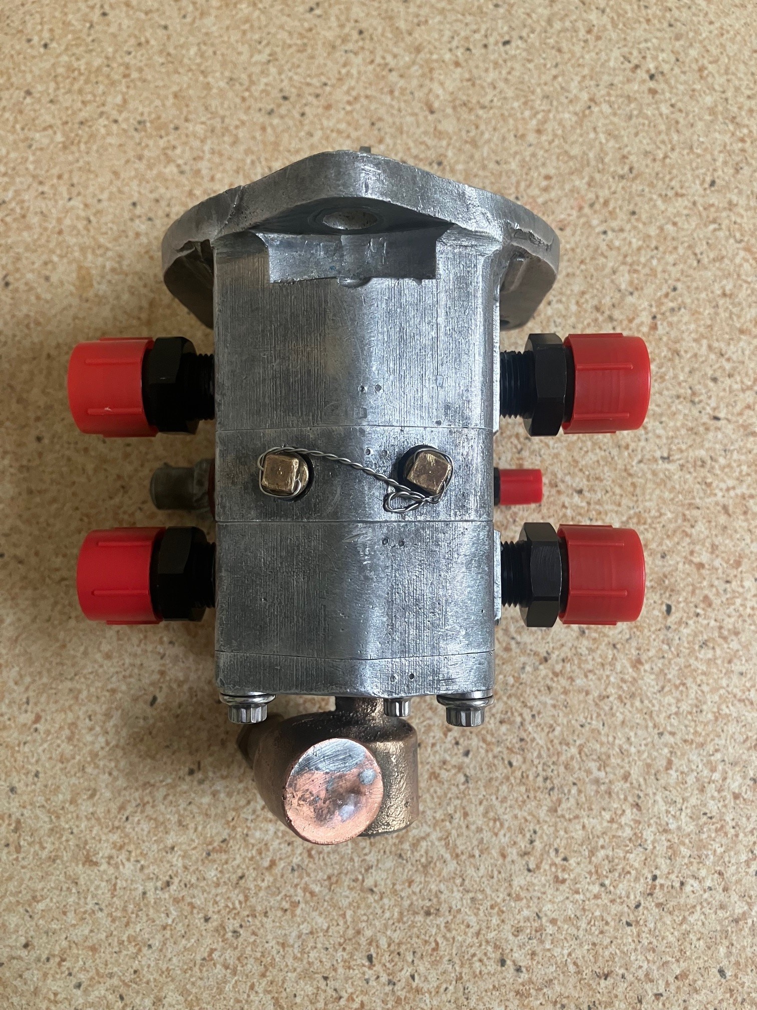

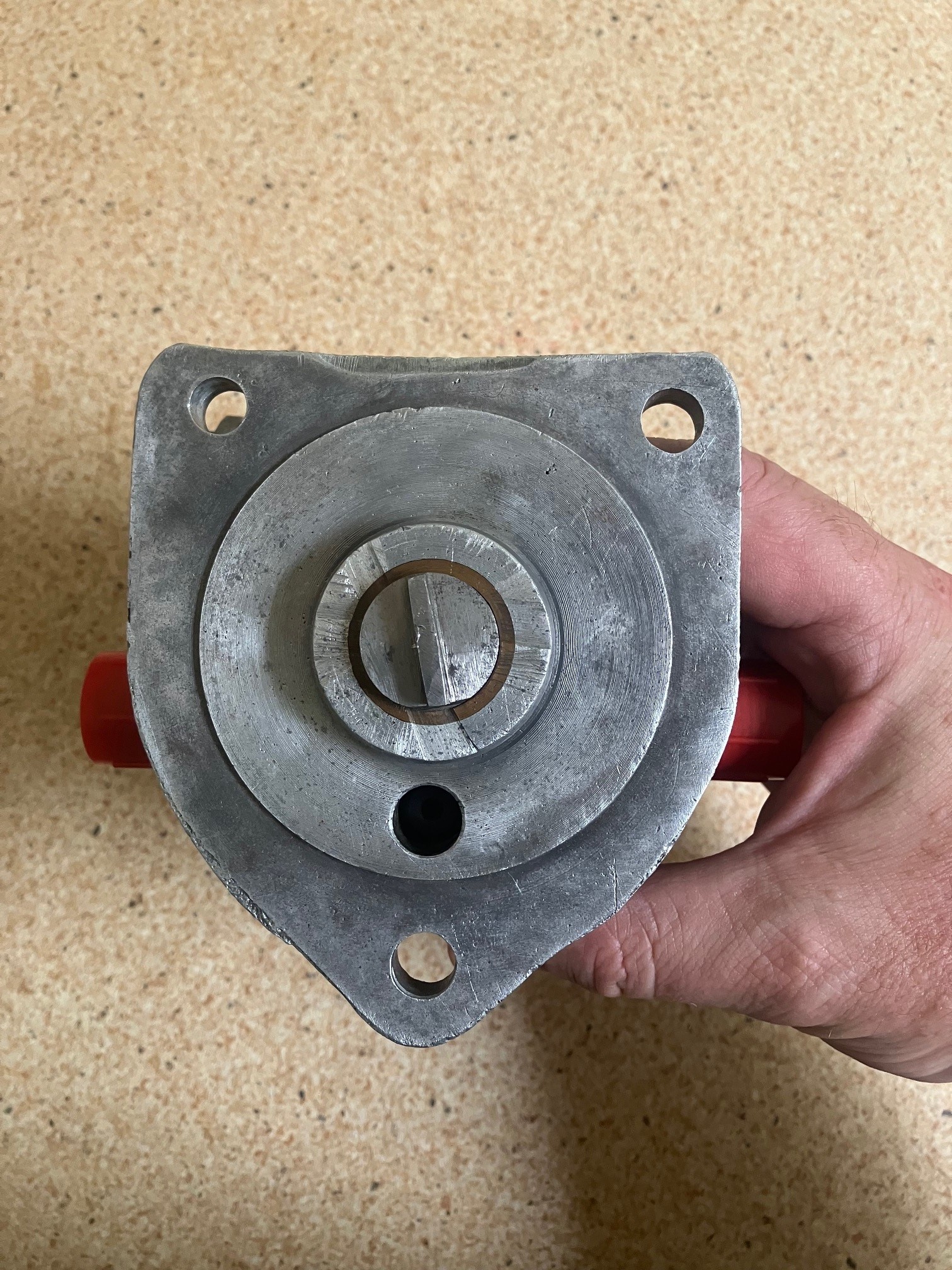

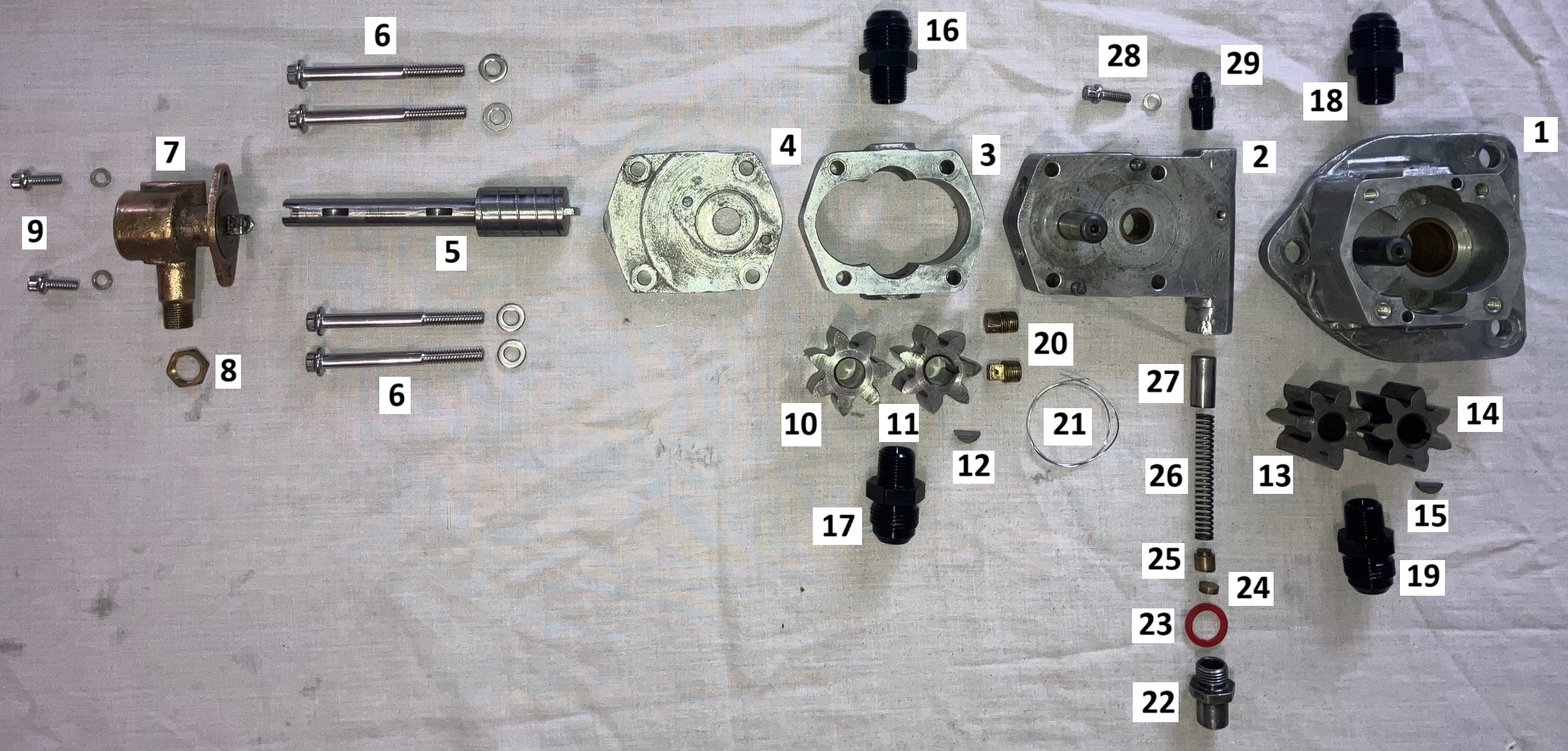

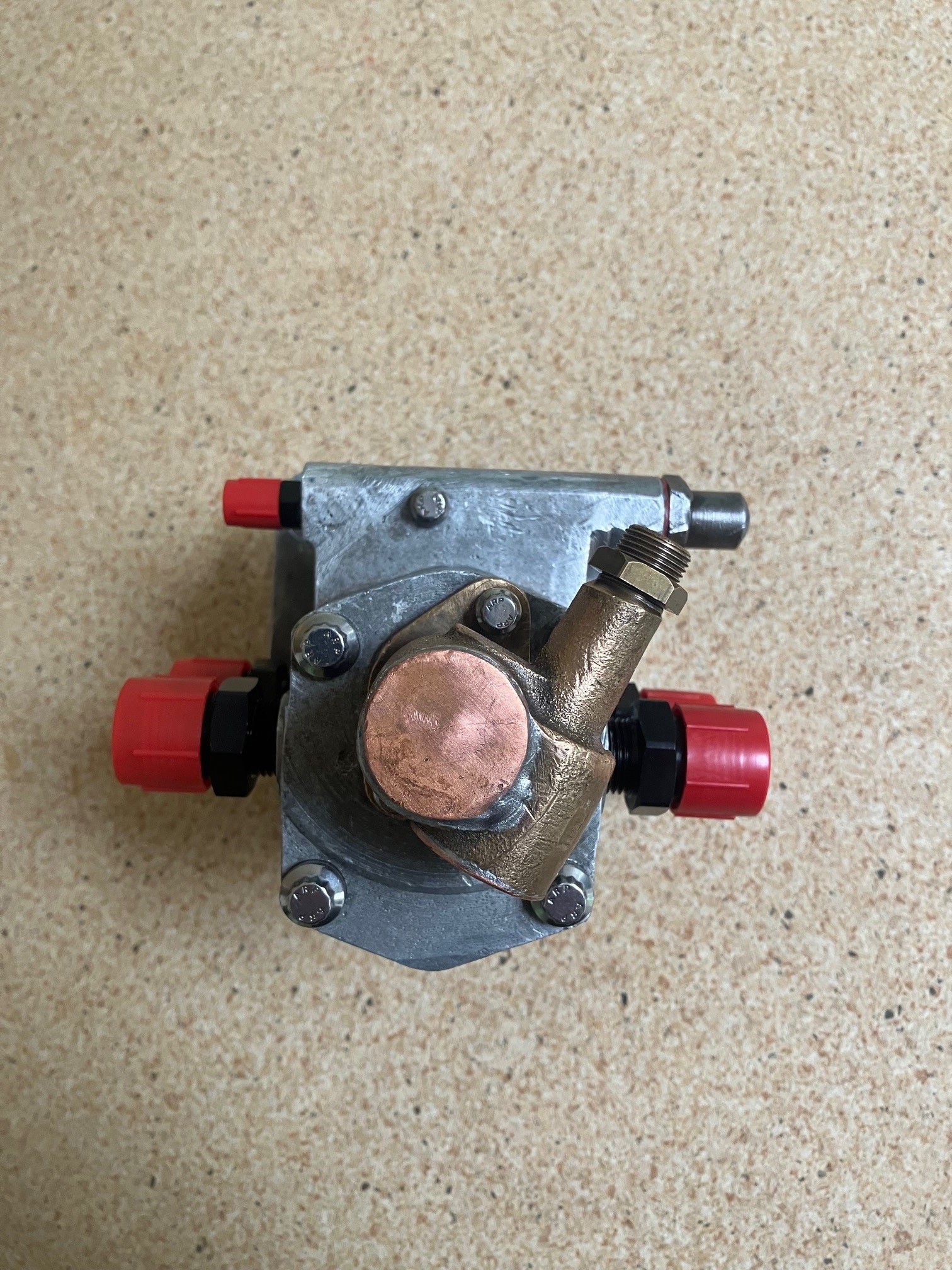

Got one of the two dry sump pumps cleaned up and rebuilt. This one had come off a grey motor on a boat. No idea who made it. It runs counter-clockwise (i.e. cam drive, not crank drive).
Dry sump pump 3.jpg (903.07 KiB) Viewed 11221 times
Dry sump pump 2.jpg (801.54 KiB) Viewed 11221 times
Dry sump pump 1.jpg (882.3 KiB) Viewed 11221 times
Dry sump pump assembly.jpg (702.41 KiB) Viewed 11221 times
1. Pressure casing
2. Relief valve casing
3. Suction casing
4. Casing end cover
5. Drive shaft
6. Casing bolts – four off ¼-20UNCx2.75”
7. Tachometer cable drive
8. Tachometer cable jam nut – ½-26BSB
9. Tachometer cable drive mounting bolts – two off #10-24UNCx½”
10. Suction idler gear
11. Suction drive gear
12. Suction drive gear woodruff key – ANSI #3 full radius
13. Pressure idler gear
14. Pressure drive gear
15. Pressure drive gear woodruff key – ANSI #3 full radius
16. Pump discharge to oil tank nipple - 3/8-18NPT to -10AN
17. Pump suction from sump nipple - 3/8-18NPT to -10AN
18. Pump discharge to engine nipple - 3/8-18NPT to -10AN
19. Pump suction from oil tank nipple - 3/8-18NPT to -10AN
20. Relief valve passage drilling plugs – two off 1/8-27NPT
21. Relief valve passage drilling plugs safety wire
22. Relief valve assembly cap - 9/16-18UNF
23. Relief valve assembly fibre washer - 9/16”IDx- 7/8”OD
24. Pump pressure tuning spacer – 9mm diameter x 0.140” thick, approx. 50psi/inch of thickness
25. Relief valve spring mount
26. Relief valve spring – 7.8lb/inch
27. Relief valve piston
28. Relief valve piston stop
29. Pump discharge pressure gauge nipple - 1/8-27NPT to -3AN.
Still have to finish overhauling the second one. Good rainy day job. Not sure which one I will use yet.
