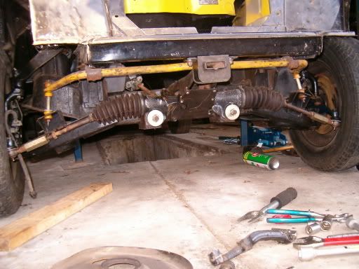

long story but here is a progress pic
first
then
now

What are all those bits you've used?? Look different!
ipg
Post by ipg »
the ute already had a hr crossmember in it when i bought it. but that one has been replaced in favour of another one with rack and pinion setup.

looks to me like a torana steering rack cut down and fitted onto the front of the crossmember - ala rod hadfield style.
looks like the swaybar got an upgrade too :)

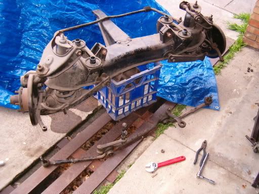

Cool. Whattya doing with the HR front end??? 8)
ipg
Post by ipg »
not sure yet. might save it for the next project 8-)
it is already setup for a red, with the engine mounts moved back.
will need a full reco of ball joints etc just to be safe.
it is complete minus springs and shocks.

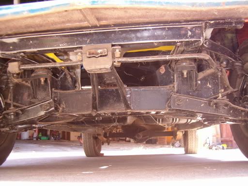

as sammy said its a crs modified hr crossmember with torana r&p
put this subframe back on today and began to install the chassis kit.
if you have ever installed one of these you will know that they are a bitch, they just dont fit 100%. the underside of the car is dead stock and hasnt been tampered with, but yet the kit does not go straight it.
so now i will get out my cutting wheel, and cut off the floor x braces and start again with something that fits. going to do this because they are 45 years old and there is the possibility (read probability) of rust in them.

yeah i had alot of problems with my chassis rail kit as my cross braces had been repaired, i ended up cutting the U at the front of the rail and made it a bigger U shape so it fit over, but other than that it was pretty good!
i've also had to re-do the gearbox mount as the engineer didn't like the plate sticking out the front of it, mine is now probably twice as strong and sticks out no where near as far .... also i moved the bolt holes 45mm forward from where they were to make the crossmember sit closer to the mount on the gearbox.

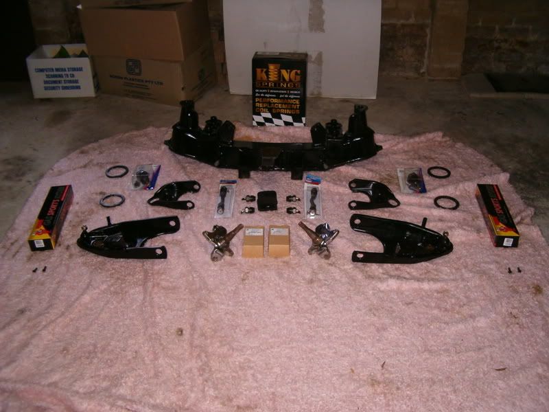

here is the front end back from the powdercoaters
went to rares and bought everything new again
just waiting on the bump stops and then ill put it back together
smooth

The powder coating looks great will you be getting anything else done like Prop shaft or rear axle ? Would make it look a treat underneath if all done.
Suppose cost would be a factor.
How much was it for front end to be blasted and powder coated ?

the cross cost $400 to be blasted and coated
it then cost another $400 or so to buy everything new for the front end from rares:
ball joints x 4
pivot arm kit x 2
lower bushes x 4
spring insulators x 4
wheel bearing kit x 2
subframe mounting rubbers kit
springs and shocks set me back another $300
